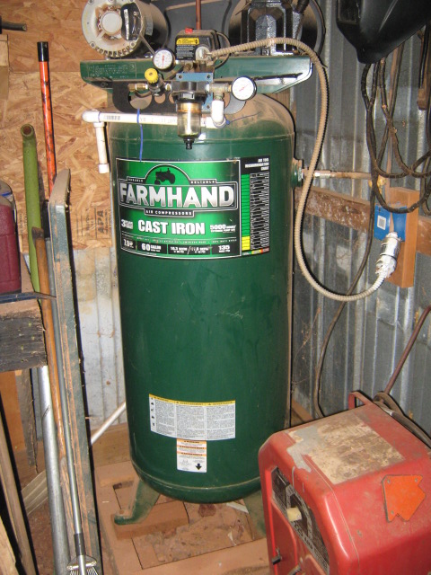

You can take my word when I say I have had many many types and makes of air compressors, and I can advise you to stay away from the oil-less ones, they might be OK for those only using it once in a while, But I use a compressor each day all day 8-9 hours per day, about 6 years ago I finally found the ones that would hold up to my use, actually I 3 type that you mentions possibly needing, I have a Upright shop compressor, name brand ( Farm hand ) made by Campbell Hausfeld, been a very reliable unit, I have a semi-portable (Ingersoll Rand) that I keep in my trailer, it does have wheels, although I have never had it out of my trailer in 6 years, I also have a carry around compressor Branded by ( Dewalt) that has been an excellent compressor for the 5 years of using it, I've run it all day long with 2 framing guns building decks, No problem..... I could go into details of why these units are better then the rest but it might take a while, so I'm just saying I've had good use from these over this time, and if the broke tomorrow I would still give a :thumbsup: on them,
