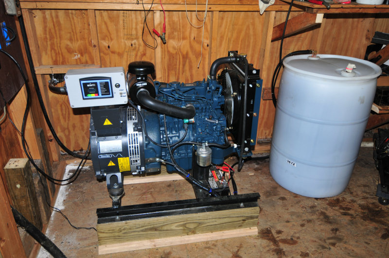

I would strongly recommend a diesel genset. First of all you get the best fuel consumption/cost with a diesel, especially if you buy off-road diesel or heating oil. Second diesel engines, at least good ones (not chinese junk) are among the most reliable engines, you can store the fuel for years without degradation, if you control moisture.
I have a kubota powered 10KW unit and I can far outlast my neighbors with their propane. As far as the cold weather, in N.E. PA the fuel has never had a problem in the cold weather, nor with starting. My genset is in a shed along with the fuel, so once it is running, the fuel is warmed by the engine.
I would recommend an 1800 RPM unit for long life and quiet operation. My previous was a 3600 RPM and the 1800 is so much nicer. I have a manual start and transfer, by choice, since I don't want it running when no one is home. I can start it from the house, so it is convenient even for the wife.
