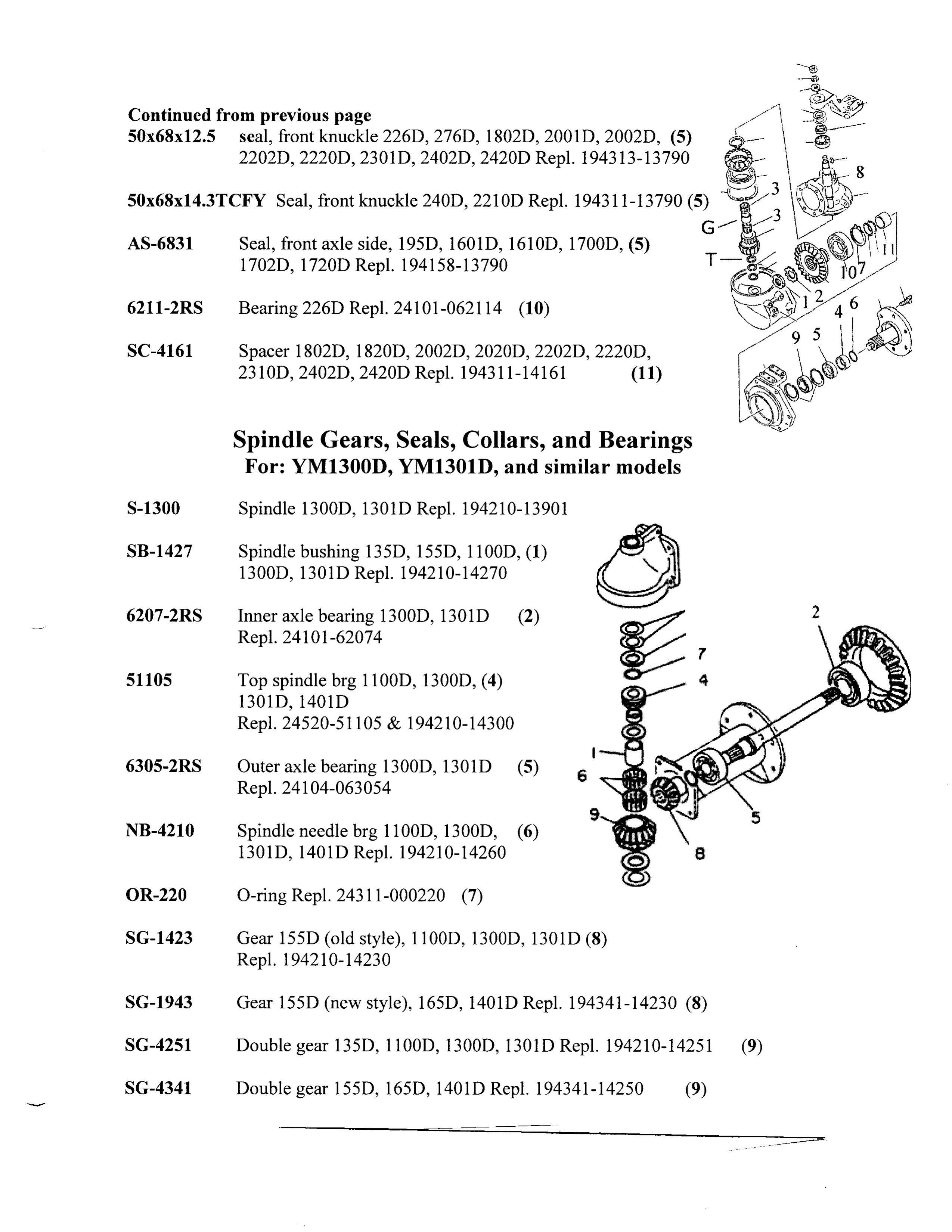

I got some time today to strip the knuckle joint down and see what the cause of the play in it is, looks to be just the bushing #61 in the Hoye diagram Yanmar Tractor Parts: 4WD INTERNAL which they dont seem to have, anyone know where I might get a couple of these?

Bushings arrived from Hoye today, they look wrong to me, what do you think?
Originals are bronze coloured, longer and have oil grooves and holes in them:
/ Need advice on my YM1301D #17
I would think size is the most critical issue. If the bore and od are the same I would think oil grooves might not be necessary. How much shorter are the bushings?
/ Need advice on my YM1301D #18
Matches mine ;)

Thanks. It says "1301D repl. 194210-14270" I guess that means SB1427 is a replacement for the original 194210-14270 ? It's definitely shorter than original and is steel not bronze, added to that there's no oil channels it's likely going to cause wear on the kingpin. Being a perfectionist really is a pain some times...
