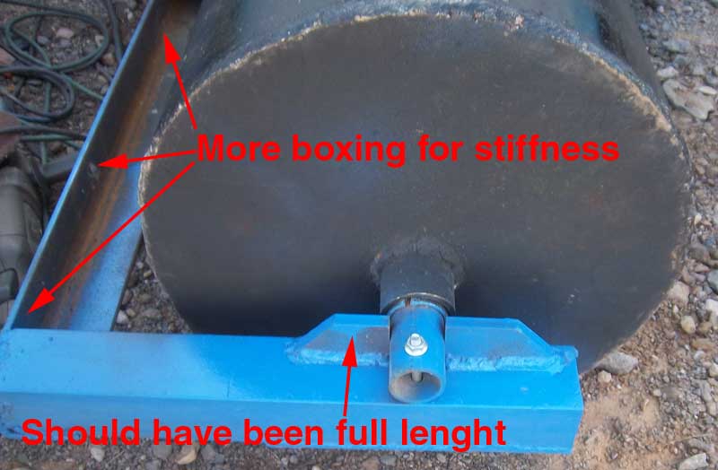

I had a thread on building a roller & sheep's foot a while back. Lots of pictures.
A roller rarely gets over 2/3 MPH, so real bearings are a waste. Unless you are going to use it a lot and often.
A heavy wall pipe through the center is simple & easy. Then a slightly smaller pipe to pull or push with. I just used PVC pipe fitting for bushings and they seem to be holding up.
Go to search and type in sheep's foot & / or roller there have been several builds on the subject.
Note: The picture shows the bridle upside down.

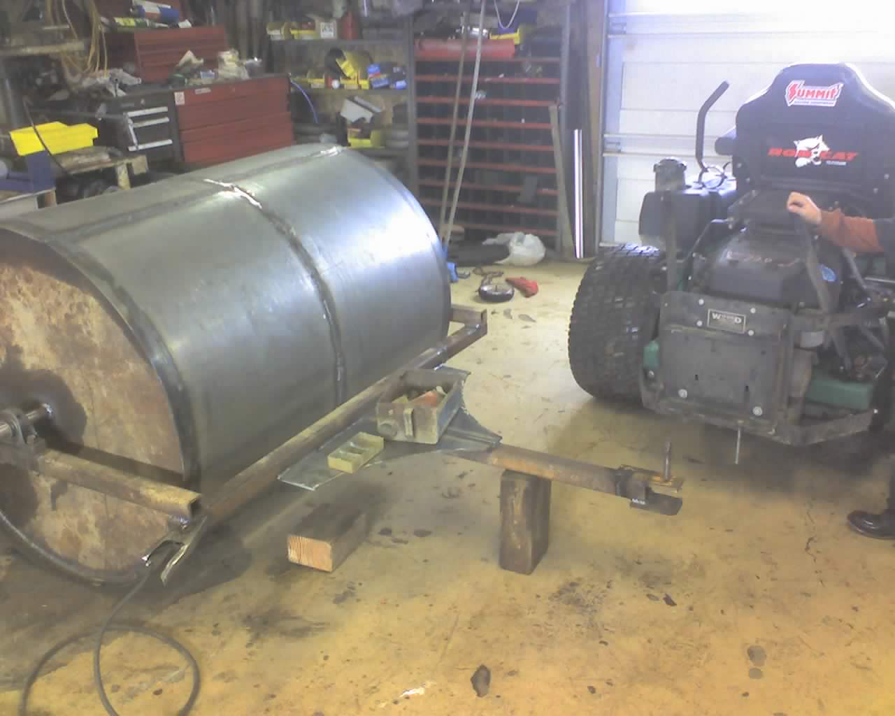

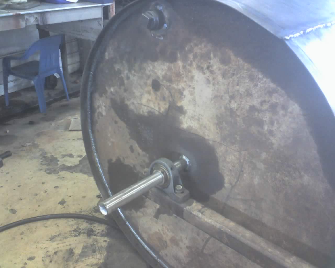

Here is one we did to give you an idea of the hitch set-up and bearings. It holds 225 gallons and weighs ~700lbs empty:thumbsup:
EDIT: we did cut the shafts down to length when done so they dont actually stick out like show in the pics
End of story, done! Looks nice. I borrow my dads every year and it looks like its been through a war due to the rocks, an occasional tack on the seam and its ready for another season. His has a stub on each side going through a 5/16 plate with a hole in it , and his roller has been around forever, hows that for cheap, smear it with some grease and go! Turtles pass me, so how fast you really need to go.

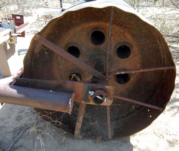

Sort of wish you had stated how much you are going to use your roller. Mostly on flat land, pasture, hills, rocky ground. Farm use or commercial.
For occasional use, no bearing are needed. See picture 1. Threw that thing together one day out of mostly junk. Stub axles made out of 1.5" water pipe. Just torch burnt hole in 1/4" plate that fit over stubs. It had a lot of miles on it, mostly level ground, but lots of rocks. No real wear when taken apart.
I don't really like stub axles, but since they were already there I just left them when making it into a sheep's foot. It's 2' in diameter and 6' long, filled with water.

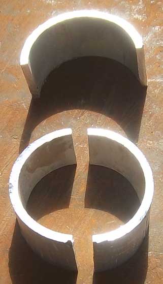

After making it into a Sheep's foot a new bridal was built. Had some old connecting rods laying around. Split some aluminum pipe to use as bushings. The stub axles & connecting rods did not break or bend when it was picked up and moved.
It weights around 1,700 pounds. Know that yours will be a lot heavier, but doubt that you are going to be picking it up.
One thing I think you should avoid is having a bunch of metal sticking out past the bridle. As in hubs & bearings.
