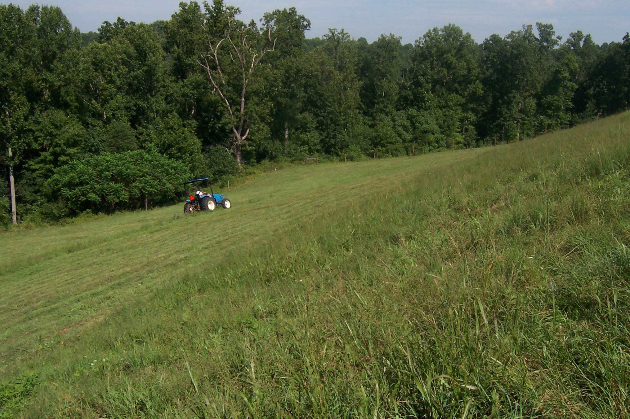

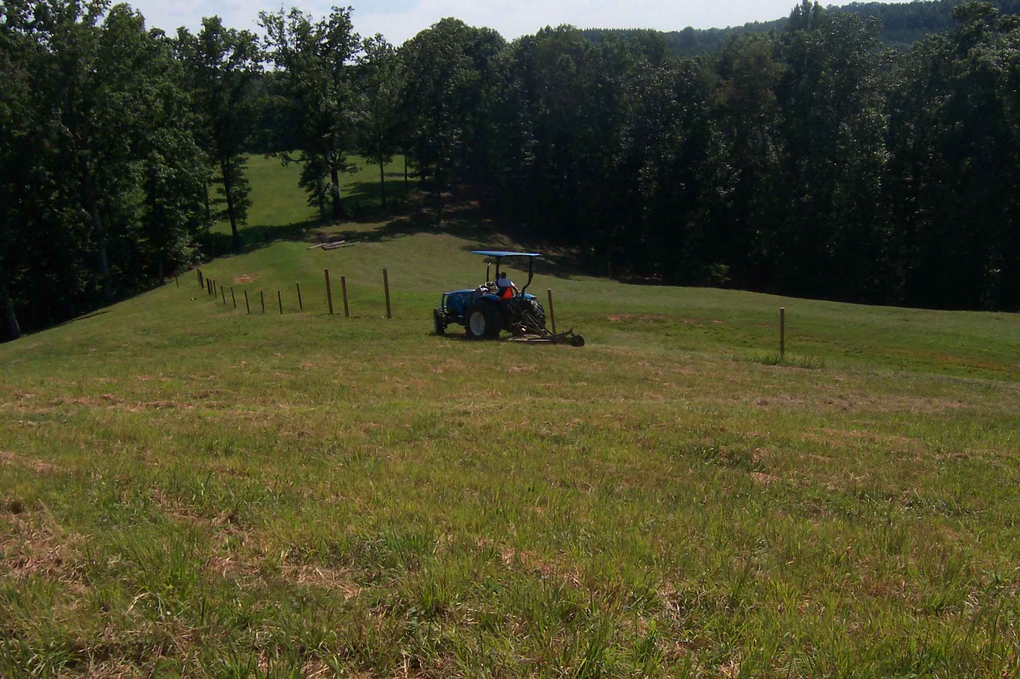

I also live in WV and my ground has some steep places.
I mow our pasture twice a year as it seems to keep the
weeds down better in my opinion.
I remove the loader for the mowing and leave it off till I am
finished. Others may disagree and that's fine, we have to do
what we all think works best.
My loader weights over 1000 pounds and even with the bucket set
low that weight makes for a top heavy feeling. Some say with the loader
on you can go up much steeper ground and you can. But is it worth
the risk and you are putting much more strain on your machine.
If I must have the loader to keep the front down on a grade, it is
to steep for me. Wish you to best with new tractor.

Fenix -- Great looking farm !!!!
Lots of fertilizer and lime on that grass.
That pic of the slope look's just like my farm.
Thank's for the pic's.

Thanks BroBro, we try to keep it looking nice but it's hard to stay
ahead of. You are right on the lime and fertilize. The lime was spread by
truck and those guys are very confident on steep ground.
It is amazing were they can go.
