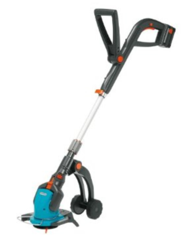

Could your wife use something like this? $200 to fix the old trimmer is still cheaper than a new one.
