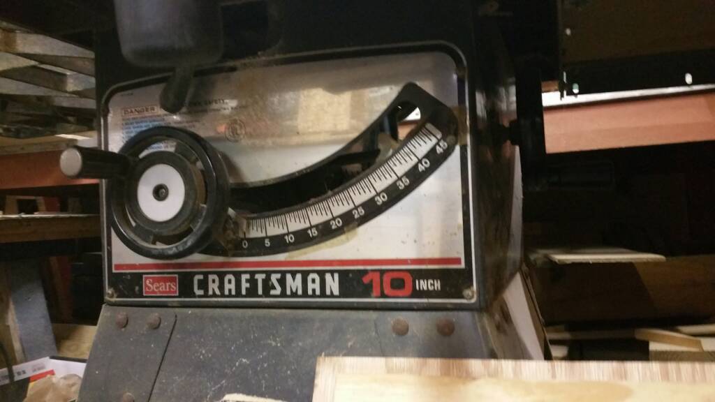

My tried and true craftsman is at the end of its life. I need a new saw but my table is all steel with attached wood/formica top and I don't need a new leg stand. This is a quiet belt drive and I want some equal or better. Here's a pic :
Any suggestions? I'd rather pick one up than order. Like to have it this week.

If you are happy with the saw that would be my suggestion..Honestly your saw is probably better than anything you would buy new now...

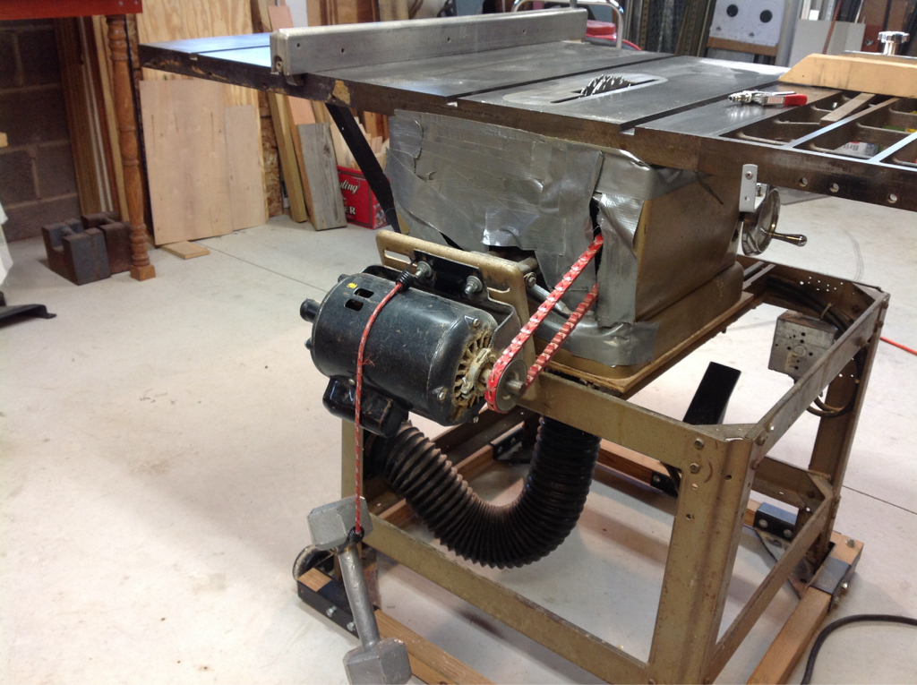

Now my dad uses it mostly and he can't do much at all but tinker in the woodshop so I need something easy for him to use without throwing breakers and binding up.
The saw has an electrical problem and I had it reworked a few years ago by a motor shop down the street. They were an old place that still used hand-written tags for work orders and when the old man retired it shut down. He told me at the time it was better to fix it than buy new because they were good motors. He had some parts on hand and said he probably couldn't get anymore after that.
It lasted about ten years since then and now I think it's bearing is going bad on the end and that's causing the rotor to short or something.
It's hard to start and doesn't have much power anymore. Today it wouldn't get through a piece of 2.5" oak which is hardwood but still should have easily handled it.
I've found some similar motors on eBay from same-era saws so I might pick one up.

Seems like electrical breakdown. Was slow to start and now needs a kickstart to get the blade turning. And when it runs it makes a noise like it's off balance. Maybe a bad bearing. I have looked at it before and it doesn't show any issues by sight. I've replaced the capacitor to no avail. I'll see if I can find a motor replacement to get me back in business.
/ Need a new table saw #16
Sounds like the start/run capacitor is bad. Pretty cheap to replace.

that craftsman saw looks like my dad's. of course you can still use it, just replace the motor. its bolted down on the plate. all you do is loosen the bolt on the top that locks the sliding bar , remove belt and slide out. you can replace the motor with same or stronger motor. or have it rebuilt, but warning rebuilt costs more then a replacement motor you can get from harbor freight or tractor supply that you can get right off the shelf. just match the rpms, and hp and voltage you are using which in your case should be 120v. I have the simalar craftsman table saw but upgraded model with cast iron ends and higher hp and its put together the same way. I got the upper model since i can see my dads like yours the motor is not cut out for regular daily use like i use it for. my dads motor would trip once awhile so i have to reset the button on the motor once awhile due to voltage drop from garage to shed. I dont see the point of replacing the whole saw if the bearings is still good for the blade shaft.

You could take the model number off the saw,and go here:Replacement Parts & Accessories | Sears PartsDirect Just a quick look for a 10" table saw that used a belt drive motor like that, the motor was pretty pricey at $320.00.

Joe some of the earlier motors had a centrifugal start. Before the problem, when you shut the motor off did it spin for a while and then "click"?
There are springs and linkages which engage and disengage at a certain rpm. Start mode and run mode. A spring could be broken or linkages need lube.
I haven't seen a pic of your motor configuration, I would try to save her, they are very good saws. Good luck.
