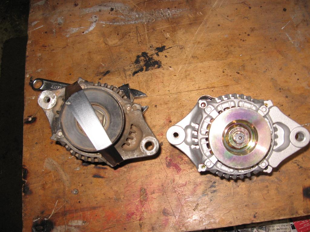

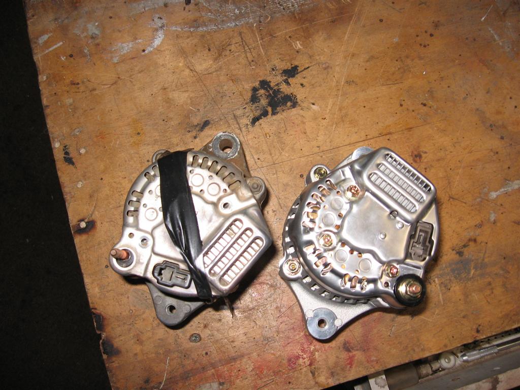

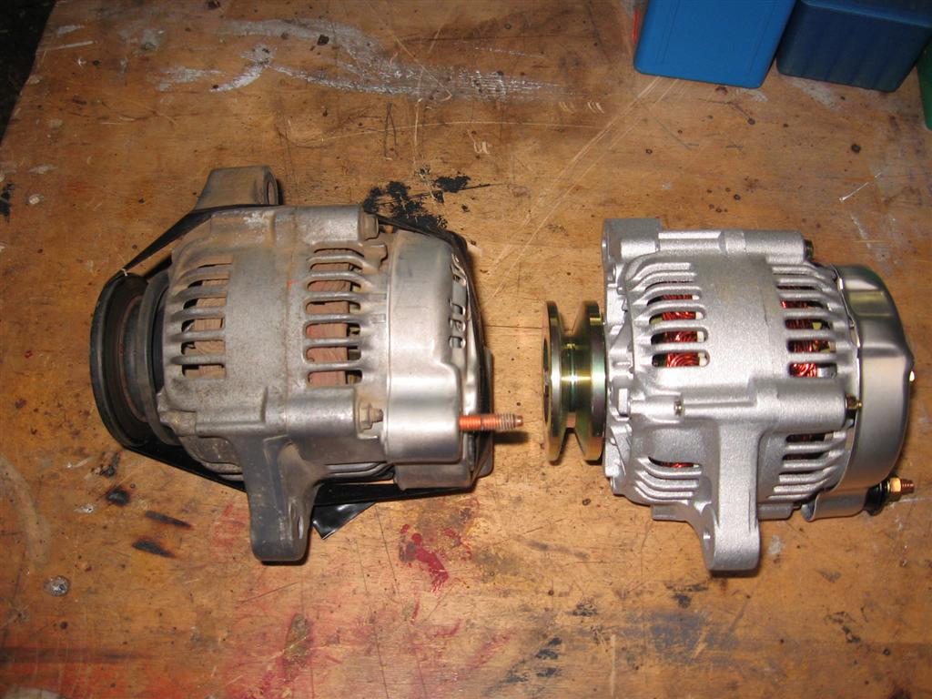

My alternator hasn't worked for a while and I wasn't going to pay $500+ for a new one. I was poking around the web and found an Ebay seller that sold them. Didn't have my exact part number but crossed it over. I received it the other day (about 3-4 days for shipping) and it looks good. Looks brand new, sticker has been removed. I haven't tried it yet but I don't see any real fault. The wiring locations are a little different but no problem for me...the plug is exactly the same. Mine was a 30a and I think this is a 40a. It was for a B or BX. $129 plus shipping. Check them out. He responded to my emails quickly and guaranteed it would work for me.

Looks like the only major difference is what i have been told is the "clocking" the relationship of the connectors to the mounting brackets. usually you can take out the 4 bolts and turn it to line up like the old one.

The differences between your two alternators is a common sight. One manufacturer will make several versions of the same alternator. I don't know why. Whether it's Delco, Mitsubishi, Nippon-Denso, Paris-Rhone, etc. They all do this.

Might just be the photo (or my eyes) but those two pulleys look different sizes in both diameter and groove size.:confused: But good price if it works.
Nope... good eye!! The diameter of the puley is actually about 1/2" smaller on the new one. Not a real problem there but I could switch out the pulley if needed. The V groove I think is the same, I don't recall any difference off the top of my head. But again not a major issue.
