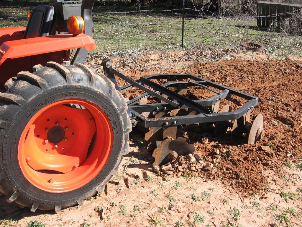

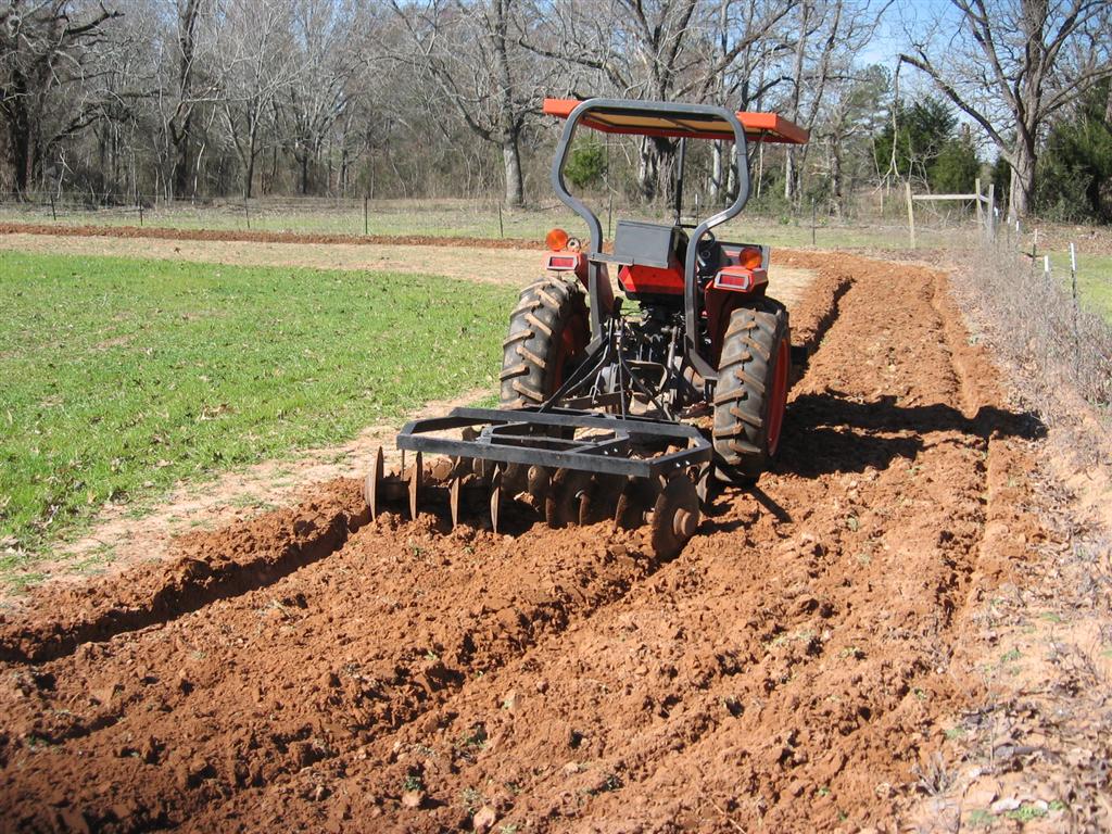

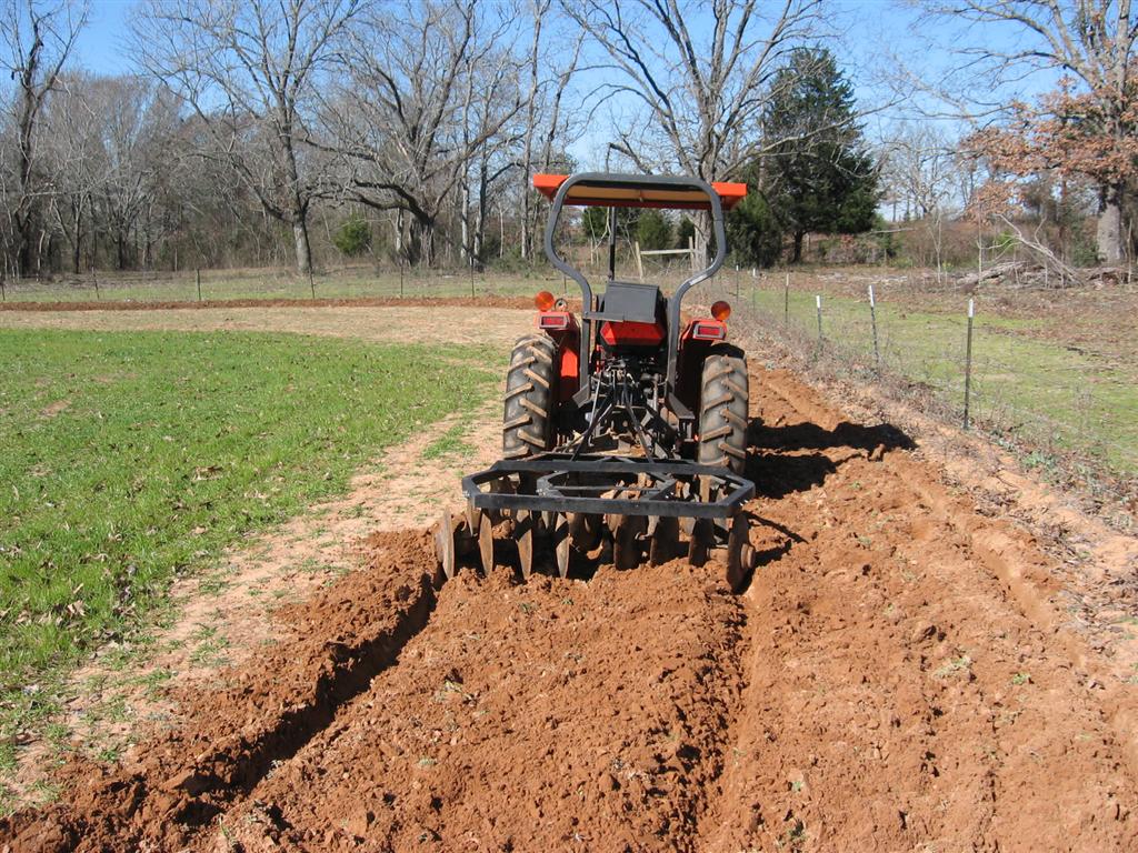

This should be a "normal" look.

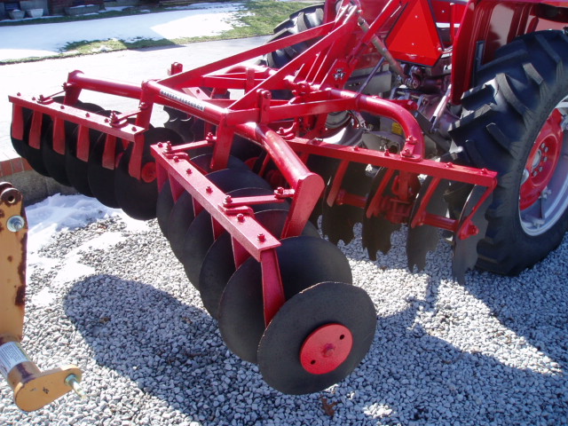

drz400 said:
The disc is a MF 25 tandem. It does have adjusting levers for the front and back gangs.Maybe I need to adjust so they are even. Thanks
The #25 MF disc is one of the best 3-point mounted disc's there ever was as far as leaving a nice level seedbed, IF set properly. You DON'T want it set full tilt aggressive, especially so once you have the ground loosened up a bit. Front gangs should be either one OR two notches from full cut, and the rear gangs one position LESS than the front. If you set the disc down while on a hard surface (driveway?) the front gangs should touch first, with the rear about half an inch off the deck.
As far as USING the disc, try your best to make successive passes at angles to previous ones. Go north/south, then swap to east/west. Repeatedly going over at the same angle will cause ridging with even the very best disc. The heavy drag behind the disc is also a good idea. I've always used a section of railroad rail. Anything H.E.A.V.Y. and straight will do the trick.
