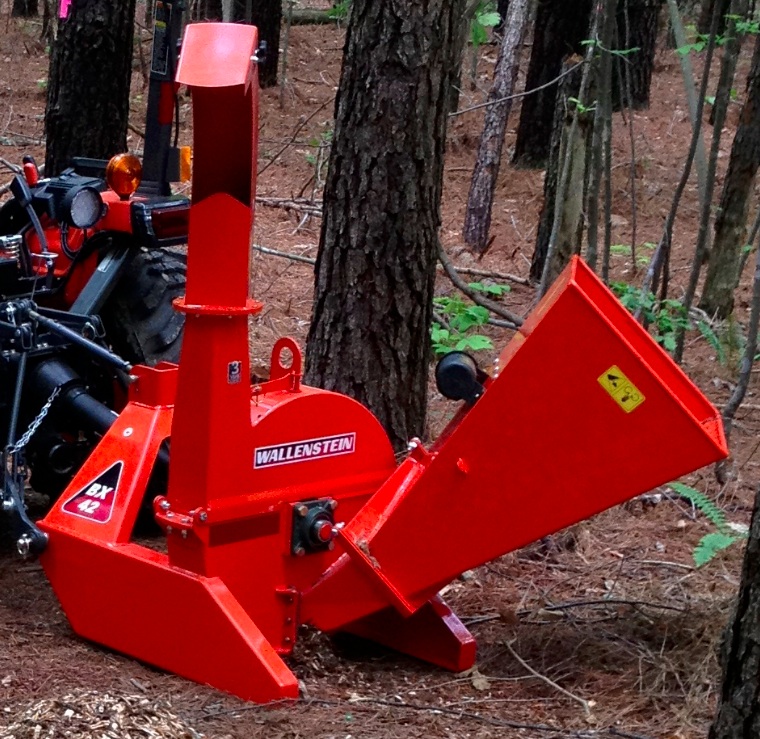

If you get desperate enough to drive to VA, I have a lightly used Wallenstein BX-42S in Kubota Orange that I have been contemplating selling -- probably in the $2300 price range (new they go for $2800-3200). It does up to 4" material (has a 4" x 10" throat) and self feeds for the most part. Direct drive (no belts) with a heavy flywheel.
Ain't nothing like a Wally!:thumbsup:
Great machine. Some of the best money I've ever spent.
