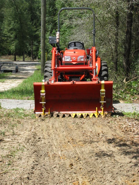

Two further (non-dealer) options I would recommend are bucket hooks and a Ratchet Rake.
I have Ken's bolt-on-bucket-hooks and I recommend them. Industrial art from Maryland, USA.
Ken's Bolt on Grab Hooks
I use my Ratchet Rake for removing brush and preparing plots. I bought my 52" RR at Tractor Supply for $299. There are a gazillion posts on TBN for Ratchet Rake; search.

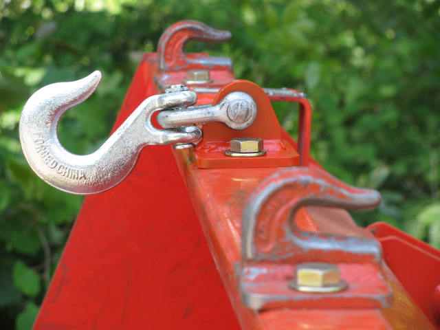

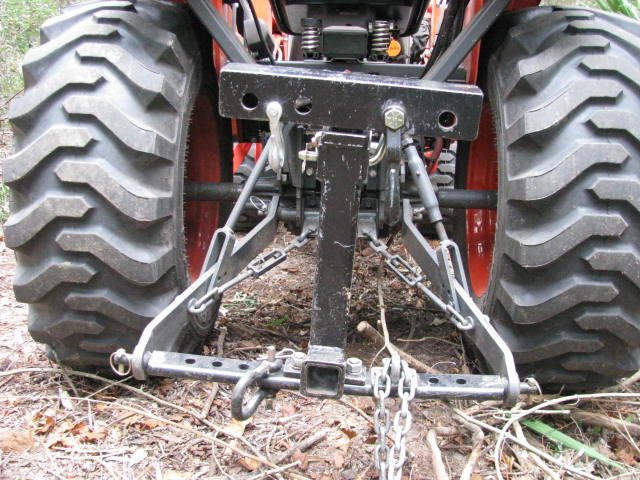

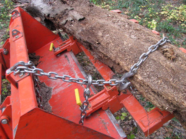

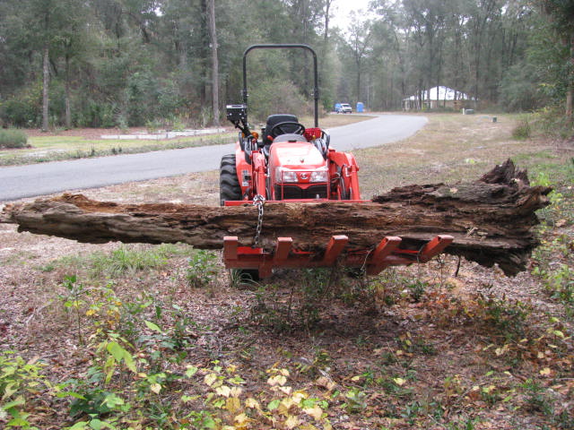

I was out in the woods today and snapped some fresh bolt-on grab hook photos.
Note that I have one bolt-on grab hook attached to the cross drawbar for pulling logs which might strain the FEL. Sorry third photo is not all that good......
I have used and occasionally abused Ken's hooks but they have NEVER loosened nor deformed.
No implement on the 3-Pt. Hitch. Tires NOT filled. With this decayed wet log on the FEL the tractor rear felt a little light.
Payne's aluminum debris forks are visisble in photo #1 + photo #2.

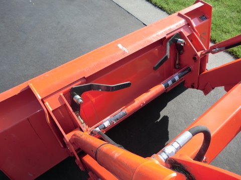

" pivot pin gradually worked loose then fell completely out. "
I'm under the impression that the B3300SU has a different quick attach than standard skid steer type.
I wonder if the design is more susceptible to this kind of failure. The quick attach on my L3200 seems very secure. Could you post a picture of your quick attach?
Wouldn't want the OP to get a bad impression if it's not the same type.
Here's the SSQA I'm referring to:

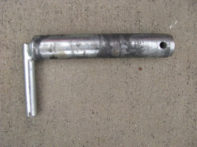

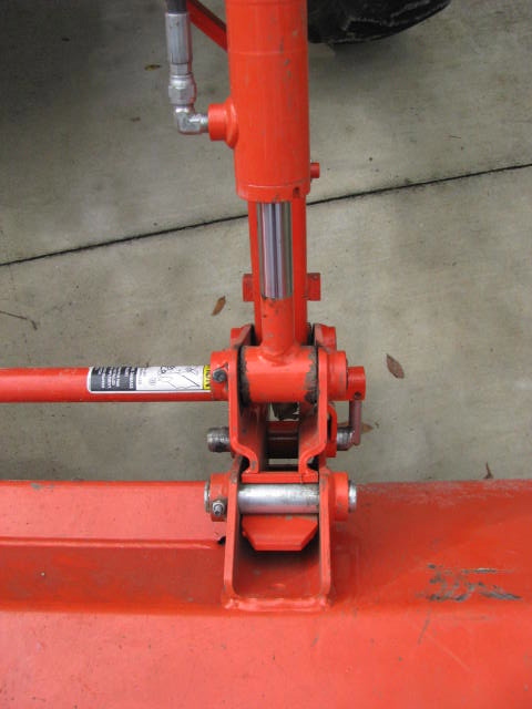

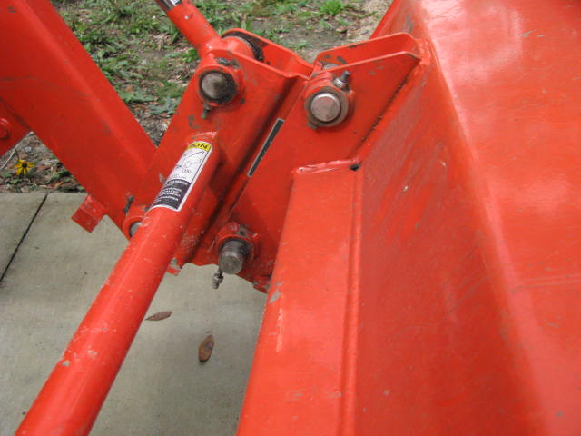

Below photos show Kubota factory Quick Attach mechanism for LA504 FEL which is standard on Kubota B3300SU tractor/loader package.
Operator should just have to remove security pins from four pivot pins, pull them, and nudge the bucket off with the joystick control.
I had the experience where one of the lower security pins flipped out, allowing the left, lower, pivot pin to drop out. Then bucket support frame warped so replacement pivot pin could NOT be inserted.
Offending pivot pin is also picutured, last. I found it a week/$1,200 later, where I had been working. So glad I have Kubota insurance. My out-of-pocket was $250, bad enough.
Now the four pivot pins are secured with 6mm machine screws and nylon lock nuts. Downside is bucket is no longer Quick Attach.
If I had it to do over I would have stayed with the standard, NON-QA, bucket as I have never removed the bucket during first year of ownership.
The four QA pivot pins are exposed to dirt/dust. I lubricate them with graphite.
