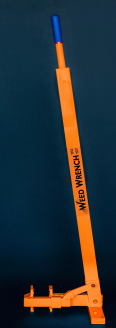

Outside of Austin Texas, we have a major infestation of Nandina (Heavenly Bamboo)
This invasive is so bad that cutting it off at ground level is only short term help.
Using a manual "Weed Wrench" that extracts at least some root works better but that is very labor intensive.

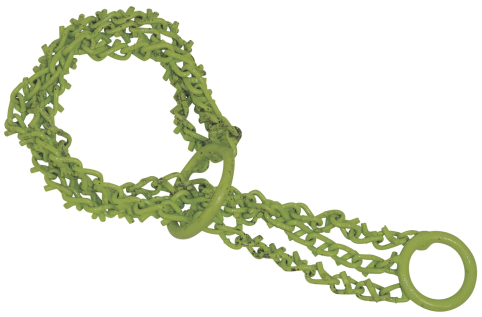

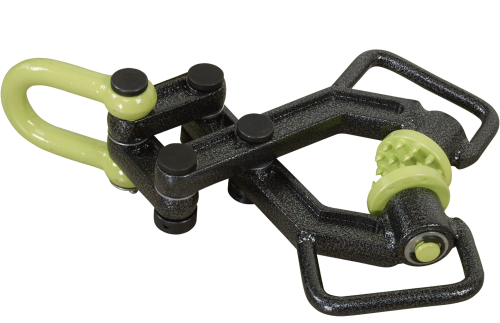

I have also tried "pullers" such as these but the nandina stems are so slick that the chain simply slides off and the stems are too small for the clamp pads to get a purchase.
The "waffel grid" on the weed wrench is wide enough and flat so it can grip several stems at once and pull the root that they are all attached to.
So, the question is does anyone have any suggestions for something that attaches to either the 3 point or bucket that can get a purchase on the nandina such as the pads on the Weed Wrench?
I have found some 3 point hydraulic clamp pads, but they are out of my price range.
I'm thinking about trying to modify the Weed Wrench to mount it on the bucket, but hoping that someone has already designed something better.
Also, does anyone have a suggestion for how to use the above chain puller to increase it's grip on the stems?

I have nandina here too but for us, the two types of invasive privet is far worse. We just used the last tool you pictured this past weekend and were very pleased with it. We were able to pull out multiple down right trees of privet that were 4 to 5 inches in diameter. Also worked pretty well on some trees of heaven but the bark does tend to come off in sheets somits hard to get a good grip. We pulled from the rear of the tractor though, not the bucket.
If you have the shrub chain type setup, have you tried wrapping it around the nandina several times to get more grip? We had large nandina that someone intentionally planted in front of our house before we bought it. I pulled those out using a regular logging chain that I wrapped around the stems. I tried to wrap it maybe four times with one of those times crossing over the other wraps. It worked for me. It helps a lot if it has recently rained a good amount. We took advantage of the 4 inches that the last hurricane dumped on us to get those privets pulled out.

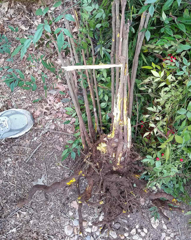

This is the type we are trying to address;
As the image shows, the individual stems are too small for the grip pad on the brush grubber to effectively grab.
The "skinned" section near the roots is where the weed wrench was able to grab multiple stems at once and you can see that the horizontal root structure adds to the force needed to extract at least most of the plant.
fwiw, I have tried wrapping the chain grabber multiple times without success... when it's tightened, the slippery surface causes the chain to slide up the stems. That said, I took another look at the chain after your post and I may try another way to wrap that might put more force in the grip.
"Post Rain" is a good reminder.
One of the nice things about forums is that simply the act of posting a problem forces the poster to think about possible solutions and that has happened this morning... I think I have a design to modify the pads on the brush grubber... will take a couple of days to scrounge parts, then cut and weld... will post in a week or so.
