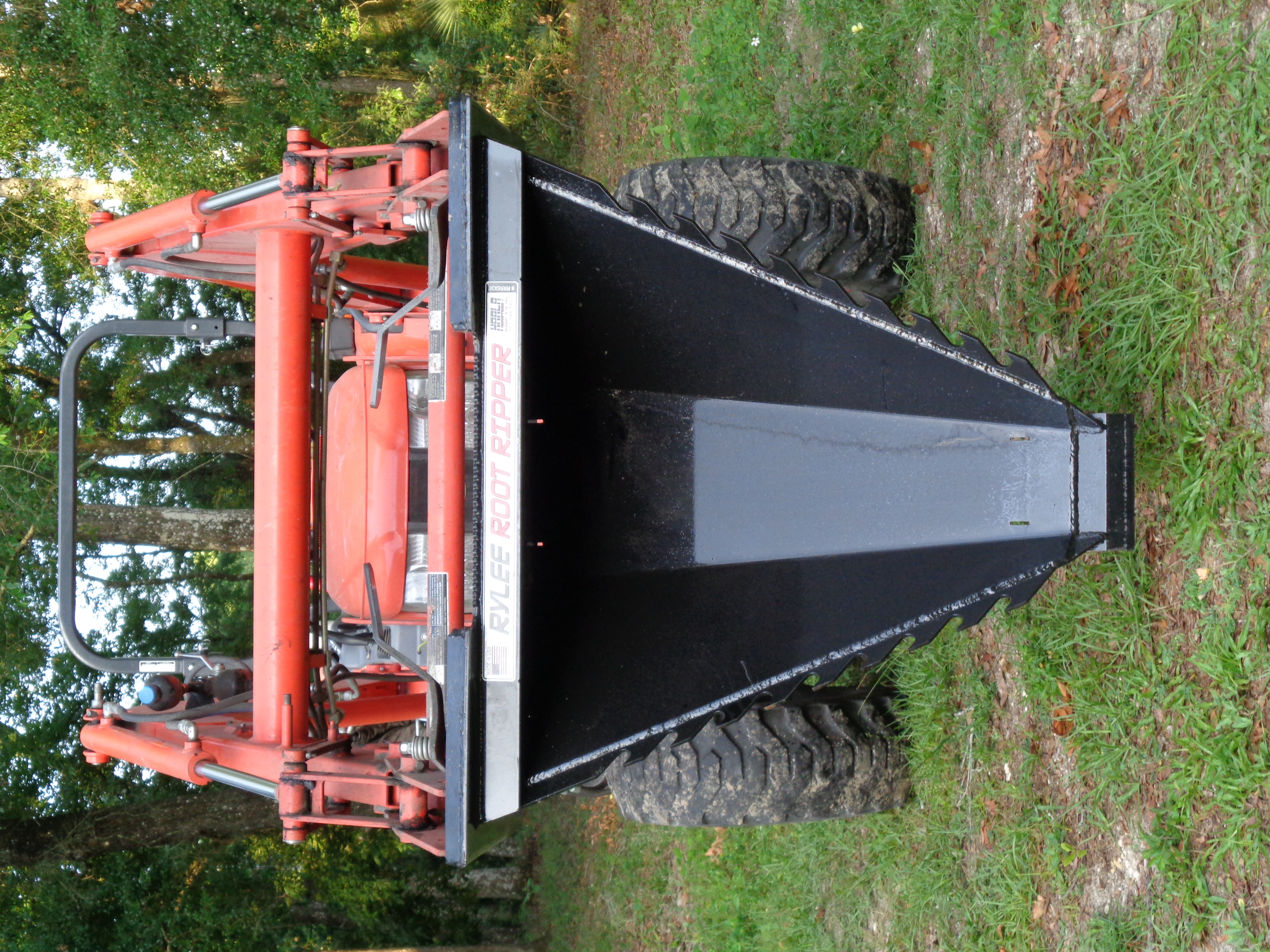

I recently acquired a 165 pound Stump Bucket with serrated leading edges for my Kubota L3560. The ground here is hard so I have had only one opportunity to trial it for 4" stump removal.
My first impression is the a Stump Bucket/Root Bucket in the ground is too much for my tractor FEL hydraulics, which have a lift capacity of 1,775 pounds. When I lift with the bucket in the ground hydraulic fluid sprays from the FEL hose fittings. A Stump Bucket shorter than 36" might be better for a tractor but I could not find a shorter one with serrated leading edges.
After a soaking rain, when the ground is soft, I will trial the Stump Bucket more.
SUPPLIER LINK: Rylee Root Ripper | Haala Industries
Hopefully you tightened up the fittings that are spraying fluid....
