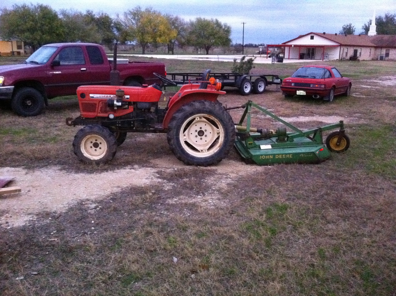

I recently bought a used Yanmar 220D. I believed that I had a good deal, but upon arriving at home and using the tractor more issues have arisen. Some of the issues are as follows:
1. the hour meter does not work. stuck at 416.3
2. 4wd does not engage, easily move shifter forward and backwards (will try the wheel test tomorrow that I read on forum)
3. 3pt does not lift as high as I would like
4. whining noise when in higher gears (possibly ring and pinion gears)
Other than that I am very happy with the tractor. So far I have shredded the yard, dug two 5x5x3 ft holes to push burned debris in, and used blade to push debris on fire. Tractor has operated smoothly so far. I am just worried about the 4x4 issue. Would really like to have this working.

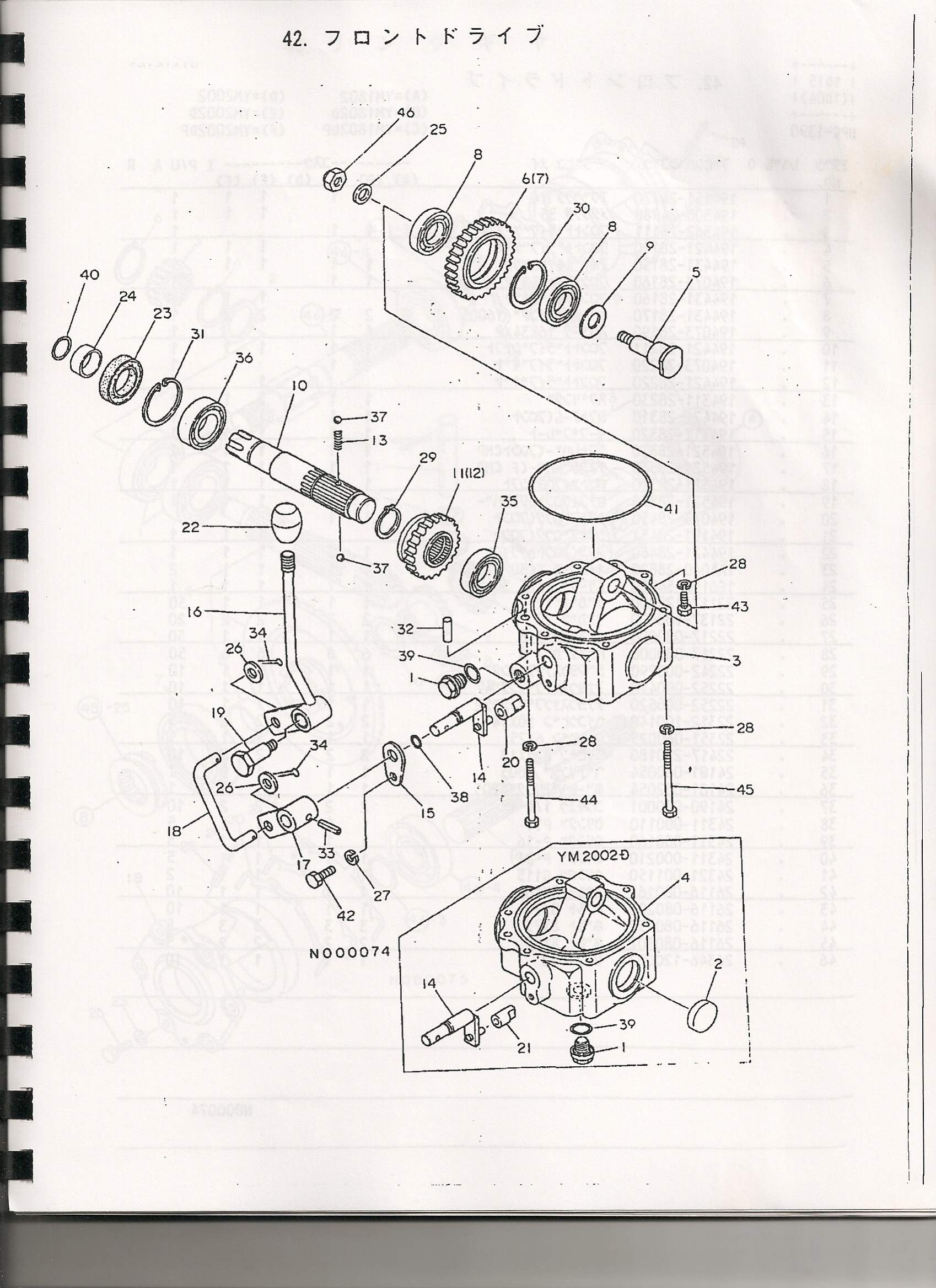

This is the drop box on a YM2002d. I believe identical to the YM220D.

winston1, thank you for the exploded diagram I believe it helps.

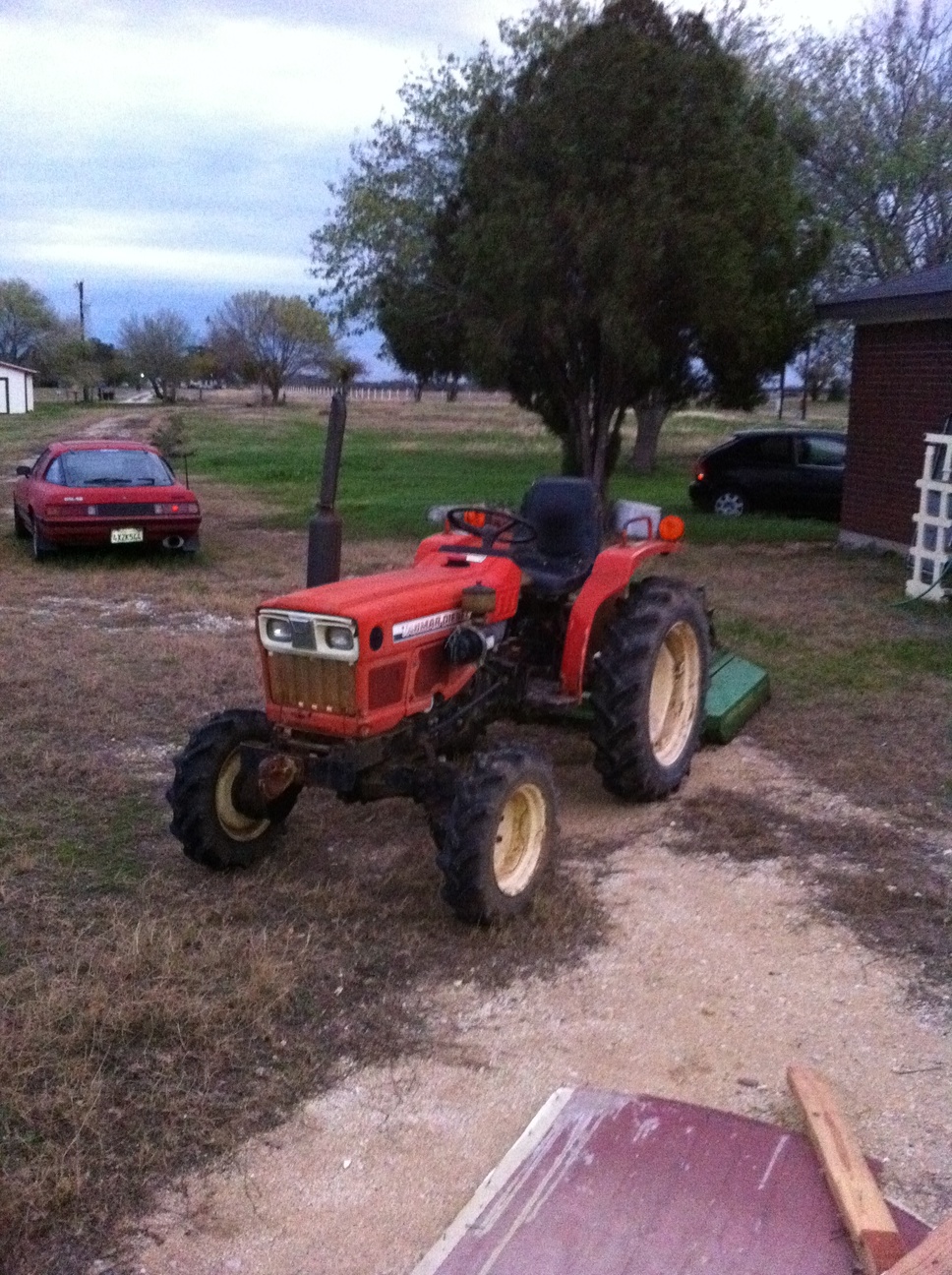

Also, you ought to consider swapping the front tires on your tractor from one side to the other. The rims are on "inside out," presumably to give better stability. All of the Yanmar manuals and suggestions I've read online suggest that having the rims running wide like that can cause damage to front axle components. It will also probably steer easier. It will track better in 4wd, for sure.

284 International, I just switched the tires on the tractor. Thank you for pointing that out. I would have not noticed that for a long time; if ever. I also did the test on the tires while I had the front end jacked up. When I spin one tire the other rotates the opposite direction. To me that is a little relief.

/ My Yanmar 220D #8
I believe to make any internal repairs you will have to drain the transmission. Then remove front drive shaft. Then remove six capscrews and then the drop box.

Is your 220D the same as in Winston's diagram? Is the linkage the same? It would be nice if there was just a missing pin or something. Otherwise, I think it may be as Winston said, and you'll have to remove the drop box to see what's inside.

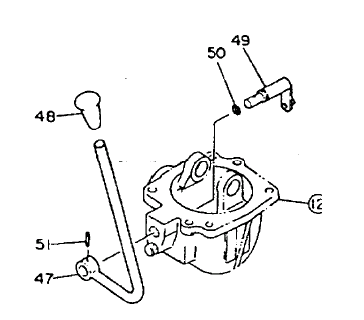

My 220D is a lot like the 336 in my opinion. I believe I also have to drain the Transmission Fluid and drop the dropbox. I only have the lever, a bolt, and this spacer on the outside. So I am sure I will have to get inside to fix it. Right now that is not on the top of my list.

While browsing around I found an image that I think best represents what I see when looking at the tractor.
