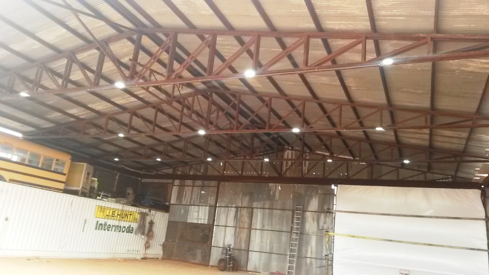

Let there be lights and plenty of them

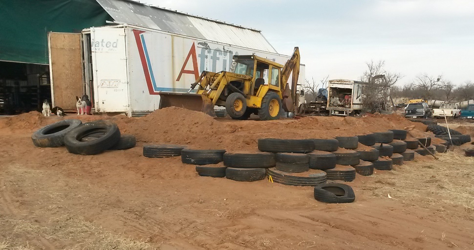

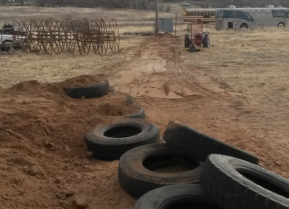

I figured out the perfect way to dispose of a bunch of old truck tires that have been accumulating over the years by burying them to make a retaining wall on the South end of the shop

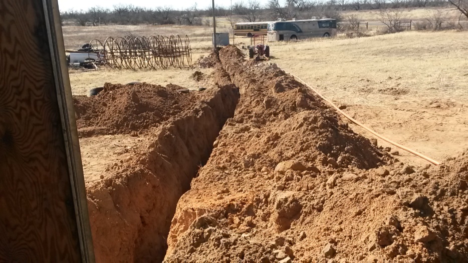

Before I got too far along though I wanted to also bury the electric cable to my well
so I dug a deep trench the 250 feet then laid in a 1 1/4" orange drop line donated by the fiber optics company I got the steel hose reels from

I like the idea of the tire retaining wall. Another repurposing that could make good sense for some applications/locations. I would guess though, that at least around these parts, doing that would not be allowed if the authorities were aware.
   / My work shop build in progress
#298
Just ask them which is better to make a long lasting retaining wall creosote rail road ties that eventually rot away and leach creosote into the ground or old tires that will almost never rot away or leach anything into the soil and what does eventually leach into the soils is consumed by microbial action + is an eco friendly way of upcycling something that by in large is not economically recyclable or disposable.
Back in the early 80's I had a company that did marine construction on many local Texas lakes. While working at a marina to repair a lot of damage after a then recent storm I told the harbor master they needed a sea wall to protect their marina.
His comeback to that was the association had been at odds with the city county and state for years to extend the natural land mass barrier several dozen yards by constructing a steel and timber sea wall, and to dump concrete or rock rip rap to the existing earthen barrier to prevent further erosion. He said every time the subject came up at a council meeting anything other than possibly the rip rap was immediately shot down. because they were concerned with stagnation of the water in the harbor area
So I drew up some plans to construct a series of nets made out of tires cabled together How I would suggest their placement for maximum wave action control while still allowing water to freely flow in and out of the marina to prevent the possibility of stagnation and that if installed as per my recommendations the break water could be moved if deemed necessary since the nets would be suspended from large buoy's with mechanical winches anchored to the bottom.
I further explained the nets would eventually provide habitats for fish.
in the mean time before their next council meeting I contacted fish & game and received their blessings in the form of a written letter. Knowing how bureaucrats minds function or the lack of, I learned that the State was on the city and county to do something with the tires in their land fills. All you have to do is convince them to pay you to remove and dispose of several hundred thousand tires then pay you again to essentially dump them in their lake while doing so will save them lots of money.
It worked and for a few years from the early to the mid 80's my company laced lots of tires together and dumped them in more than a few lakes. Mostly on a small scale as several much larger marine repair companies that mine did the same thing
I see the shop inspectors:unsure: are there to check out the tire wall.
hugs, Brandi
#300
hugs, Brandi
Oh yes nothing get past their ever vigilant watchful eyes. I spied one of them hiking his leg to a tire I had just filled. I guess he didn't like something about it so I hurried up and added 1 on top of it and filled it he sniffed at the latest tire looked at me and walked a few feet then laid down and watched me for an hour while I filled more tires. He finally got bored or distracted by a bunny or bird and left. After a while he returned and once again re-marked the very tire he had marked the first time. I would pay real money to know what they are always thinking about
