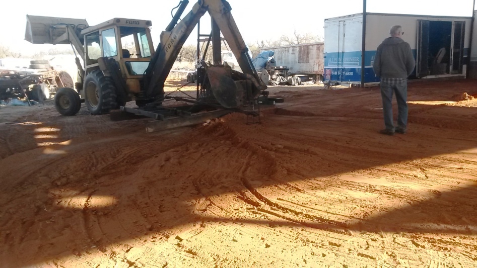

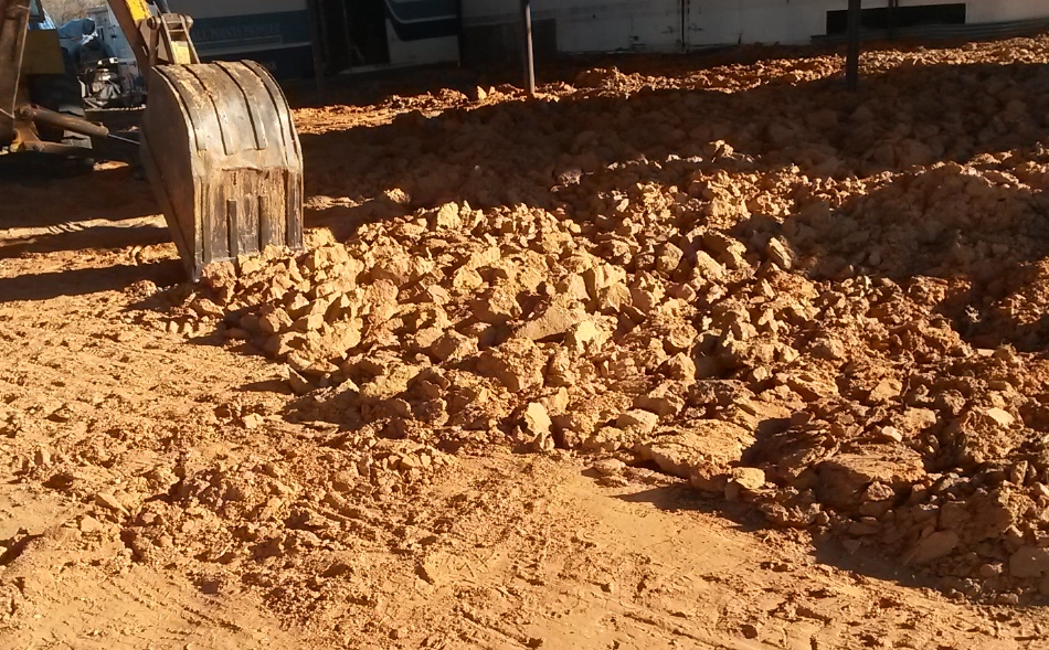

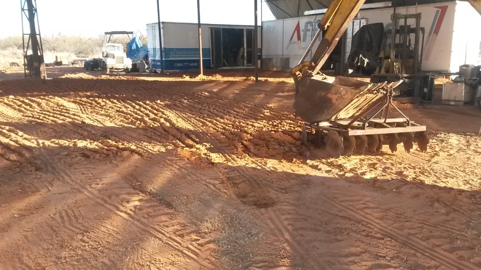

Over 2 years of adding the red sandy clay fill to the shop floor and it being packed down over and over had turned it almost into sand stone.
But now it is time to break it up for the next step in the process of making it into a durable floor that hopefully will not sluff off dust everytime something hard is dragged across it To do this the fill must first be broken up.
the rake Eddy was dragging behind his little tractor would scratch and scratch and eventually do a pretty good job but not nearly deep enough.
My leveling drag blade was too un wieldy in the confined area given its size plus it would just drag over the super hard spots.
I tried my tandem disk and this broke up some of the area quite well but I needed to bare down with so much force I was destroying it and still couldn't make it penetrate the really hard spots very well.
Even using the teeth on the back hoe bucket took all day to do less than 1/3 of the floor but at least with a lot of banging and only taking short gouging cuts each time it is finally being loosened into large rock like clods that should break up more easily
The box blade I have would have worked well I am sure. However there were 2 problems with trying it #1 was I don't have the ripper teeth for it and #2 my 8n would not have been able to do very well the Case 431 would be the tractor of choice but I haven't had time to work on it
