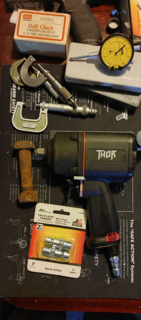

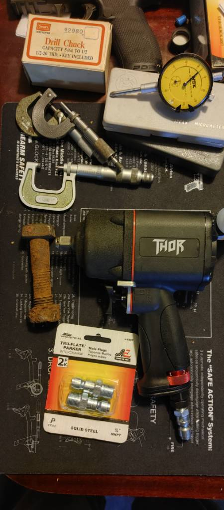

Been waiting 2 months for it. Summit Racing was out of stock. Summit has the best price too. The Thor is the hardest hitting 1/2" drive impact wrench ever made. At 90 psi, it delivers 950 pounds feet of left hand torque and 800 of right hand torque. At 135 psi it delivers just over 1000 foot pounds in reverse and 900 in right hand torque. Makes my IR Thundergun look like a toy and it's lighter than the IR is as well.
The torque settings are adjustable so you could use a normal (non impact socket) with it but at full on power, no standard socket could survive.
Been wanting one since the Torque Test Channel dyno tested one.
I'll be seeing if my HF impact rated sockets can stand the beans shortly. They do fine with the IR. Snap-On split and so did SK Wayne. Didn't even bother with the Chinese Crapsman stuff, I knew it was death for them.

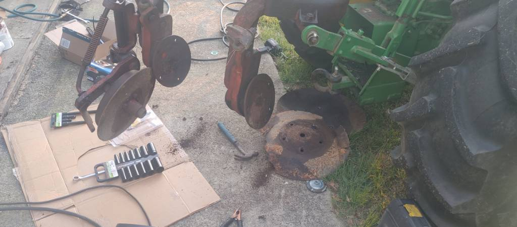

The Thor is rated at 1600 lb-ft in breakaway torque, and 940 lb-ft of working torque. I'm restoring an old Dearborn disk plow, and most of the bolts are eaten up with rust, and this thing hasn't struggle with a one of them. Even the 7/8-9 square bolts are no issue for it.
It's a ballzy SOB, that's for sure. I got mine for $145 off Ebay.

I certainly like mine. I see you went with high flow couplers which are necessary as well as large diameter air hose as the Thor is an air hog...
I give mine a shot of Parker air tool oil (in the inlet) before each use and no wimpy sockets either. Must be impact rated black oxide heavy wall sockets or the Thor will split them
Had good results with the HF black oxide impact rated sockets so far. It's a wicked impact wrench, no doubt. I do a lot of plow steel's with corroded bolts and nuts and if the Thor don't loosen them, it breaks them off which is good anyway as I replace them with new A325 dome head plow bolts anyway.
It does take some serious CFM however to realize the full torque potential. If you have a wimpy compressor, don't buy one. I run mine at 135 psi but I have over 35 CFM available. I can run at 175 psi but I don't see much difference between 135 and 175 actually.

Yeah those are Milton P style fittings. I bought these in the pack to get rid of the 1/4 adaptor that the impact comes with. These new fitting have a 3/8 NPT which make the 1/4 NPT adaptor unnecessary. I need more compressor as I have the old HF 21 gallon/2.5 HP compressor which maxes out at 125 PSI and I think is rated for 4.x CFM. I am running 3/8 hose and 3/8 Milton P style fitting though, and it seems to have plenty of torque even with not as much CFM as it's rated for. And yes I bought the HF impact sockets for it. I've used the HF impact sockets at my job for probably 15 years. It's one of those HF tools that do offer good bang for the buck without disappointing.
