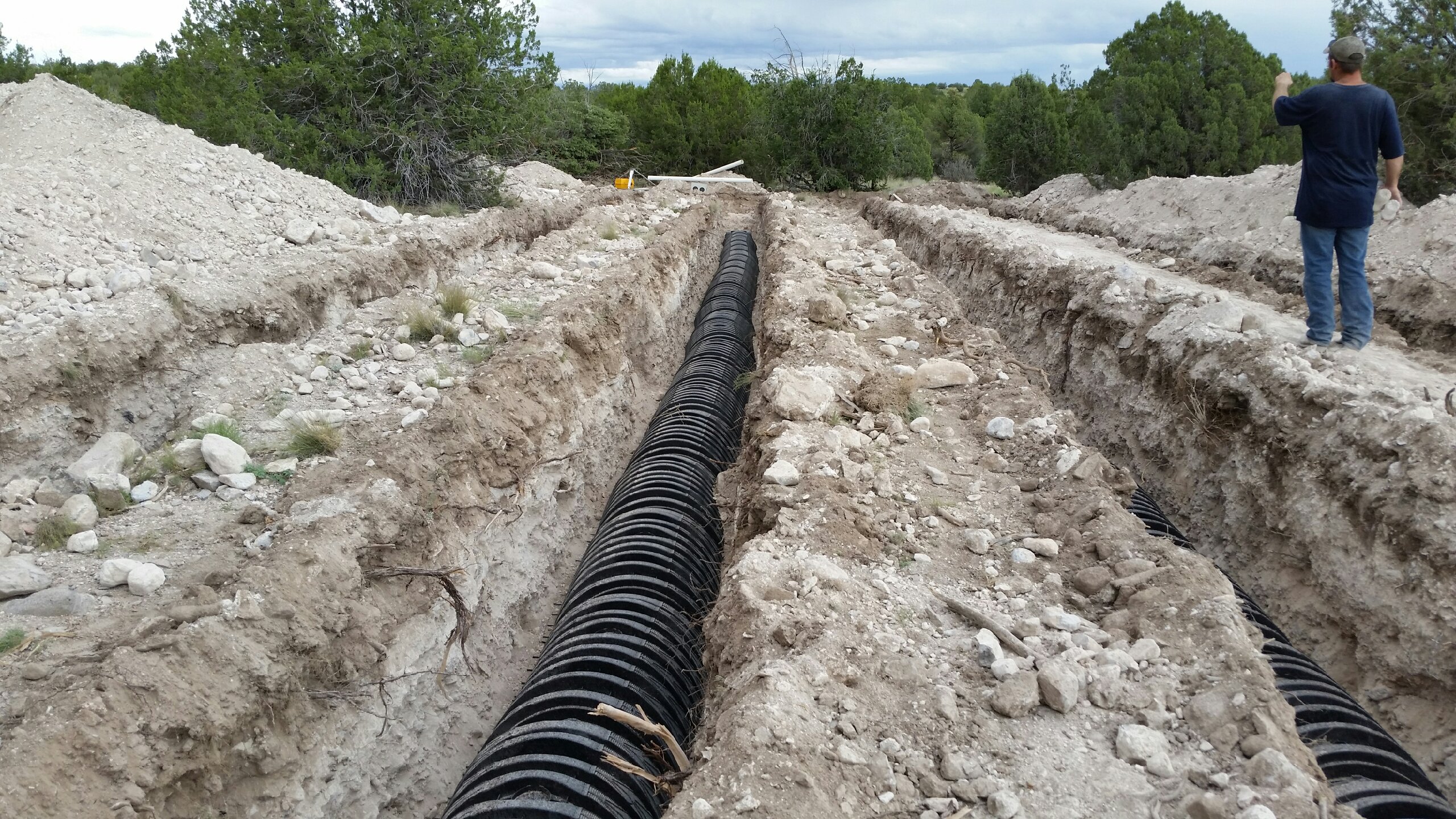

I have always loved aerobic systems. They have been around for many years. My folks had one
in central Ohio in the early 70s where there was no leachfield at all, and the effluent from the tank
went out to the storm drain system. It was clear and did not smell much at all.

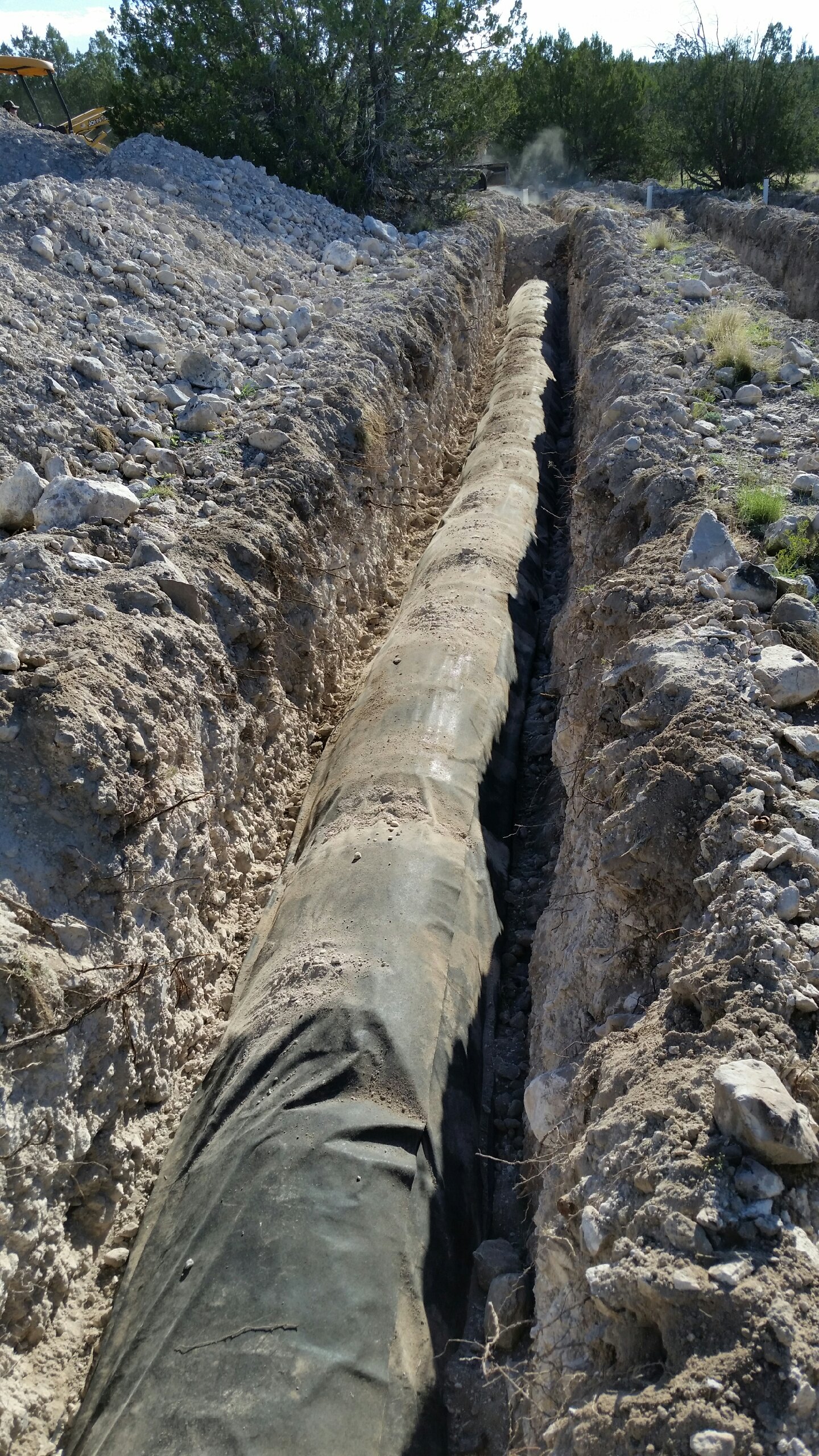

I have a pump-up septic here that uses Infiltrator chambers and 2 1500-gal tanks. I had the main
tank pumped for the first time after 15y of use. ($450 for one hour's work, no problems, easy access.)
Clearly, that is more than an aerator system could cost, as you have demonstrated. I may
have to install one.
I run a bubbler and vent fan in my 5000-gal water tank to remove sulphurous gases and it has
worked great. Note that an air stone failed there, so I just use a silicone rubber 1/4" weighted line and
an aquarium bubbler.
You definitely want to use a rubber/EPDM diffuser and not stone, since the stone will break down and clog. The EPDM will last a lifetime and never need cleaning.
There's no smell when you open the lid on the tank. It only smells "earthy" as in soil after a rain. The effluent is really clear.
Anaerobic (no oxygen) settic systems put out dangerous gases like methane, sulfur and other toxic gases. The effluent is usually black or brown and clogs the leach field with time. Aerobic (oxygen) systems like mine make a HUGE difference.

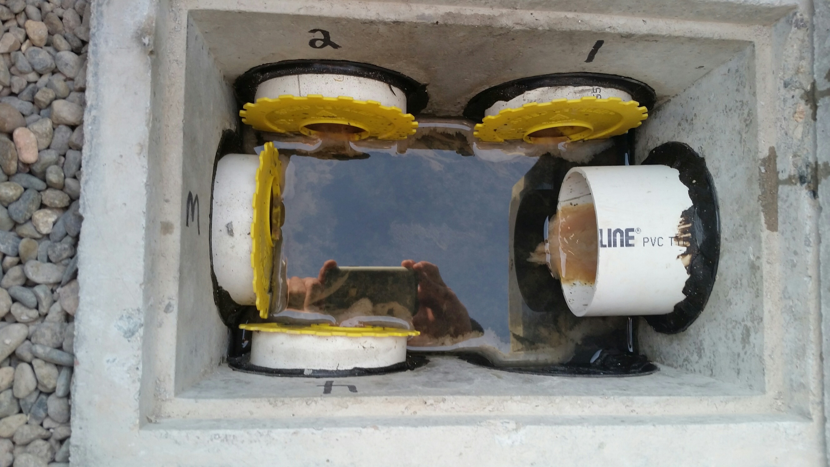

Since I have a pump-up septic system, I have a 2nd septic tank (aka holding tank) that is also 1500 gallons,
to assure the black water has no solids. The water is actually cloudy and light colored. The pump vault is
installed inside this tank, designed by Orenco Systems.

It's been a few years since my last update. The system is now over 3.5 years+ old.
Still no solids in the primary tank. Effluent is still clear and odorless (besides earthy smell). No issues and the air pump is still going strong with no maintenance except cleaning the air filter on it.
I've cleaned out the effluent filter on the secondary tank and it mainly had an algae like substance on it. No toilet paper or other solids on it. System is great and I am very happy with the results.
Neighbor had to have his septic tank pumped and he paid $550 to do so (1,750 gallon tank). It's expensive out here as they can't dump the sewage locally and must transport it 100 miles away. Not having to pay $550-$600 every few years is a plus with my system.
