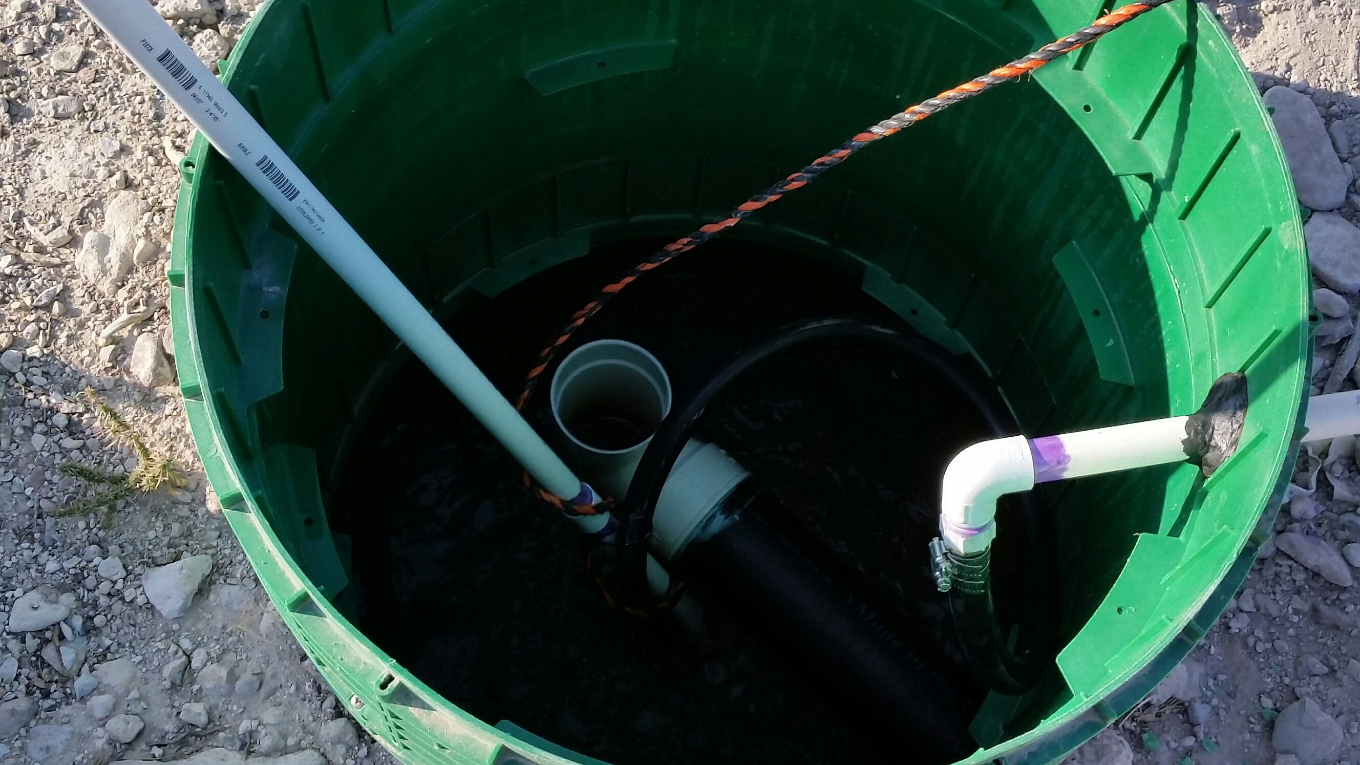

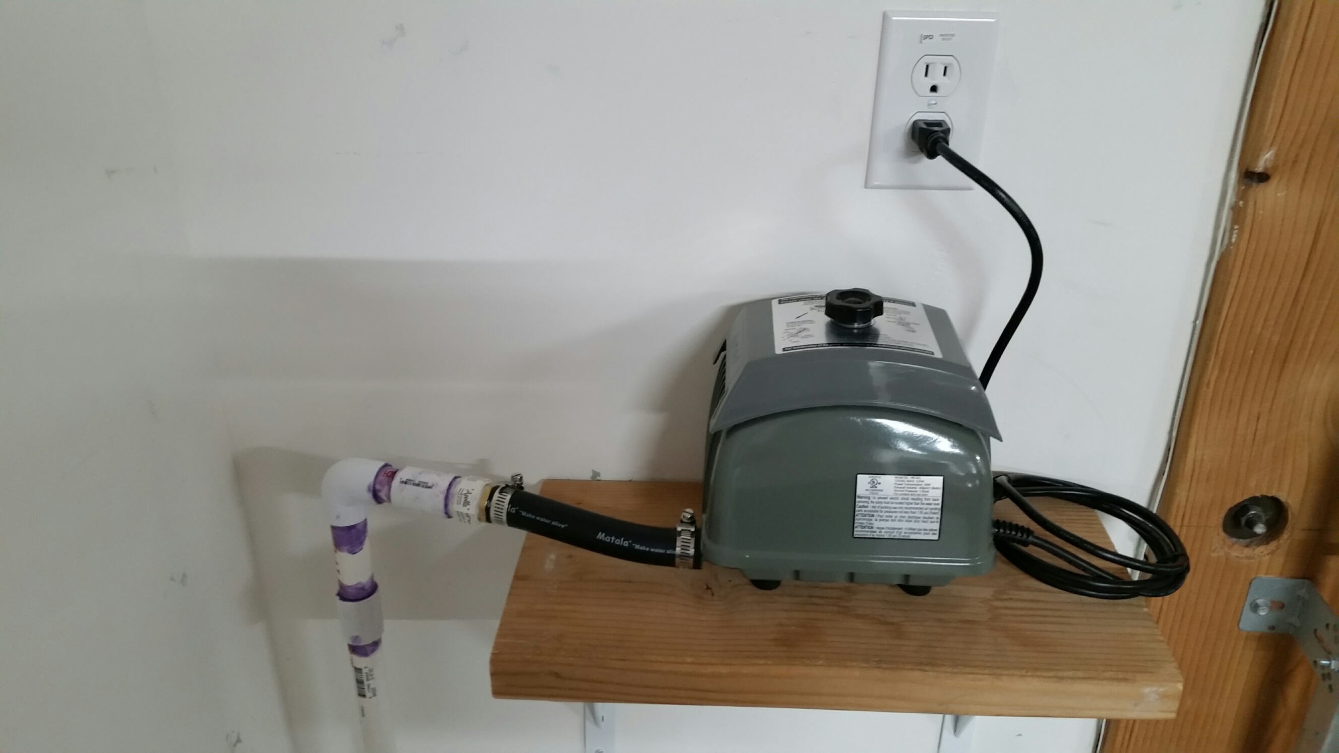

I designed my own setup which is a lot less $$ than the kits they sell online. Here is my original post:
I will sketch it up and give the best info I can. There are companies out there that sell aeration kits for septic tanks but they run about $1,000 - $1,600 for the systems. I did my own setup for $300 which included the air pump and diffuser (see previous posts for equipment info).
SUPPLIES:
Hakko 40L air pump ($180)
Matala EPDM Air Diffuser stick ($60)
Air Tube Diffusers - Air Diffusers
5/8" weighted heavy duty air hose
3/4" rigid PVC pipe
View attachment 533528View attachment 533529

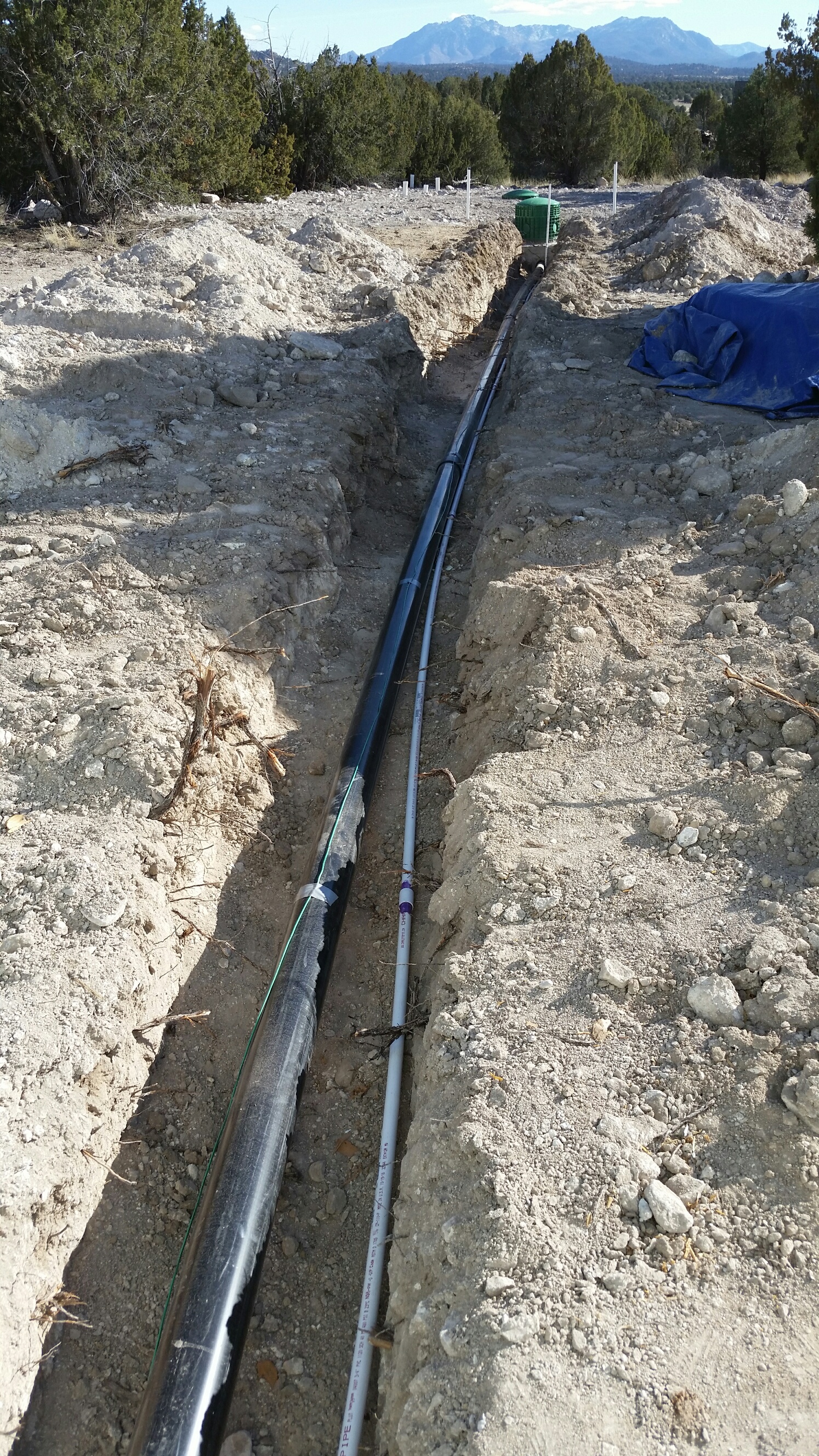

3/4" PVC pipe from garage to septic tank riser. This was buried next to the 4" ABS sewer line. (see pic)
Then it coverts to 5/8" rubber weighted air hose which connects to the diffuser using brass & plastic air barb fittings.
The rigid PVC you see in the picture is used to keep the diffuser from floating to the top of the water since I attached the diffuser to the PVC using a SS clamp and zip ties. The plastic septic tank access lid, once closed, keep the PVC pipe in place and thereby keeping the diffuser stick underwater. The PVC stick was cut to length once everything was in place.
The air pump sits inside a garage to keep it protected and out of the elements.
