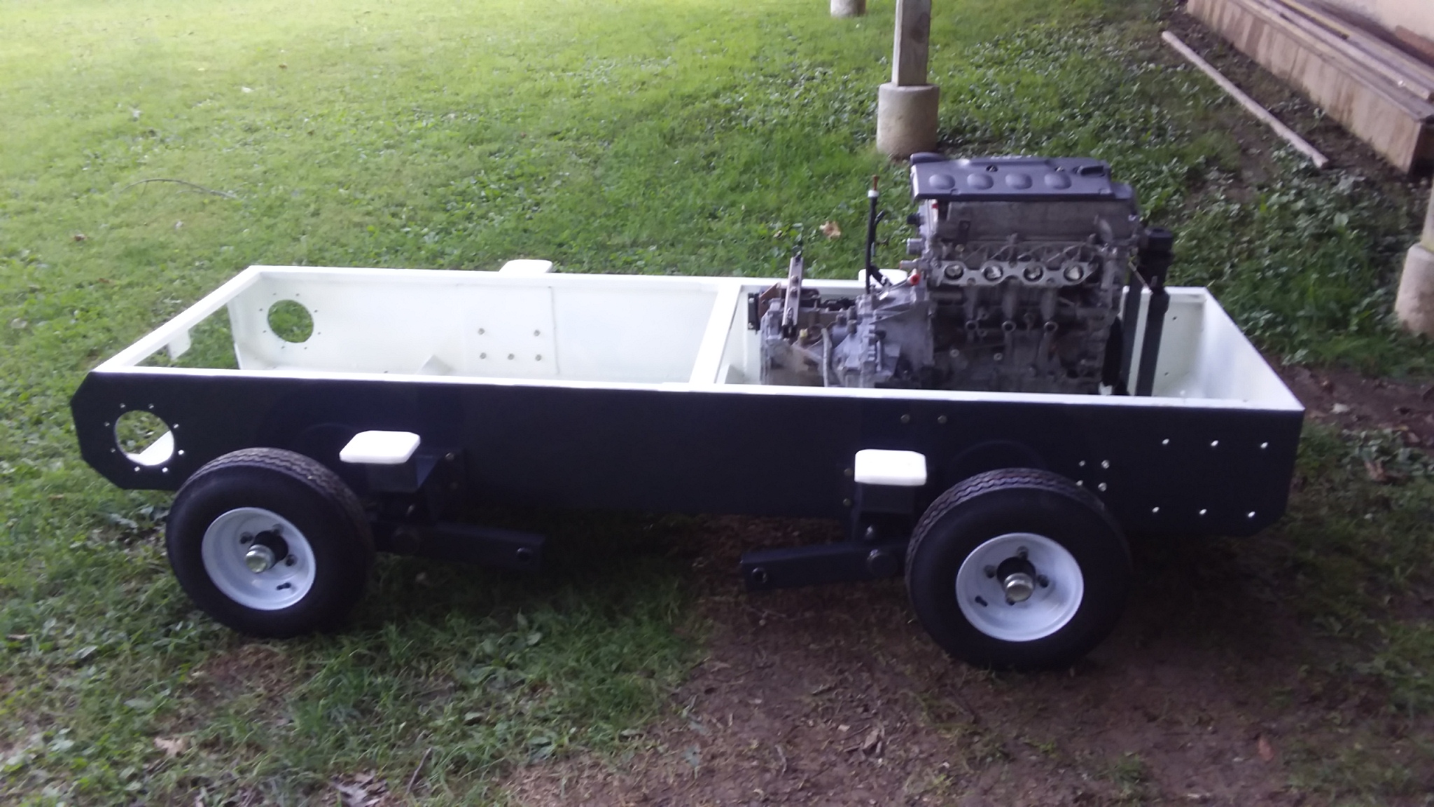

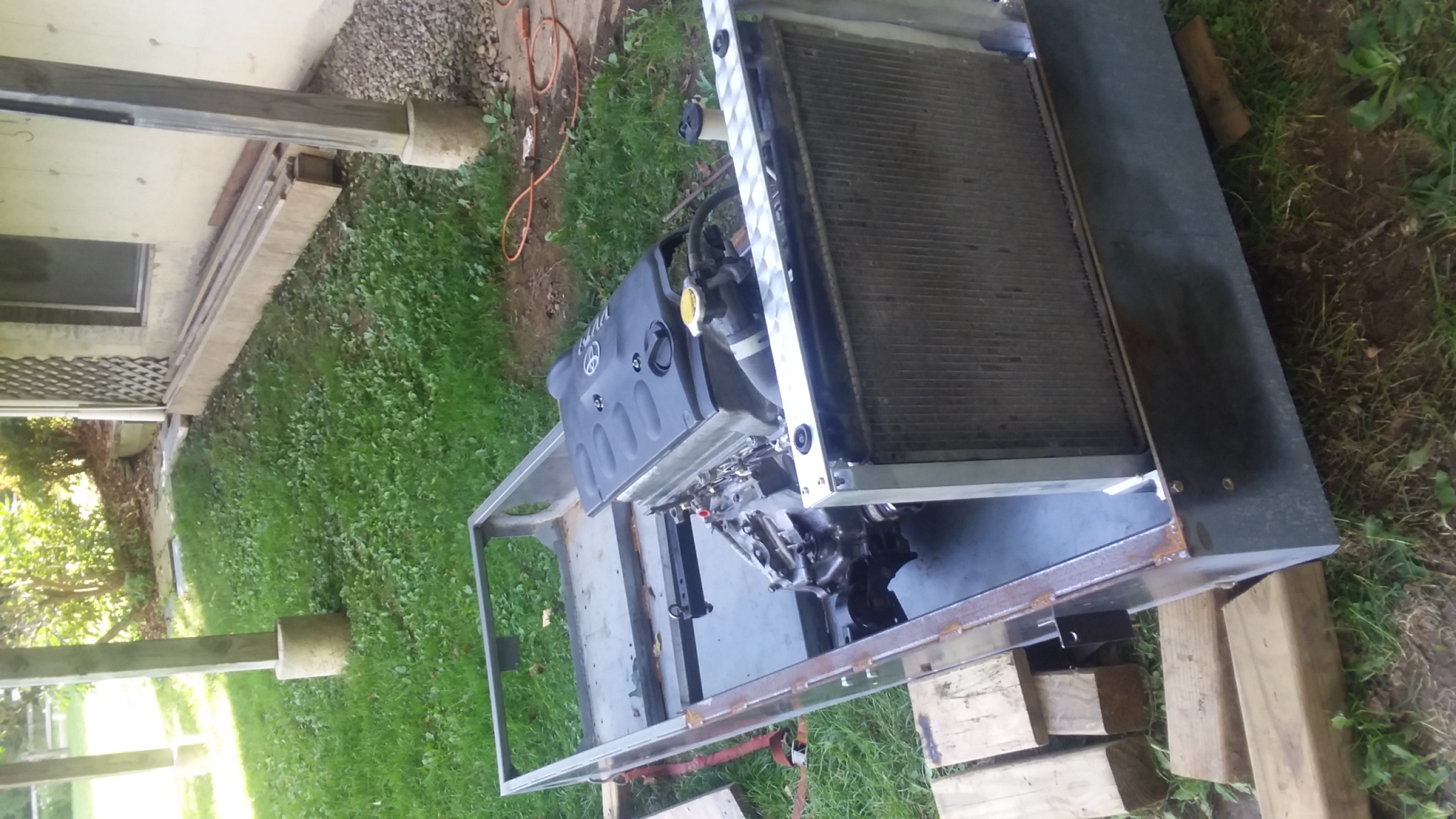

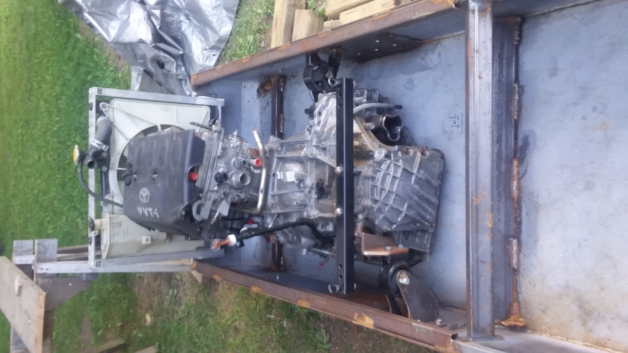

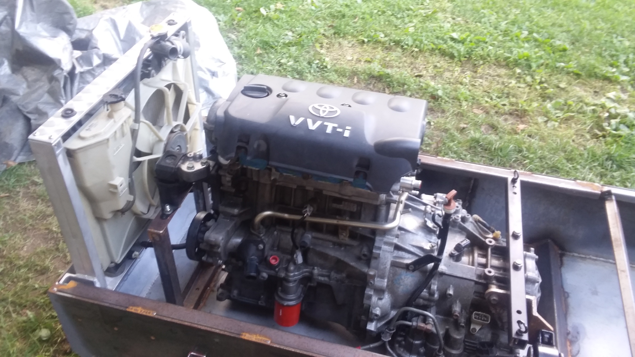

I've thought my foot was trainable - my wife says the rest of me isn't. :rolleyes: The tub frame is almost done as I have been adding some reinforcement plates and angles to it. After I paint it, I plan to start mocking up the cab. Here's some current snapshots showing the engine mounted.

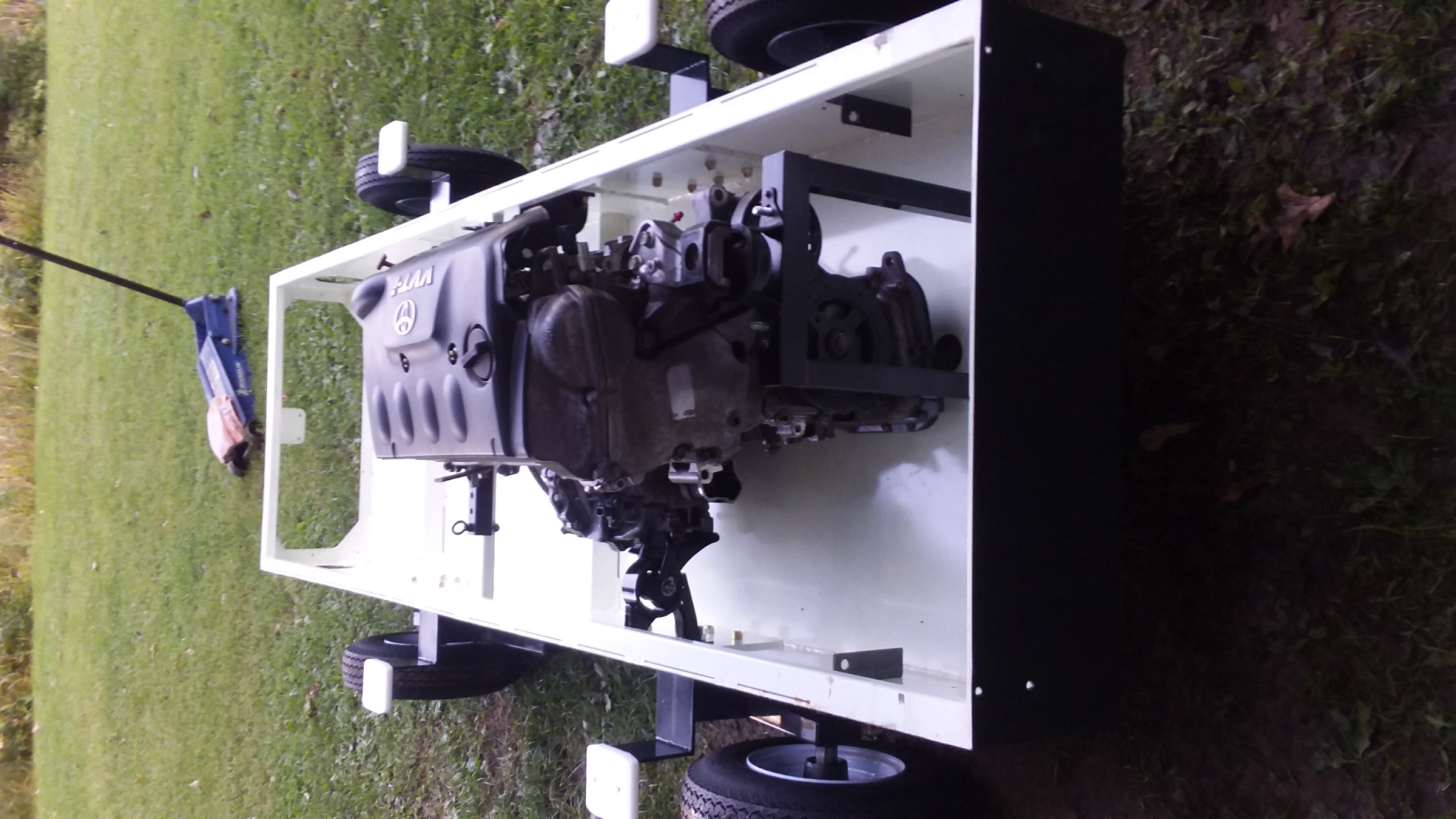

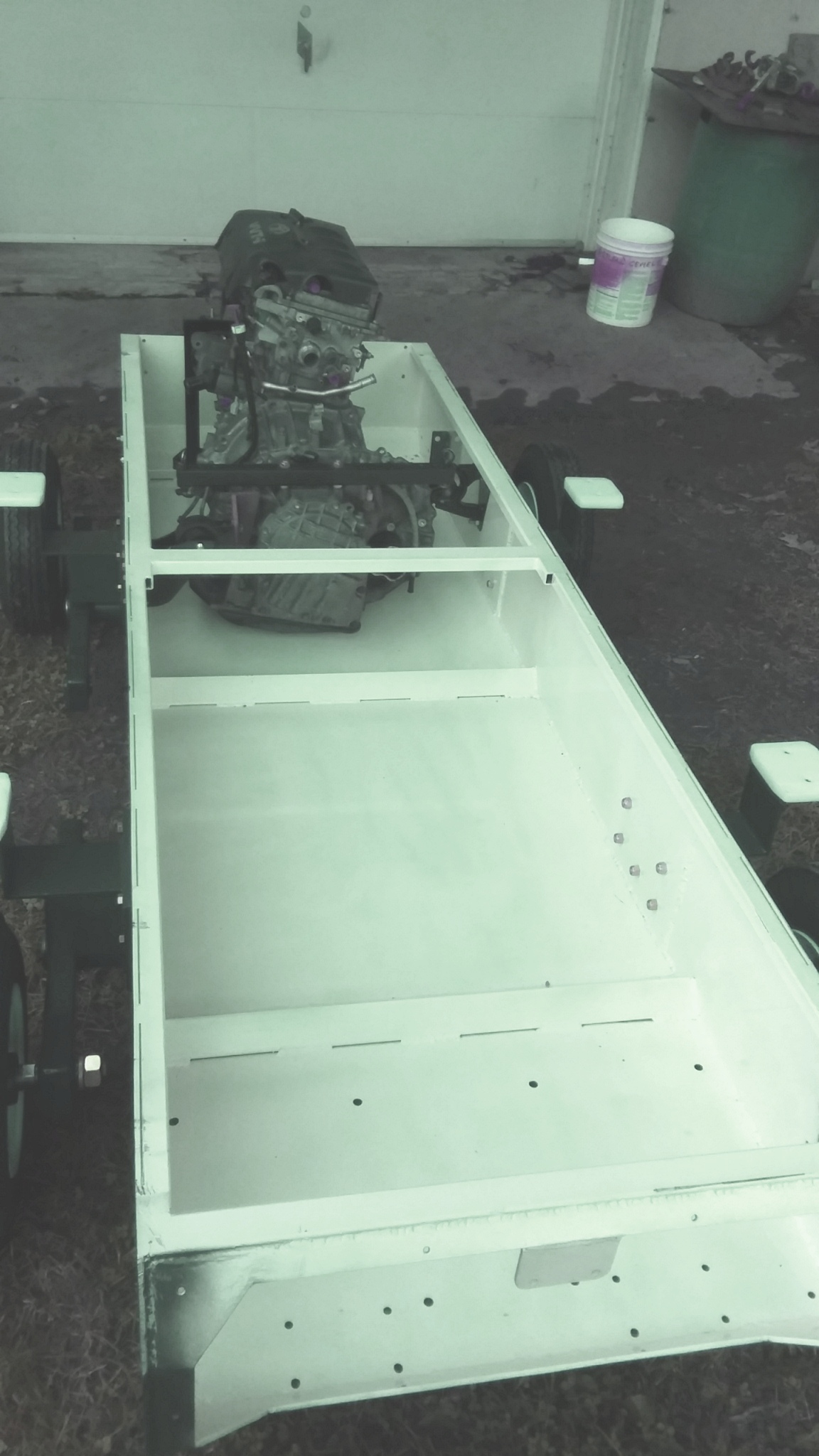

Hi all - I've got the lower chassis to where I can now roll it into and work on it in my basement - the mosquitoes aren't as bad there...

VVT - variable valve timing.... more computer controlled stuff to go wrong.
Nice looking build so far. Very clean. :thumbsup:
   / My Senior design project - a "Swamp Thing" tracked vehicle clone #85
Those engines are great with the exception of burning oil at high mileage and watch any oil sensors they start leaking and quickly drain the sump. Have replaced a few Toyota and Subaru engines over the years from faulty oil sensors.
If they signs of seepage just replace them.
