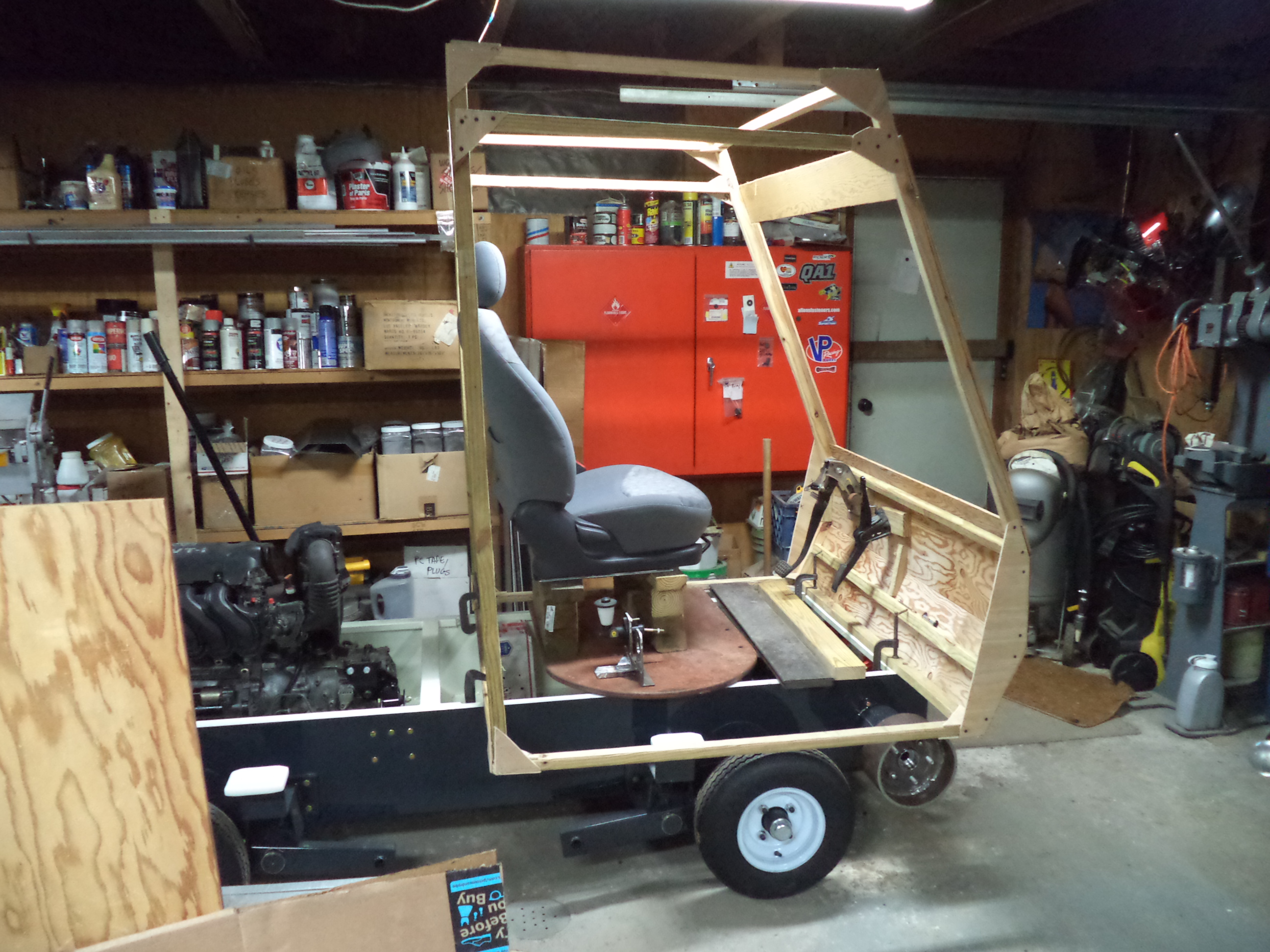

#91
Not much to report this past week. I've been evaluating the cab dimensions and decided it needs to be several inches longer and wider and 4" shorter. After building the stick cab, I noticed the drive sprocket teeth would be closer to the cab than I would like. It wouldn't take a very big stick or rock to get jammed in there. Subsequently, I plan to raise the cab by adding some 1" sq. tube on top of the frame. I hope to get some of the tube today for the frame and cab and start welding.

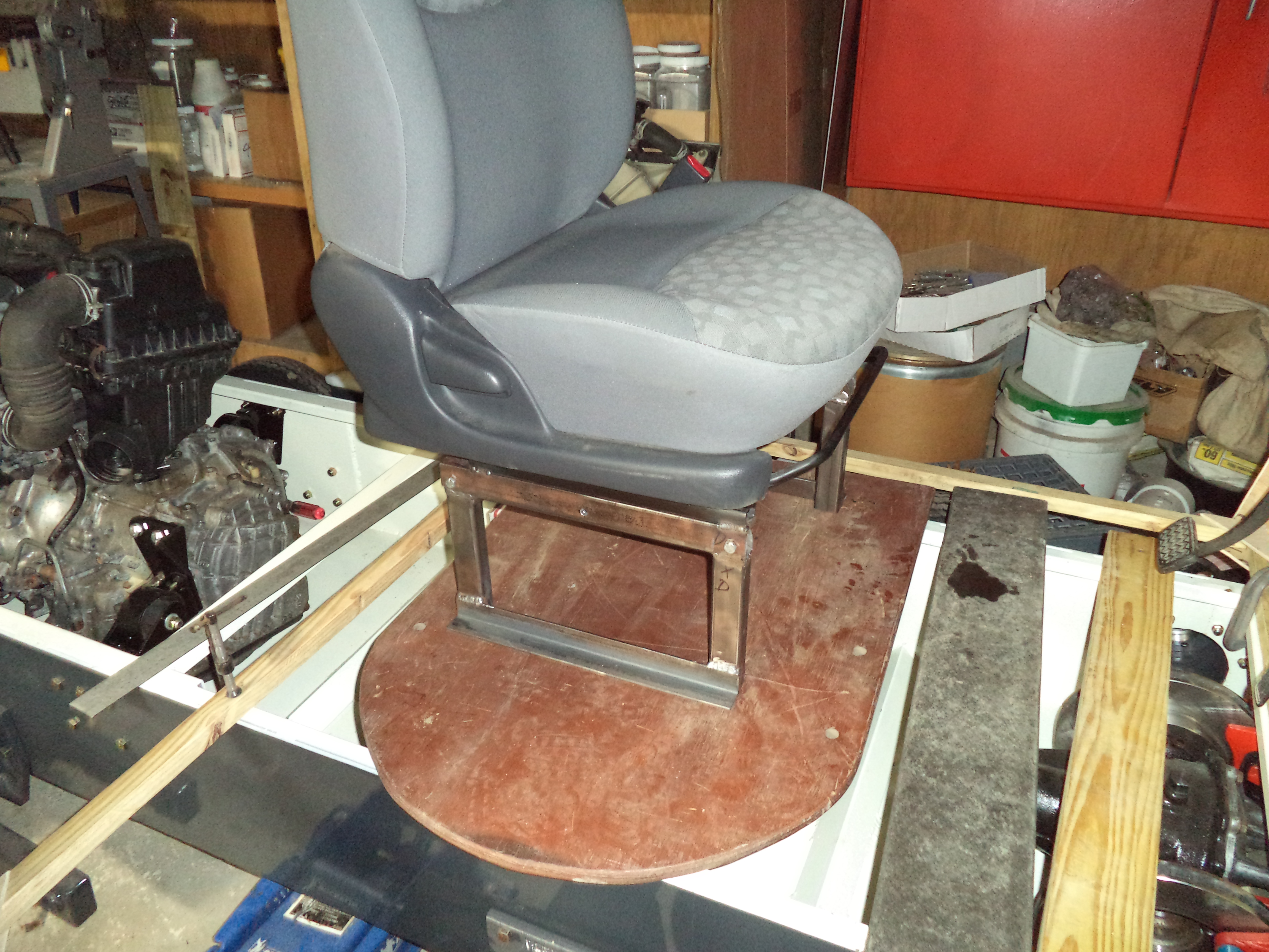

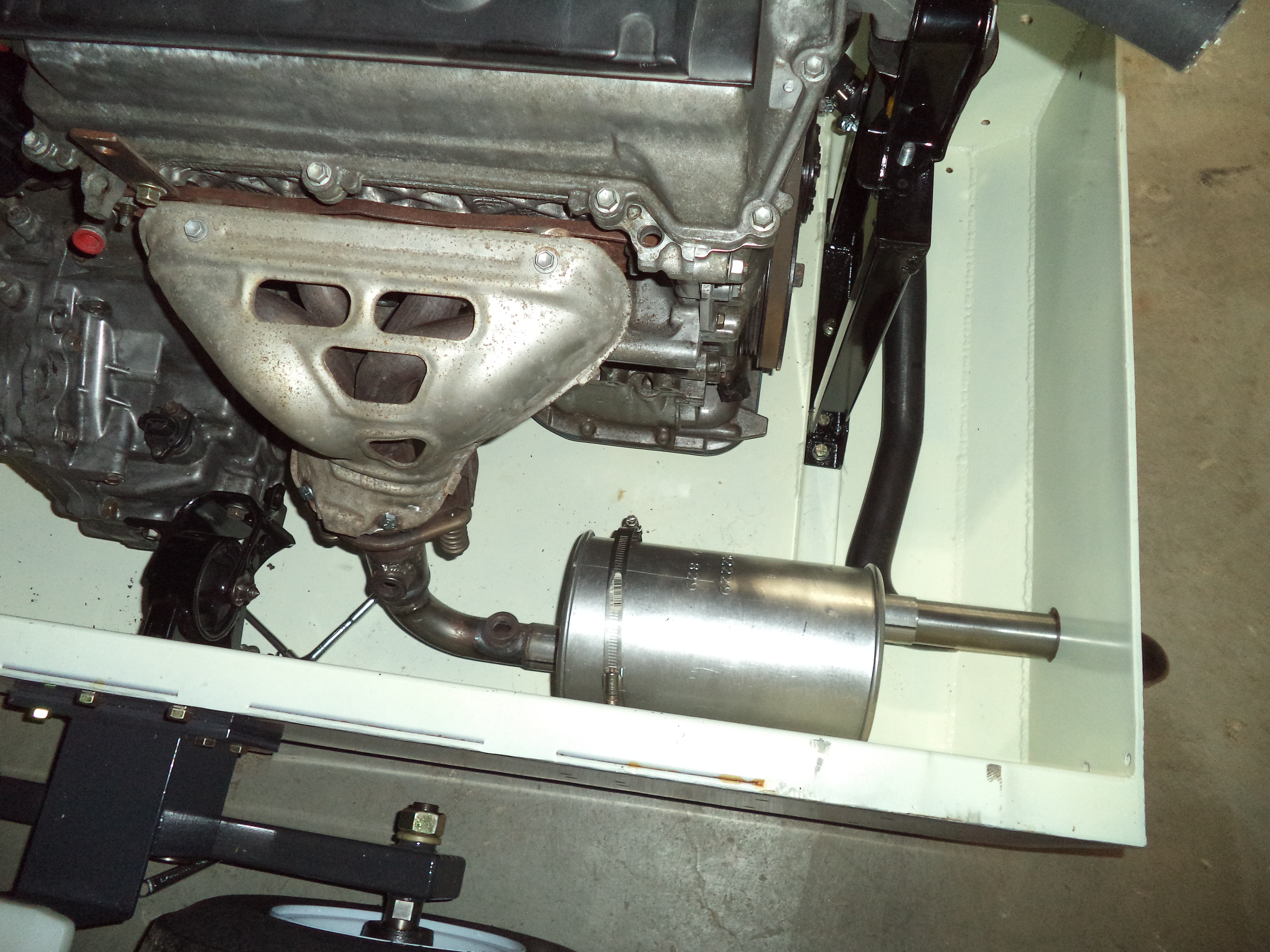

#92
Being a back-burner project, it's slowly coming along. I finished the seat supports and the exhaust system is piped. I made up some misc brackets and got the radiator hoses completed. I have the foot service brake calipers and pads on order so I plan to make the support brackets for them this week.
   / My Senior design project - a "Swamp Thing" tracked vehicle clone #93
View attachment 577624 View attachment 577625

Hi - I do not have any background in hydraulics and wondered how to get enough hp into such a vehicle. Care to define some of your performance & design parameters? Got an image of your design? My biggest concern at this point is the strength and durability of the driveshaft and half axles which I plan to fabricate myself from stock Echo and Rav4 axles. I could always buy stronger custom units if they don't hold up. I had the axles tested for hardness and found them to be case hardened. If I need more force to brake steer, I could readily add a vacuum booster to each circuit - there is room under the cab in the tub to put them.
   / My Senior design project - a "Swamp Thing" tracked vehicle clone #97
NVH
Noise Vibration Harshness; Think before you apply to the final assembly. It's no fun driving around the woods with ear protection because your contraption is too noisy, either from hydraulics or a poor exhaust system design.
Get the exhaust heat out of the compartment sooner, maybe through the side, you'll be sorry there is no catalyst on the thing, unlike a car at speed your machine will be slow and the fumes will be difficult to handle, not to mention dangerous. Maybe run your muffler outside like a tractor or big truck.
Regards and nice work, Fred
