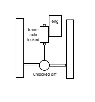

I recently received my official Toyota U340E auto transmission repair manual. I wanted to look into the difficulty in getting to the differential and welding it up. Well, it actually looks pretty easy so I plan to do the deed - weld it rigid.

Why lock the rear diff?
How can one steer the machine?
Regards, Nice project.
Fred
   / My Senior design project - a "Swamp Thing" tracked vehicle clone
#64
-> this design uses a front wheel drive car with an open differential , i.e, it does not have posi-traction. I will use one of the axles as the power side of the driveshaft to the other (also open) differential at the front of the chassis. One of the engine axles will either a) need to be anchored to the frame so the power will be transmitted to the driveshaft or b? the gears inside the differential need to be welded thus "locking" the diff.
-> the front driven differential has a brake rotor placed on each side - these are used for steering. Pull the right steering lever and the right brake caliper actuates thus transferring power to the left track to turn right. Make sense?
   / My Senior design project - a "Swamp Thing" tracked vehicle clone #65
Makes sense. I was confused as well. There is another dif for steering other than the dif you are locking up.
   / My Senior design project - a "Swamp Thing" tracked vehicle clone #66
I think this is the approximate arrangement:
Bruce
   / My Senior design project - a "Swamp Thing" tracked vehicle clone #67
Isn't welding the internal spider gears the preferred option? Fewer parts spinning around.
#68
-> yes, that is the plan.
