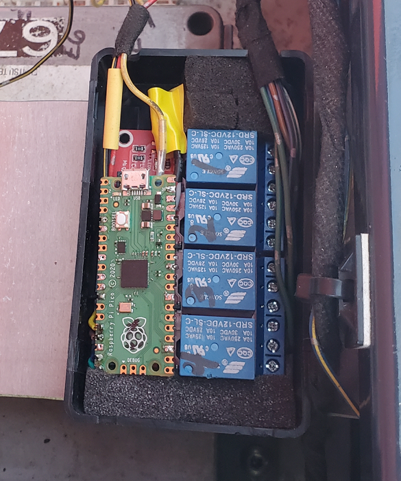

So today, I got my prototype rev limiter circuitry bench tested OK and tomorrow I hope to install it onto Snowzer to test. I plan to limit it to 4000 rpm before starting to cut out the injectors one at a time. ;)

Today after a few fits and spurts, I got the rev limiter installed and it works well. I have it set to start to de-energize individual injectors at 4000 rpm at 300 rpm increments. Here's an image of the module guts. Basically, the yellow wire is the tach feed from the ECU that the Pico microprocessor evaluates to determine the rpm. If it gets too high, it fires the appropriate relay(s) to turn off the injector(s).
