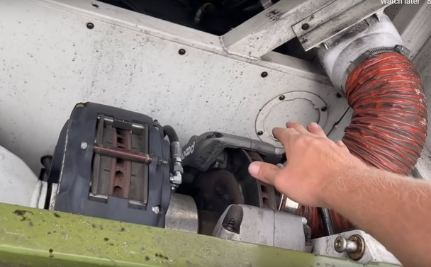

I've wondered what the Ripsaw's drive system is comprised of.
Depends on the version of believe. Diesel, maybe a Duramax, Allison transmission. Bunch of brakes on the rear axle. Never did figure out the details, but it looks like some of the calipers rotated, which I never understood.
I watched
a year or so ago when it came out. Think that one has them working on the drivetrain a bit. May have been a different Cleetus McFarland video, or one from Heavy D Sparks before he sold it to Cleetus.
Truly impressive machines, but costs more than a Lamborghini & seems to require more maintnance. Maybe if I win the lottery some day.
   / My Senior design project - a "Swamp Thing" tracked vehicle clone
#582
Thanks for the video. I see that they are probably using brake steering in that Ripsaw model.

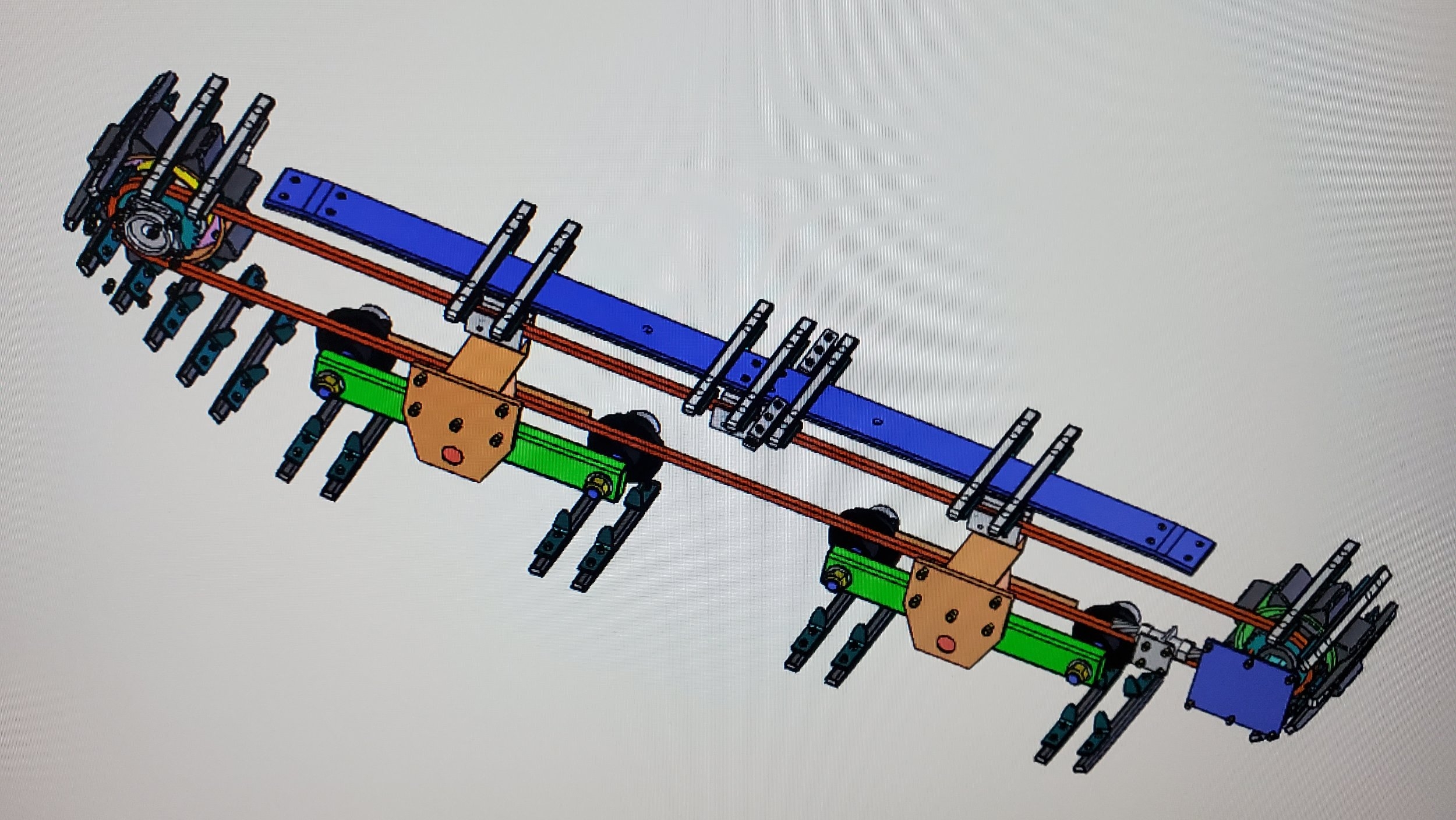

A quick update on my tweaking: I plan to be heading up to my parent's place in a few weeks to check out the previously mentioned hardwood supply that I plan to use to build and replace at least 4 of the eight idler wheels. If it works out well, I will build the other 4. One of the shortcomings I found of using conveyor belting for the track construction is that the belting stretches quite a bit especially when turning. This stretching causes the extended belt to bunch up or bulge at the front of the track. This reduces the number of driven teeth in contact with the track bars on the front drive sprocket and results in the track slipping over the sprocket teeth. To remedy this I thought about installing some roller chain to connect the front drive sprocket to the rear idler wheel effectively making it a drive sprocket as well. I was not sure I could fit it in there behind the sprockets but according to my cad efforts, it could fit. I plan to use some 520 chain which has an ultimate strength of about 6100 lb. Any comments as to why this might not work? This chain installation will be pursued next spring at the earliest.
