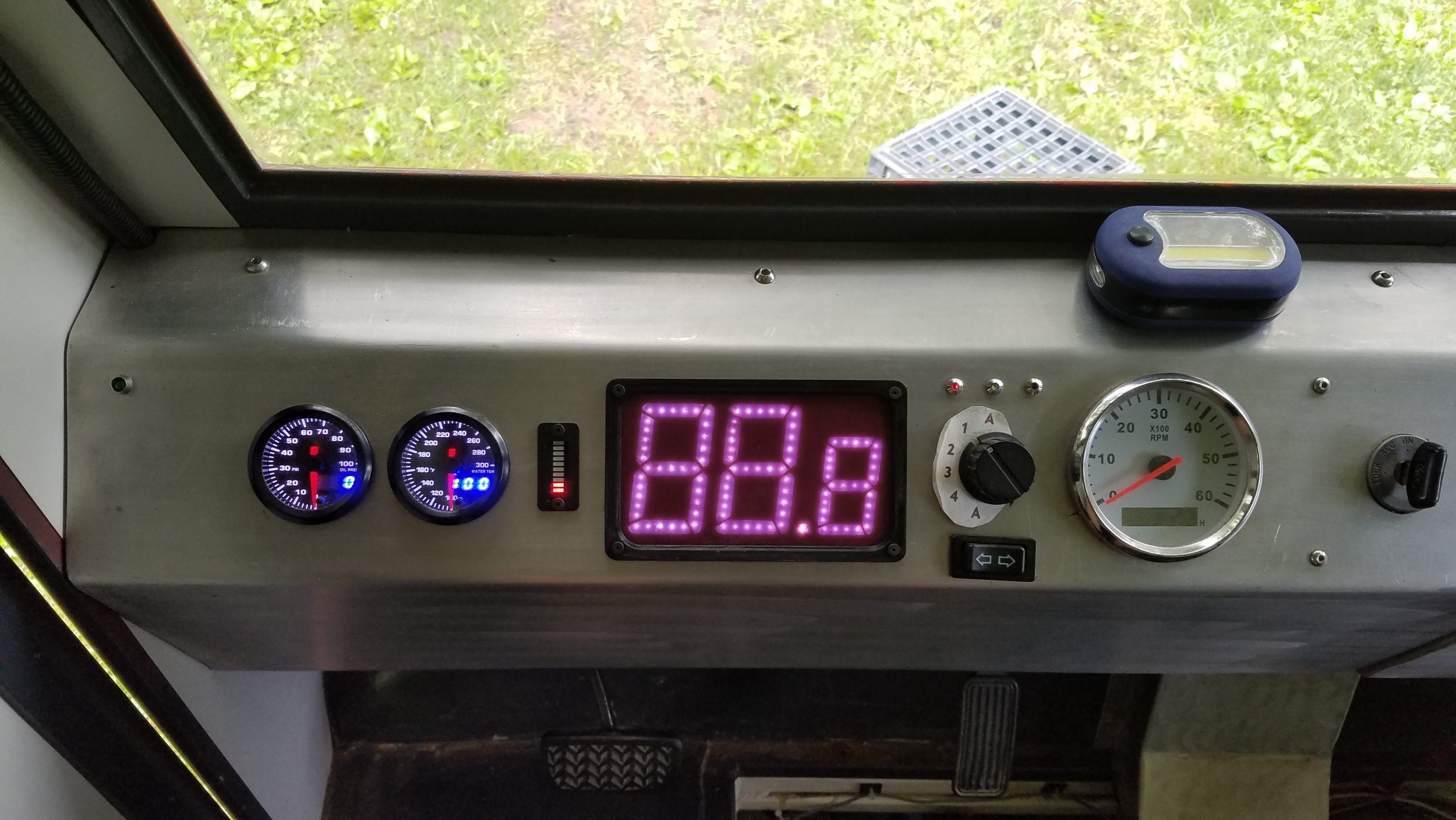

So lately, I have been working trying to finish up the dashboard. Here's a snapshot of it powered up but without the engine running. Everything works! Next up, I plan to update the steering master cylinders by adding vacuum boosters.

I need to get a vinyl label made up for the transmission gear over-ride knob to replace that temporary paper label.
