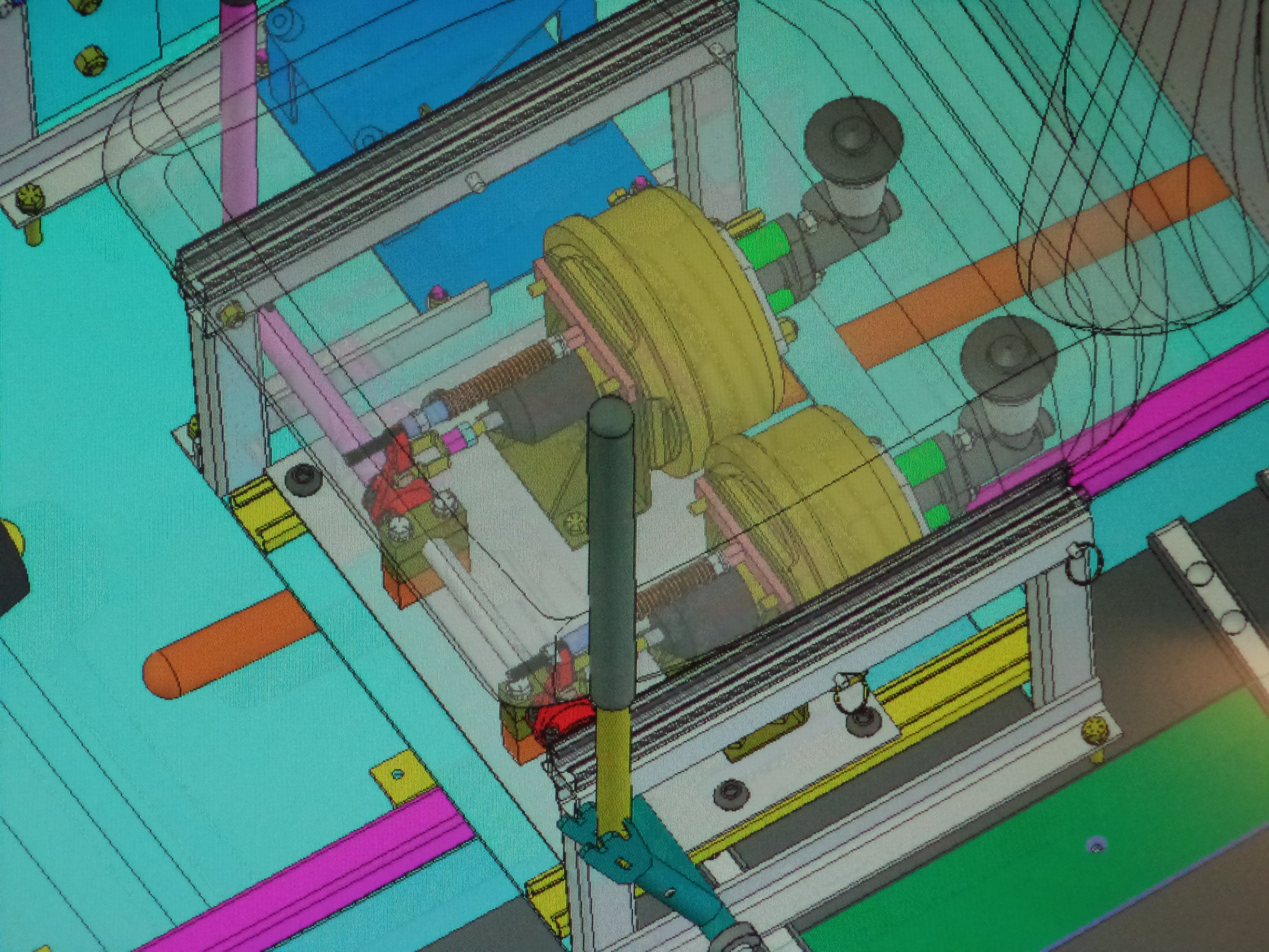

At this time, I have decided, at the suggestion of a fellow poster, to try and use vacuum brake boosters to increase the pressure of the brake fluid to the calipers. I have already ordered a 7" single diaphragm booster to evaluate for this purpose. I may revisit the HPU some time later or possibly use it to lift a snowblower? Stay tuned.

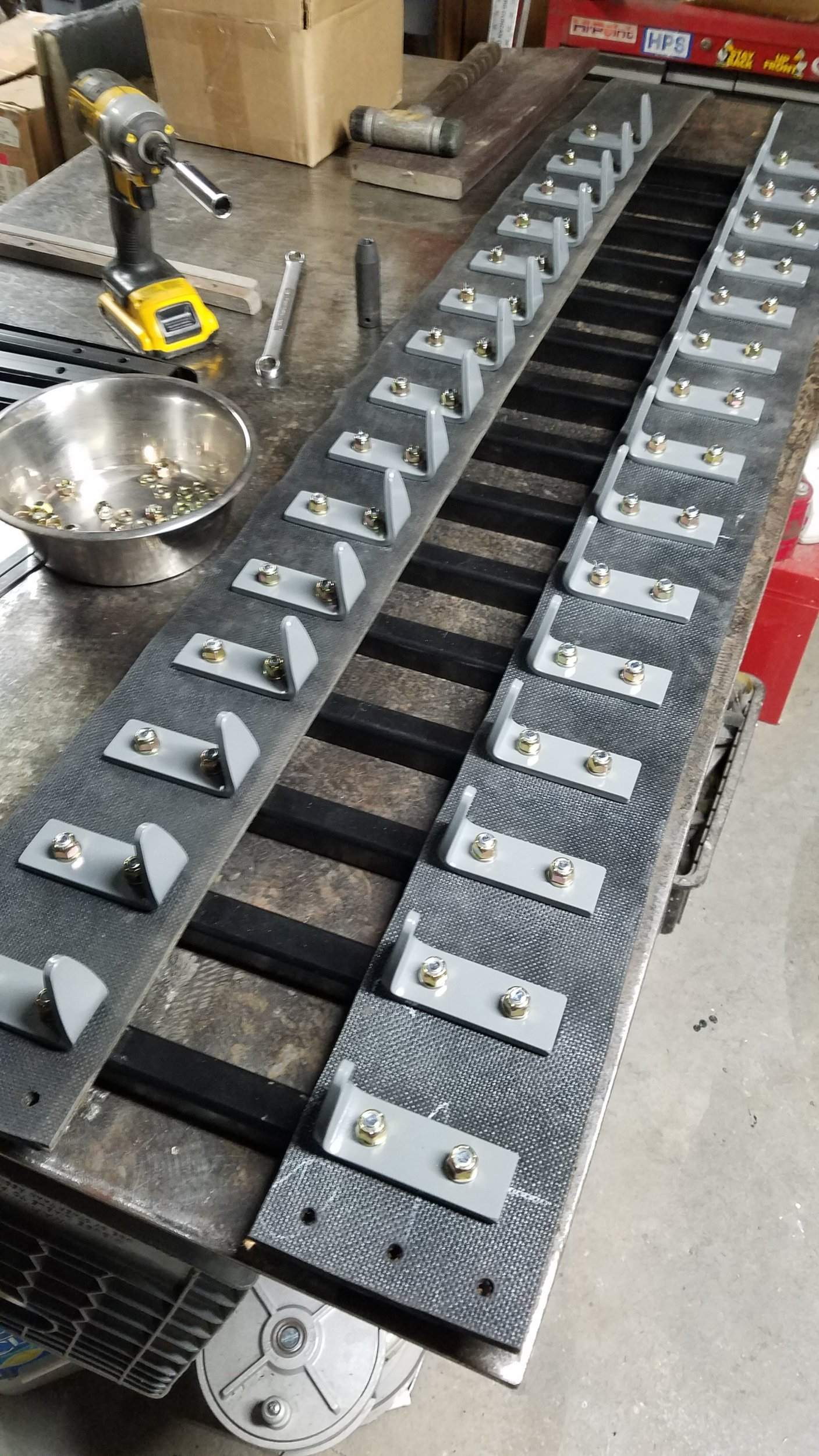

I had a flat the other day in the right front tire (#R1) on the sidewall. It looks like possibly a stick got lodged in between the sidewall and the track guide angles. I just installed a tire tube - we'll see how it holds up. If I have to, I'll fill the tires with foam. I also noticed a fair amount of rubbing-inspired wear on the sidewall which probably occured when I was making turns. Short of replacing the tires, I will try to reduce the friction between the tires and the track guides by applying some grease or dry moly-lube. I wonder if the increased rubbing friction made turning harder? Got any other ideas? I recently played with my cad system and laid out a design of a vacuum booster assist for my steering brake master cylinders. It appears to fit in there under the seat quite nicely. I think I'll try installing it sometime this summer.

I reinstalled the repaired flat tire after I sprayed the sidewalls with dry moly-lube. I also agree grease is not really a good idea. I'll spray the rest of the tires with the moly soon. FYI Fallon, the tracks are driven thru the front sprockets, not the wheels - they are all free-wheeling. Thanks for the feedback.

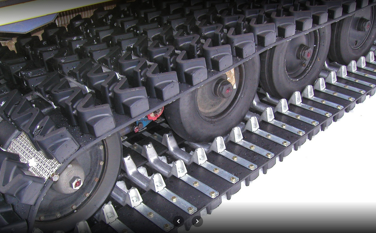

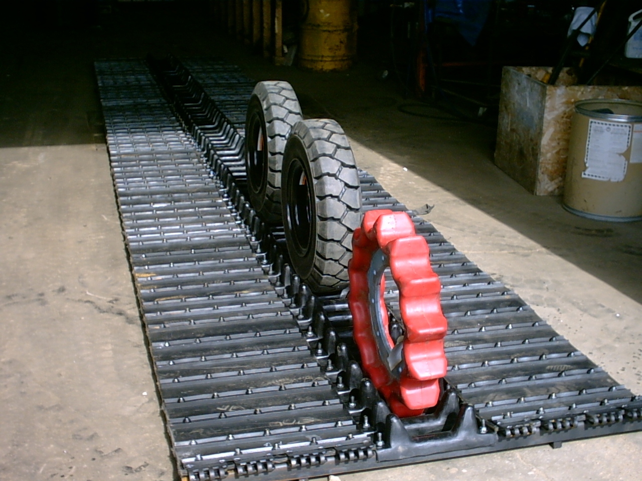

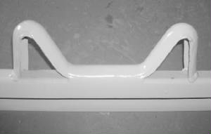

I'd say your tire guides are to square and would be hard on the side walls. The 2nd photo is what snowcat guide usually look like.
   / My Senior design project - a "Swamp Thing" tracked vehicle clone
#508
Arly - please explain why you think they may be too harsh on the sidewalls.
   / My Senior design project - a "Swamp Thing" tracked vehicle clone #509
Gary and I spoke today, so this is for everyone else. When snow machines turn, the side load stress on the tire guides goes through the roof. This is why operators hear the power plants growl when we make turns in a snow cat. Doing this puts lots of wear and tear into the idler sidewalls. This is why they do not use normal tires in snow cats but have high ply numbers and thick walled and very stiff ones. Plus the guides are very round shaped to lessen the idler damage. These photos might give you an ideals how they are built. :rolleyes:
