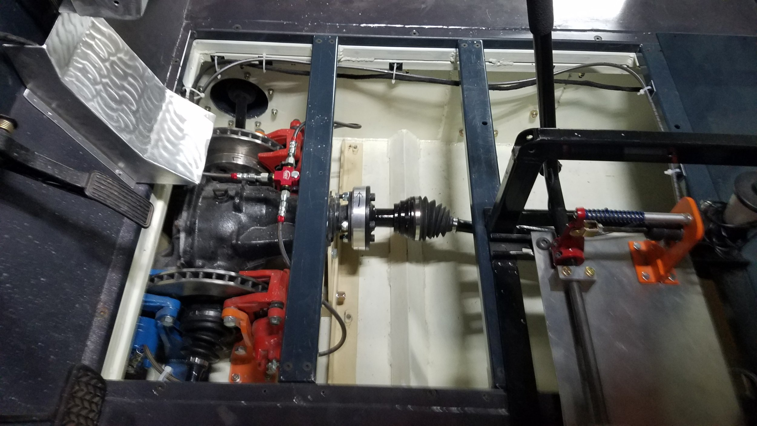

Not really - the rotors I use do not have the parking brake drum surfaces. The red calipers are the service brakes. Room down there is very limited with the CV joints on the drive axles. I decided early on to skip using a parking brake and rely on the park feature of the automatic transmission.

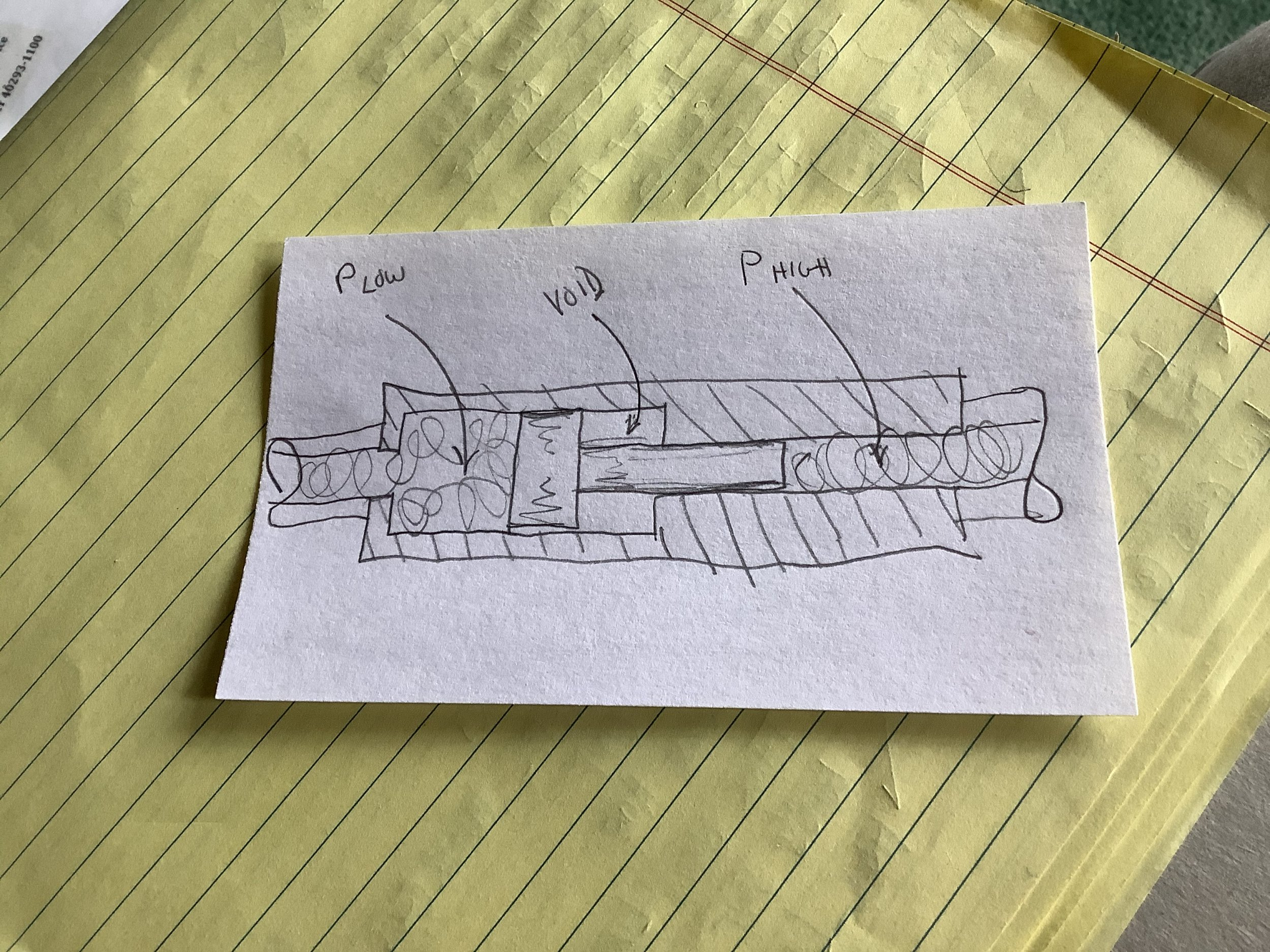

Forgot the nature of your brake problem but if it's from inadequate pressure, maybe a simple hydraulic intensifier would help. Instead of the pressure going directly to the caliper, it goes to a larger hydraulic cylinder to step up the pressure. (Sorry if you'd considered this.) C6F0BB6F-3AF6-4EED-8ECC-F3B531EA7D5C.jpeg

If the purpose is to showcase your skills as an engineer and your ability to configure electronics then by all means do it.
Myself personally I would look into utilizing a second caliper on the brake disc first.
Having a toy is fine but I want simplicity for reliability's sake when I would have the machine way out in the bush.
Those are my thoughts.
That along the lines of my first thought too. Given the quality of work on the machine so far I have no doubt you could accomplish it. But it seem pretty complex for a critical safety & operational system.
What's the PSI on a normal power steering pump? Could you just leverage something like that with a pretty well known reliability record & 2 manual valves? Leverage a brake booster & relatively standard braking system off a bigger truck?
How about you use both calipers for steering, and put a line lock in one of them for parking?
   / My Senior design project - a "Swamp Thing" tracked vehicle clone #499
I think there is a way with the right hydraulic components to let the steering use both calipers on one side and the service brake use all 4.
#500
I don't think there's enough volume in the current master cylinder (mc) to actuate two calipers. A larger mc with the vacuum booster may be an option. I don't plan to implement a parking brake.
