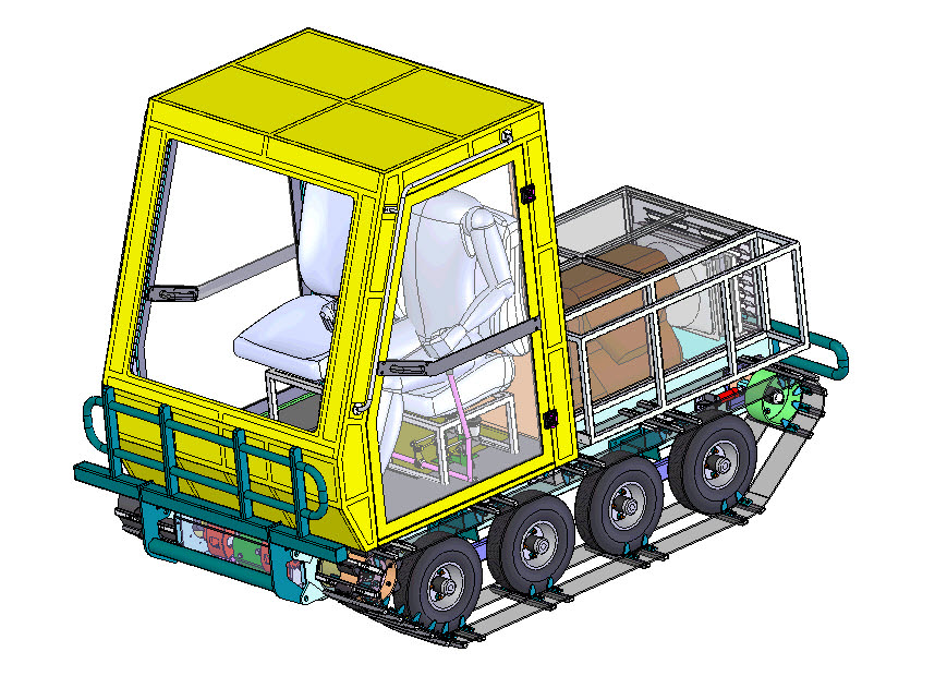

Well, the sidehilling anti-slide clips did not work very well so it's back to the old cad system for another design upgrade. Whatever I come up with will need to get a better grip on ice too. Stay tuned.
