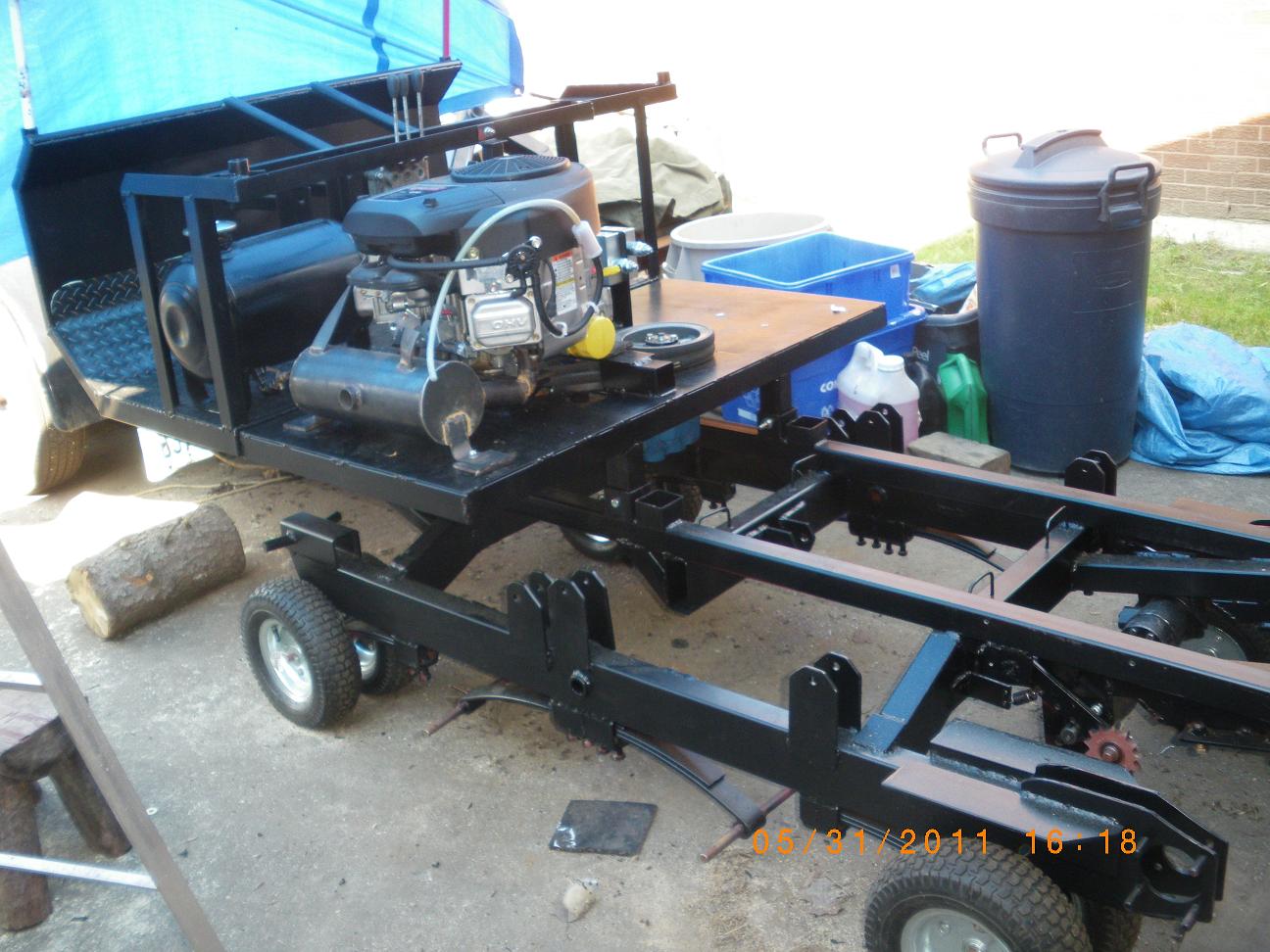

Motor and pump installed. Dump and plow spool, fuel tank positioned. Some diamond plate rubber mats glued down. Working under a tarp in 104F with humidex.

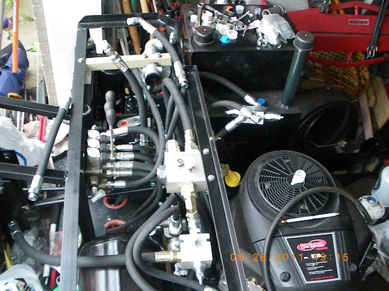

Welcome to my nightmare. Really hoping to get this thing running this weekend. Dropped another 1,500 in hydraulics in the past week. Nothing fits, too many adapters. At least 100 places it could leak. Everything I built mounts for has to be moved because the hoses are not flexible enough for the close quarters. Some things need ORB 10, ORB 8, ORB 6 and ORB 16. Others need 3/4 NPT, 1/2 NPT and 1 1\4 NPT.
Good grief!! I wonder if the space shuttle has that many hoses and levers. Good luck working it out.

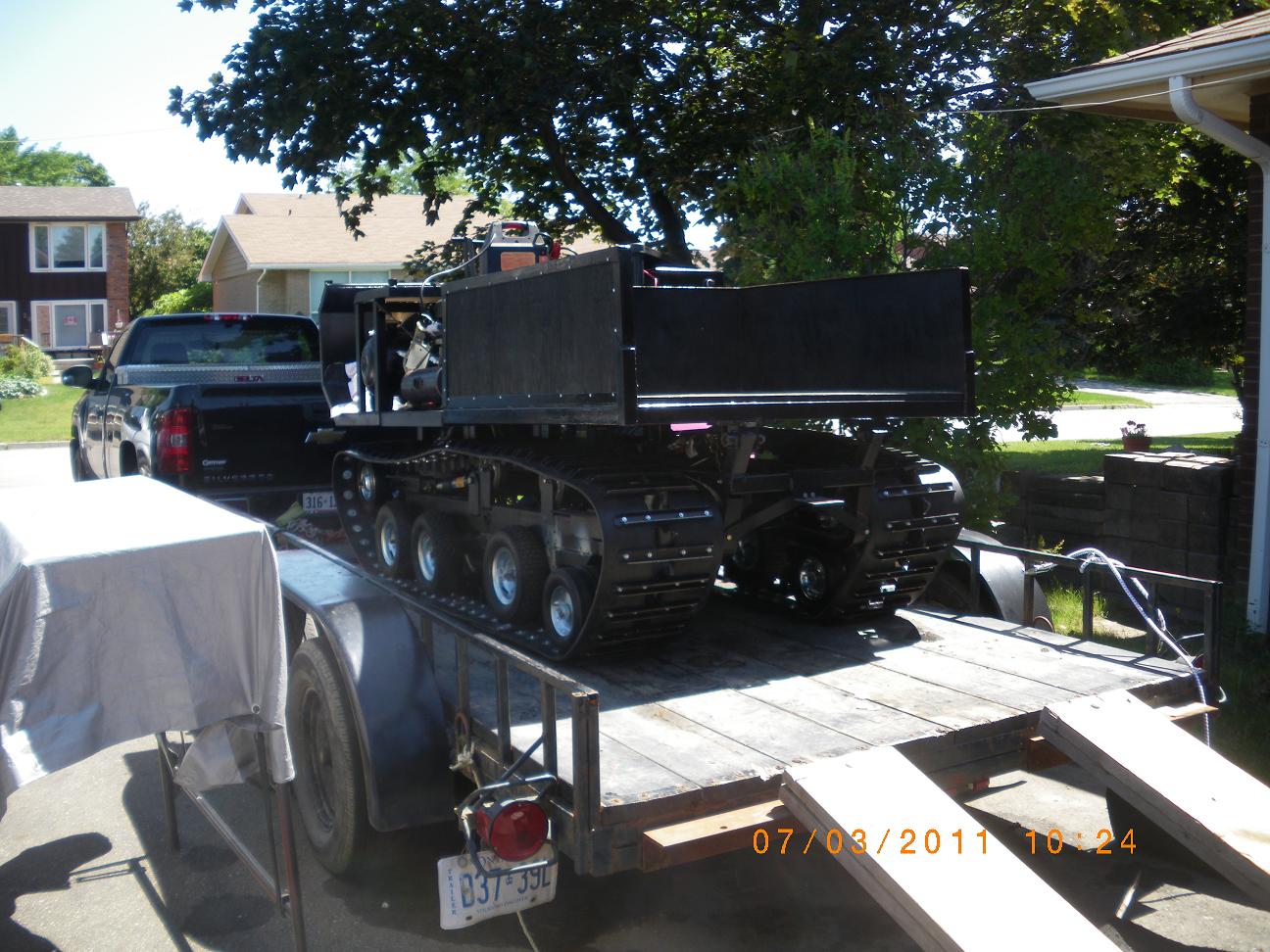

Well I got it together and sort of working. I am in vacation mode and will not be able to investigate, modify for another month. The status is, I need proper 5L belts, substituted 4L but the narrower belts don't grip. Thus belt slipage at 1500 PSI. Temp solved with tightening tensioner. Unable to build more then 1500 PSI, so has trouble turning in dirt. OK on hard surface but paved driveway protested. I have a few Pressure relief vavles to adjust, all supposedly set at 2000 PSI at factory but appears to be 1500.
I may have to change reduction chain drive to 3:1 from 2:1. All the discussion about teflon paste vs teflon tape. From now on its tape all the way and I have been repairing leaky paste connections with teflon tape. Also tape will always let you do one more full turn to correctly clock a connection. Better yet try and avoid NPT fitted componets. ORB ones are not leaking. Anyway it looks sweet sitting on its trailer.

Very cool, and NPT fittings of any kind are evil in my book. Give me ORFS, ORB, or JIC any day. Heck, I'd rather use BSPP before NPT.
