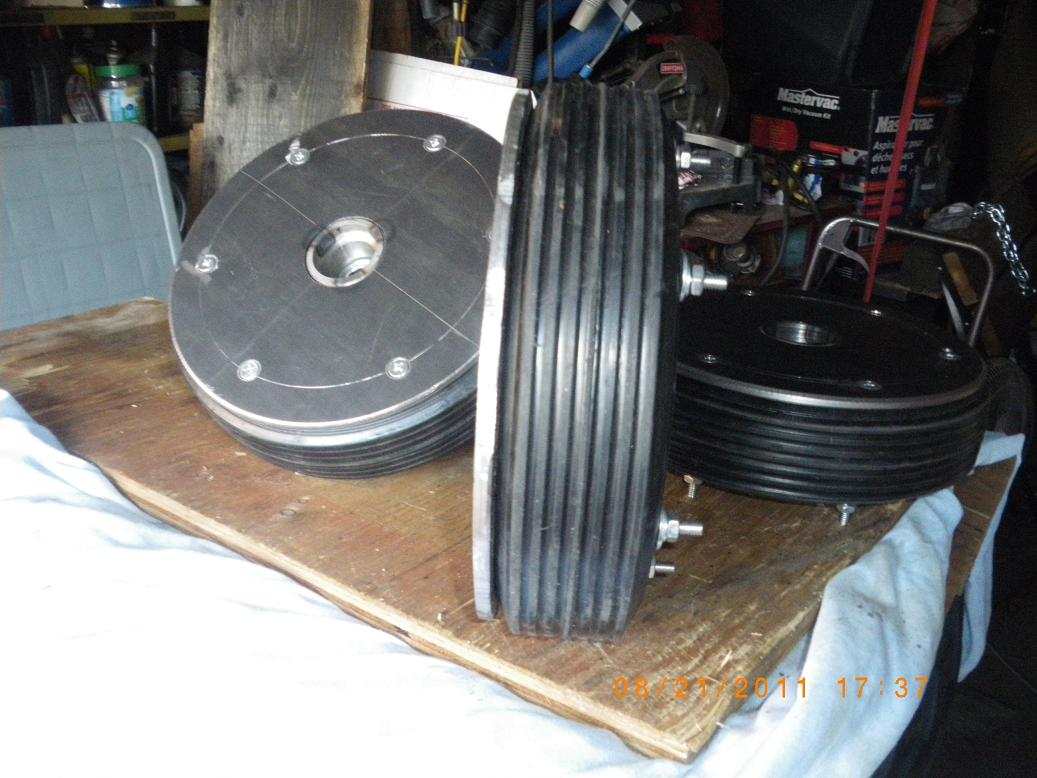

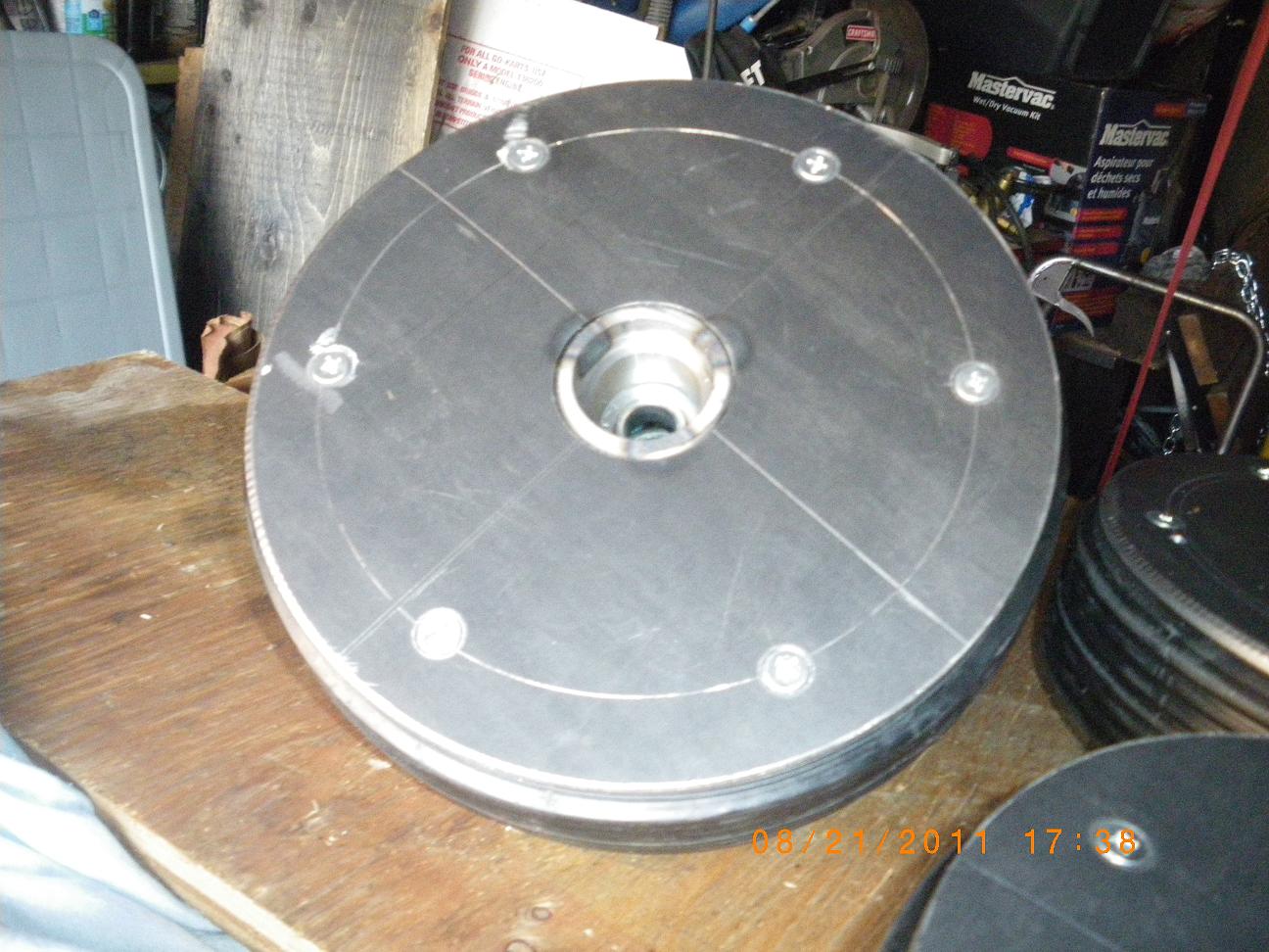

Finally get to go up and work on my tracked dumper Thursday. Going armed with some exhaust gasket material (no gaskets currently on muffler), two 5L belts, and four modified wheels to position the track. As well I have to reverse one control, adjust the pressure reliefs to 2000 PSI. Place some magnets on the oil tanks. One of the first things that happened was a breather cover has a metal bracket that locks it to the breather port. The nut on the bracket worked loose and must be in the tank. I have a telescoping magnet tool so hopefully I can fish it out. Next time I will use a strainer in the suction port.
If these new wheels work out, I will be making four more for the front. Basically I cut four 10' dia discs out of 1/4 plate. Machined a hub to hold a bearing and bolted it to a solid rubber wheel.

I spent some more time on the tracked dumper. Added a couple more steel \solid rubber wheels. Tapped all the axle shafts for 5/8 nuts instead of cotter pins which helps to keep the bearings in the wheels. I bent all 240 track guides in slightly to keep the steel wheels from riding up. I need to make some solid steel wheels for the front axles as there is just too much weight with the cab and blade on. I have also changed the gearing from 2:1 to 2.7:1. Here is a short video.
