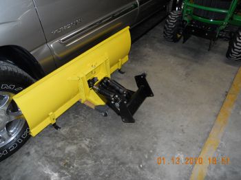

The bracket is to mount the quick hitch front end they make for the 2305. Then that can be used for the plow, snowblower or sweeper..
Yeah Luckly the 2305 doesn't stand as tall as yours, so the brack will almost be the perfect hieght..

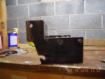

A pic of the hitch during fabrication, and with primer paint.

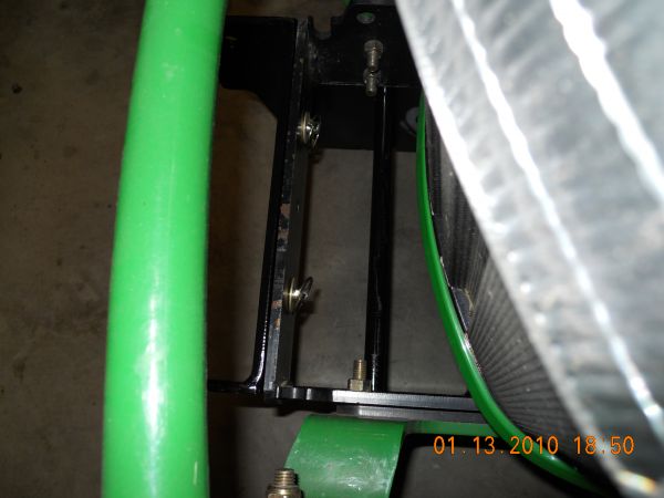

So for those of you don't know how this works here goes.. First you slide the round bar into the slot. The part that's milled down to 13/16..
Front shot, with the bar in the slot..
Side shot with the bar in the slot..

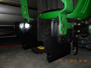

Then you slide the front up and let the pins go into the the holes on both sides. Don't mind the ugly welds!!
/ My plow mount thread...
#30

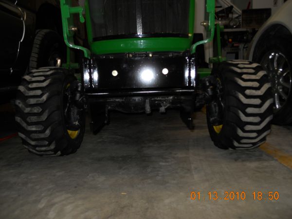

Fits like a glove, locks in place awesome. Really happy with how it locks and fits. I am not happy with how I didn't take the time to line it up right (square).. Now will have to shim things when welding the plow mount and the hydraulics arm..
In the front shot you can see i am about 3/8 inch off on the bottom cross bar, not sure how i managed to do this.
Front shot..
Heres's a side shot..

If your not happy with the squareness, grind your welds and redo.

Looking good. Pics are a bit blurry, out-of focus....maybe phone camera?
Myself, I wouldn't trust the spring-loaded pins to hold the hitch in place.
And for the crook built in, I'd sugest taking the time now to blow the welds off and re-weld them straight.
You will enjoy your hitch much, much better in the long run. :)

Yeah I am thinking about breaking out the grinder, but not sure yet.. Its not going to mess anything up, just looks crooked.. As for the pictures some are off the camera phone others arn't.
John deere uses those spring load pins in their setup, so figured they'd work for me..

Looking real nice. i re read twice, i didn't see where ya said how wide your blade is.
#39
Sorry Forgot to post that, its just shy of 7 foot... 6'10"
