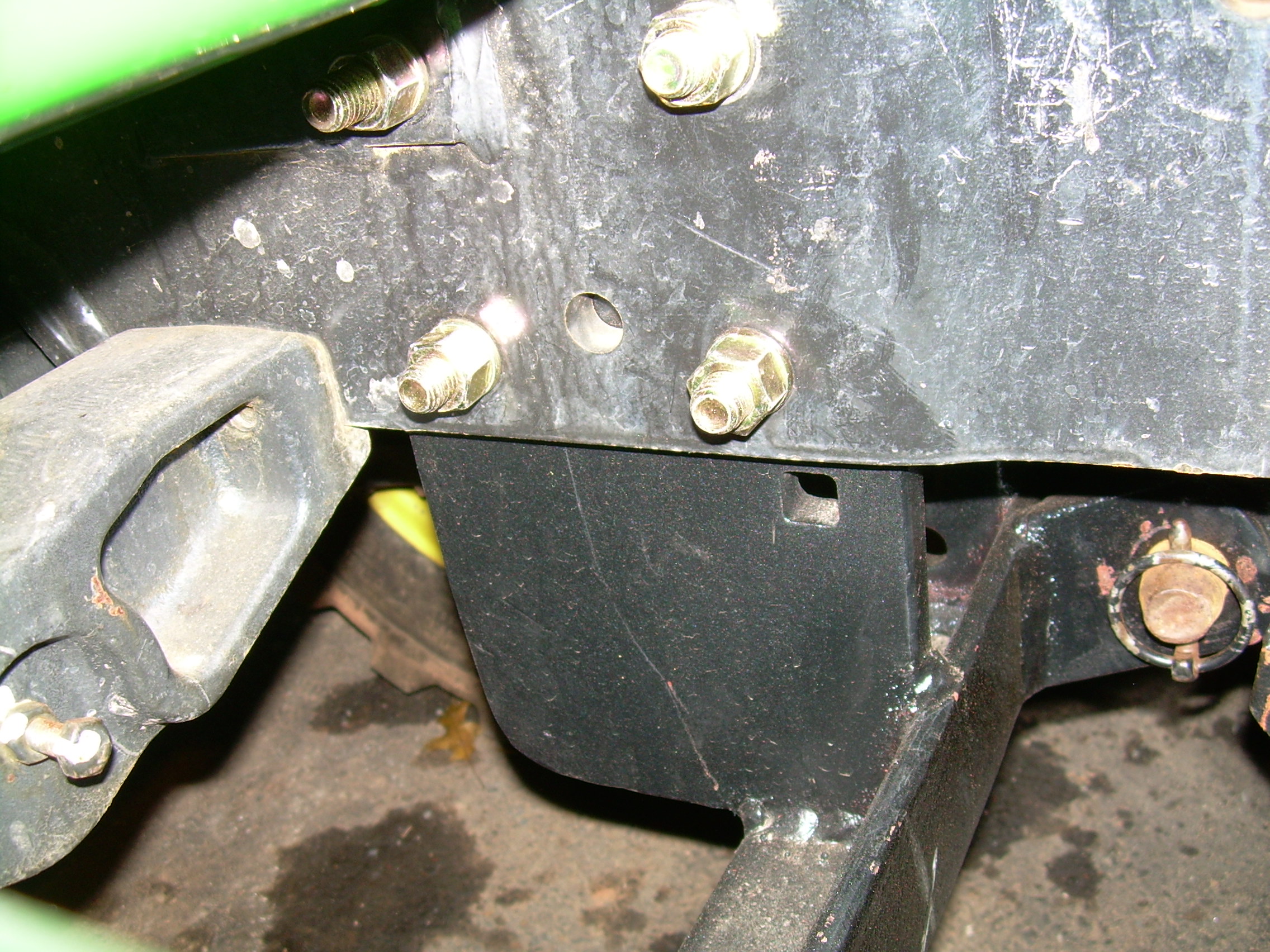

Here is the bracket that mount to the frame and under the brush gaurd.
Its about 3/8" thick plate, bolt with the same four bolts as for the brush gaurd. It will be the only thing thats left on the tractor, the rest will mount all of it..

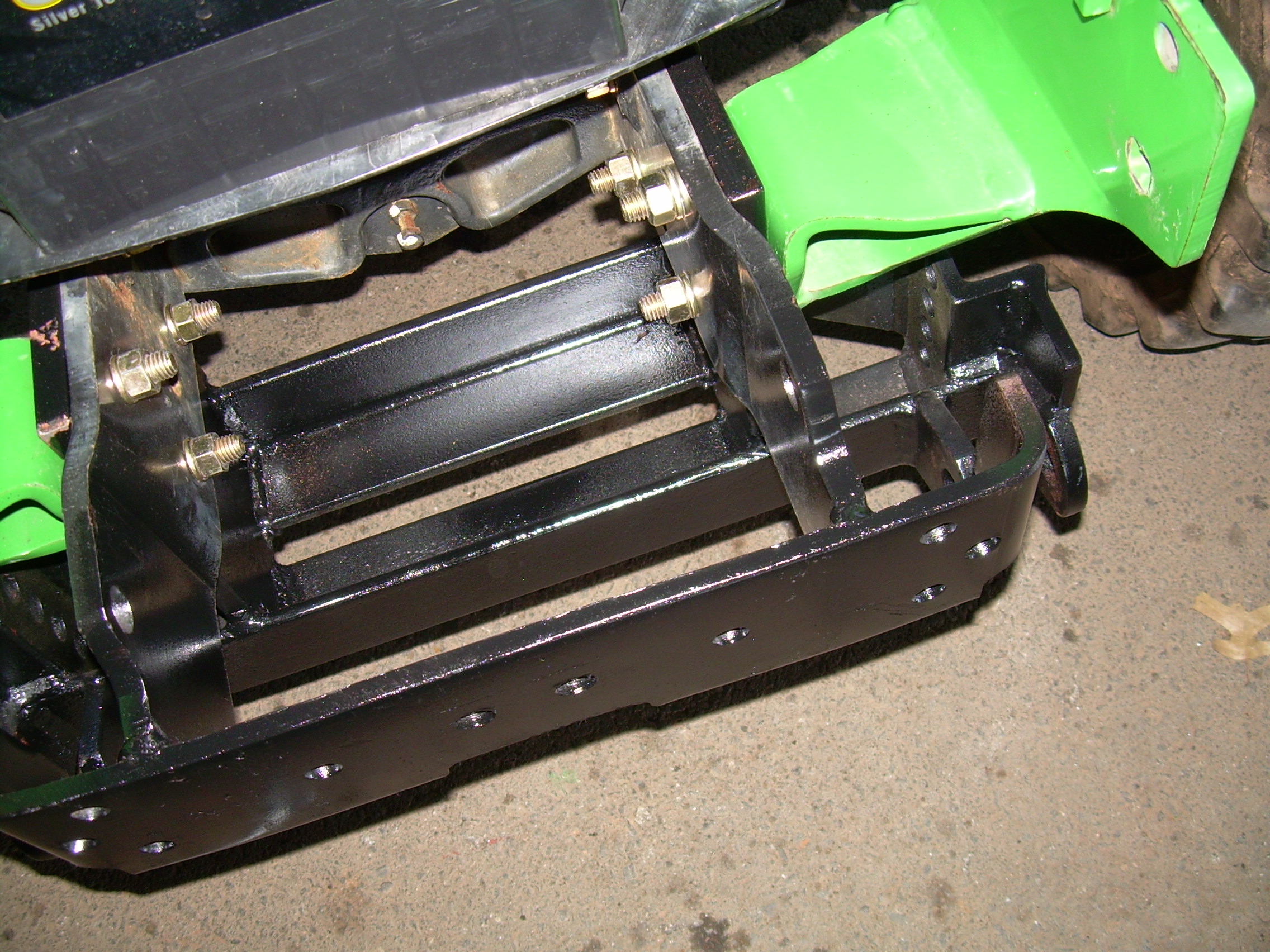

HI JD2305CD. New member here. Been looking for a long time, but your thread really caught my attention and I decided to go ahead and join.
I am working a very similar project right now. The only difference is I am adapting an older 54"JD Plow to my 2305 and I wanted to use the quick-attach method also. I made several models from plywood and when I finally had what looked and fitted right, I took it a friend's fab shop and he made a CAD drawing and loaded into their plasma cutter. So far, everything fits like it should and the bracket is at the powder coater. I am having new hoses made and with a little luck it will work like it is supposed to on the first try. One big thing you will find as you progress with this, the holes in the JD frame brackets are 13/16. This is NOT a standard size around here, so I had to buy a whole stick, 20' to get 32", still cheaper than buying the pins from JD.
More pics later as this project progresses.

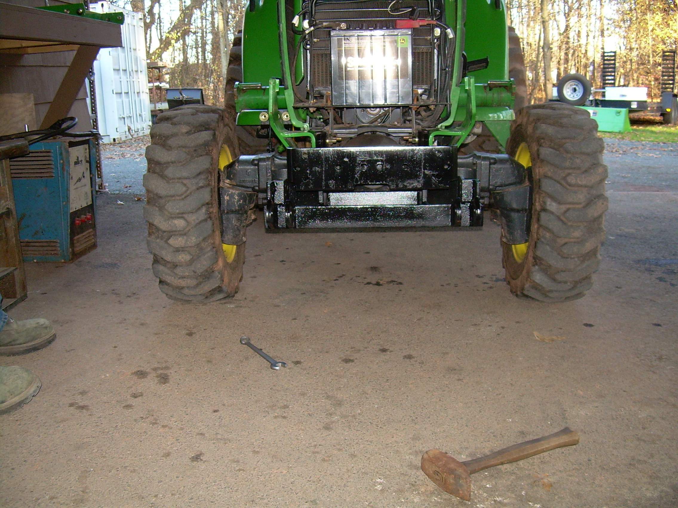

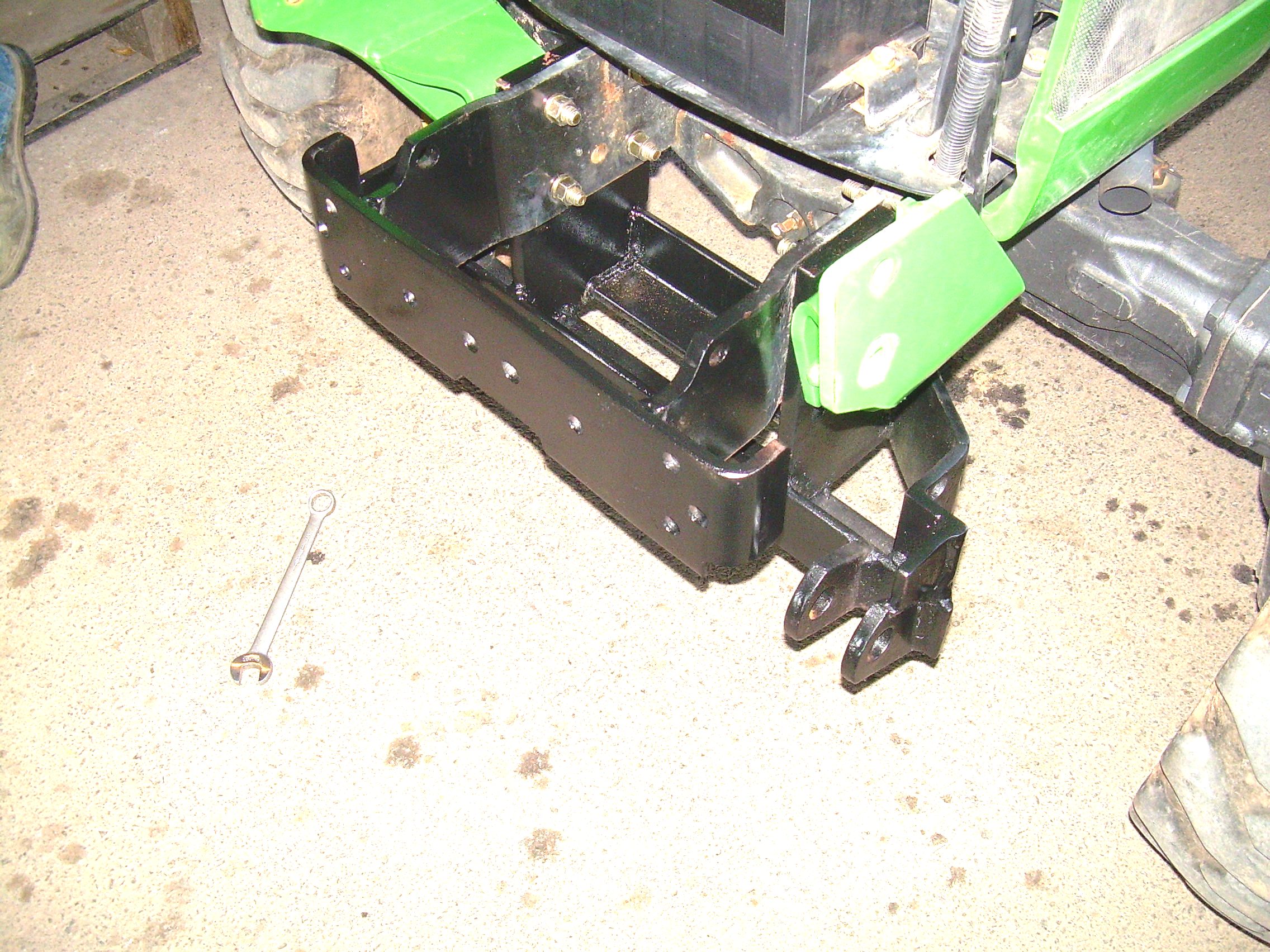

Picked up the bracket from the powder coater today. Here it is installed on the tractor. Only thing I am waiting on now is the hoses. I had to order the 45 degree fittings, but hopefully they will be in by Friday and I can get the plow up and running this weekend.

/ My plow mount thread... #18
Looks very nice!! Is that how Deere does it? I think they may have some pusher arms that go to the center or the rear of the frame for strength, I dunno. Something to consider.

Looks great RR, makes me think a lil.. Your fits on the inside of the brackets, I was going to put mine on the outside.
Makes sense to to it that way though, because it rests against the front frame, mine wasn't going to. I was going to run a support there, but i think its better to have the "L" shape line right onto the frame. Glad you decided to post!!!!
/ My plow mount thread... #20
I actually looked at the correct blade for my tractor and after they picked me up from the floor when they told me the price, $1800, I figured there had to be a better way......so, I took a bunch of pictures of the correct blade and quick hitch and tried to model mine as close to what the factory designed. With only one exception, my bracket hooks up exactly like the factory quick hitch. It slides inside the factory brackets like the factory, but instead of being tied together with the quick hitch, mine extends up the front of the bumper and has two 9/16 holes in it to line up with the holes in the bumper. I made pins for those holes also, so basically there are three pins that must be installed to attach the bracket. No tools required. I will end up with only about $400 in the entire project. The only four things I had to pay for was the blade I found on evil bay pretty close to home, JD brackets for the 2305, some fittings, and of course a 20' stick of 13/16 rod. It is really nice to have friends that owe favors and own powder coating, steel fab, or hydraulic shops. Even without the favors, I would have still only had $600 or so in it.
