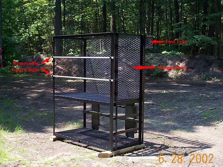

Just and update, I started painting the lift today. I will hopefully be done with the primer coat by tonight. Both the wife and I were getting sick of me being out in the garage working on this project. I am very pleased with the results and appreciate everybody's input. I am ending up with a much better personnel lift because of all your suggestions. I will post some pictures after the painting is done.
   / My Personnel Lift Project
#58
IT'S DONE!!!
Finally the personnel lift is totally complete.
Thanks to advice from MarkV, RadMan and Ed King I came up with two removable guard rails for the front instead of welding on expanded metal there. I hope the top one will work for a lanyard point of attachment for a safety harness like Wroughtn_Harv suggested.
I added a door mounted on hinges that can easily be swung out of the way towards the back of the lift or can be lifted right off the hinges.
The back and the side without the door both have expanded metal welded on them.
Although I was always planning on a tool tray I might not have spent the time at the end of the project without the encouragement of Jim Gerken and RadMan.

Wish I had seen this post from the start!! Nice job spencer. A lot easier when you have the right tools!! Do you have an estimate of how much the whole thing weighs?

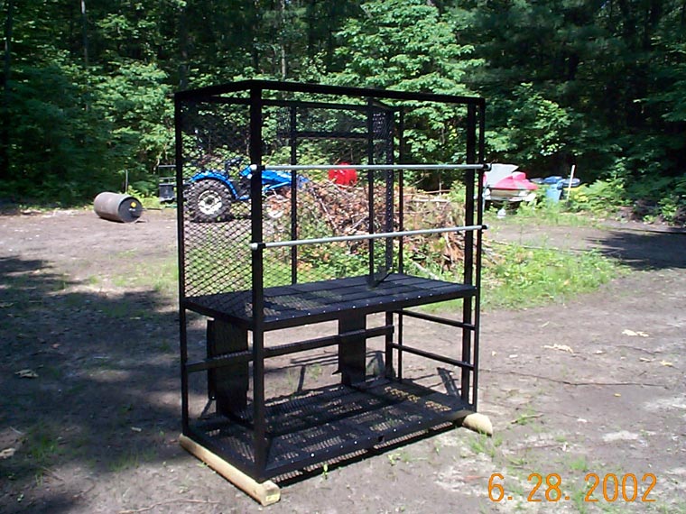

Unfornately I don't have any scrap metal around like a lot of other folks on this board so I had to buy all this metal from the local metal shop. On their invoices they do show how much each piece of metal I bought weighs. Now adjusting for scrap and other pieces that I did not use and adding in the Bobcat quick-tach plate I would estimate that there is about 300 pounds of steel there.
Here is another view.
