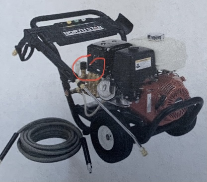

Rotate the black knob, circled, on your machine to lower the pressure out put.
Hold wand trigger open with left hand and pull starter rope with right hand.
After starting rotate black knob to desired pressure.
My washer has same engine.
This how I start it.
Good luck.
Not all pressure washers using the GX390 are necessarily built with the pressure release that yours has.
