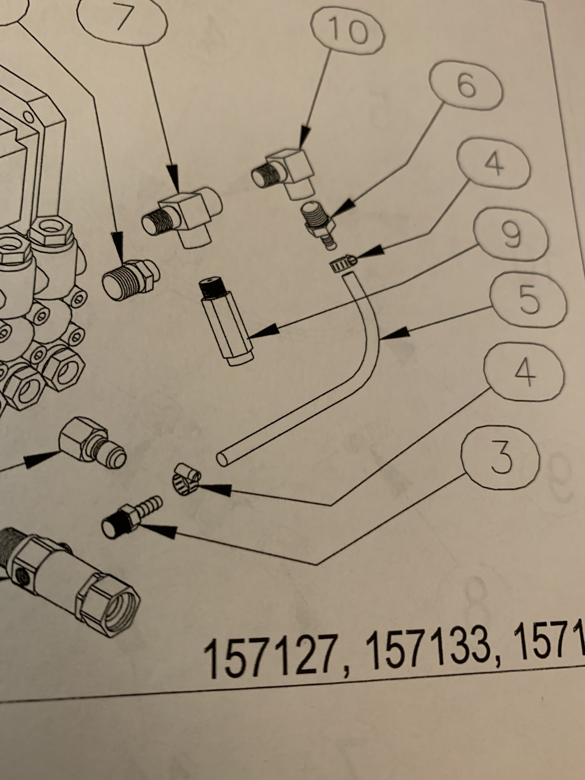

Number 9 in the diagram is called a pop off. There is the threaded end and the closed end. Seems if I removed it, or took the end off that would release ANY residual pressure. The closed end has an inserted cap with a hex head. I just don't want any springs or Jesus clips flying round and getting lost

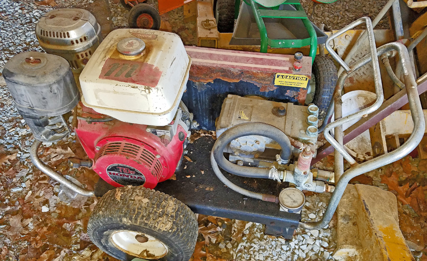

You can see my GX390 powered washer in the background,,
I also have another GX390 powered one that is belt drive,,
That one was used for close to 10 years by me, before I got the one in the pic.
So, both of mine were acquired used.
I think the belt drive one will still work, I got it out 2 years ago, and started the engine.
The belt drive one had the same issue,
sometimes I had to start it with the water turned off,,, :unsure:
The GX390 is a beast,, I agree it should only be sold with an electric start.
Maybe it is not offered with electric start,, because that hard start that is encountered sometimes would probably rip the teeth out of the starter or flywheel?? o_O
I found a pic of the belt drive one,, it is ` O ` L ` D ` !!

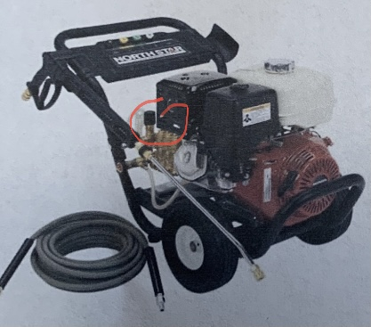

Rotate the black knob, circled, on your machine to lower the pressure out put.
Hold wand trigger open with left hand and pull starter rope with right hand.
After starting rotate black knob to desired pressure.
My washer has same engine.
This how I start it.
Good luck.
