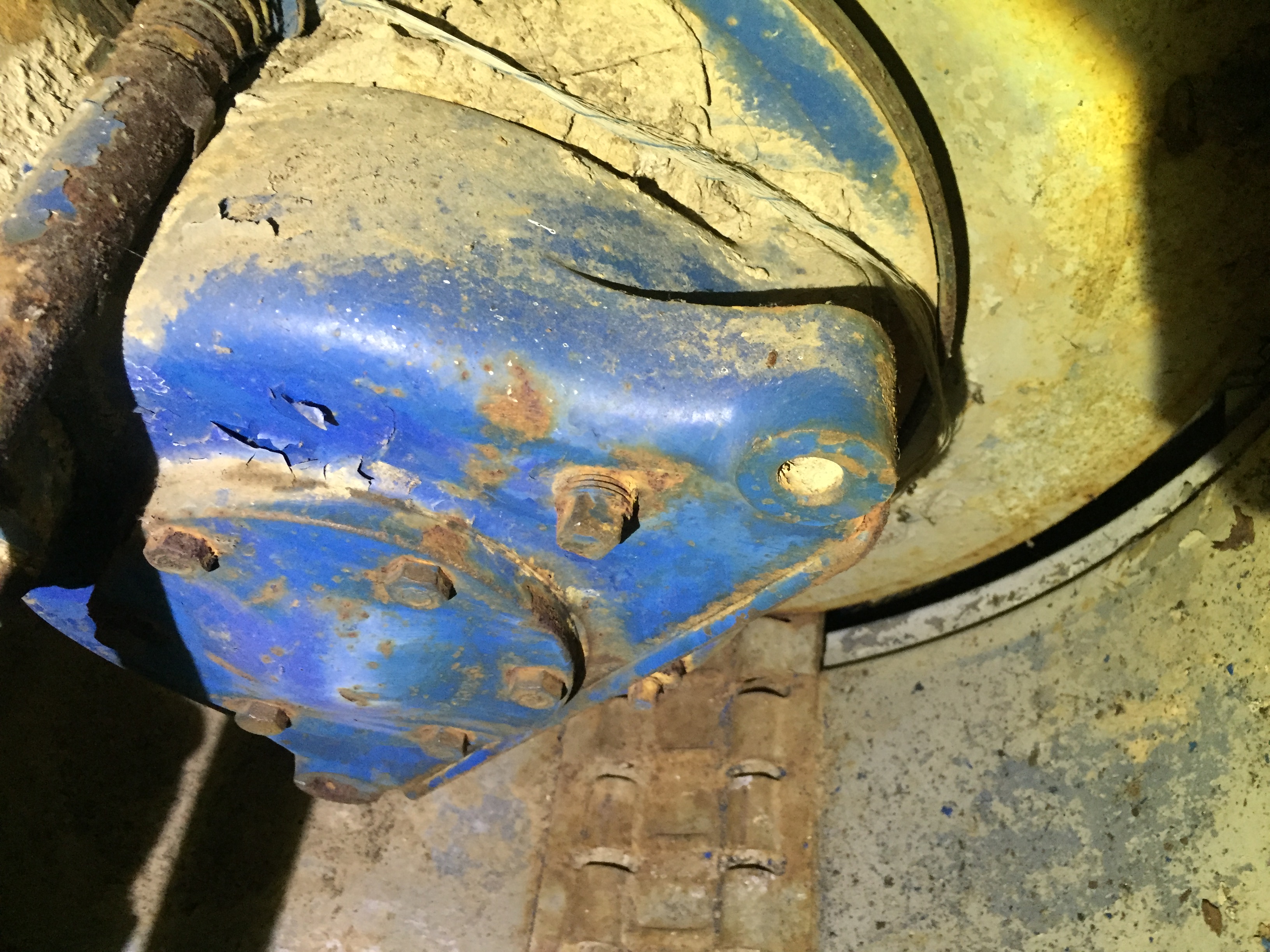

Soundguy,
You reference drop boxes, I have been searching the web and on the tractor, and have come to the conclusion that you were referring to the final drives on each side. I have tracked down that each take 1.5 qts of fluid, will the Universal Hydraulic/Transmission Fluid that I used in the differential be fine for these?
I assume in my pic that I've attached that the square plug is the inspection plug? Thanks for all the help.
Kurt
   / My new Ford 4000 #76
I don't see a pic attached. but the final drives have a drain and a fill.

#77
   / My new Ford 4000 #78
fill thru the big sq plug till it starts to overfill and dribble out while you are filling.
the small square plug on the pan is the drain.

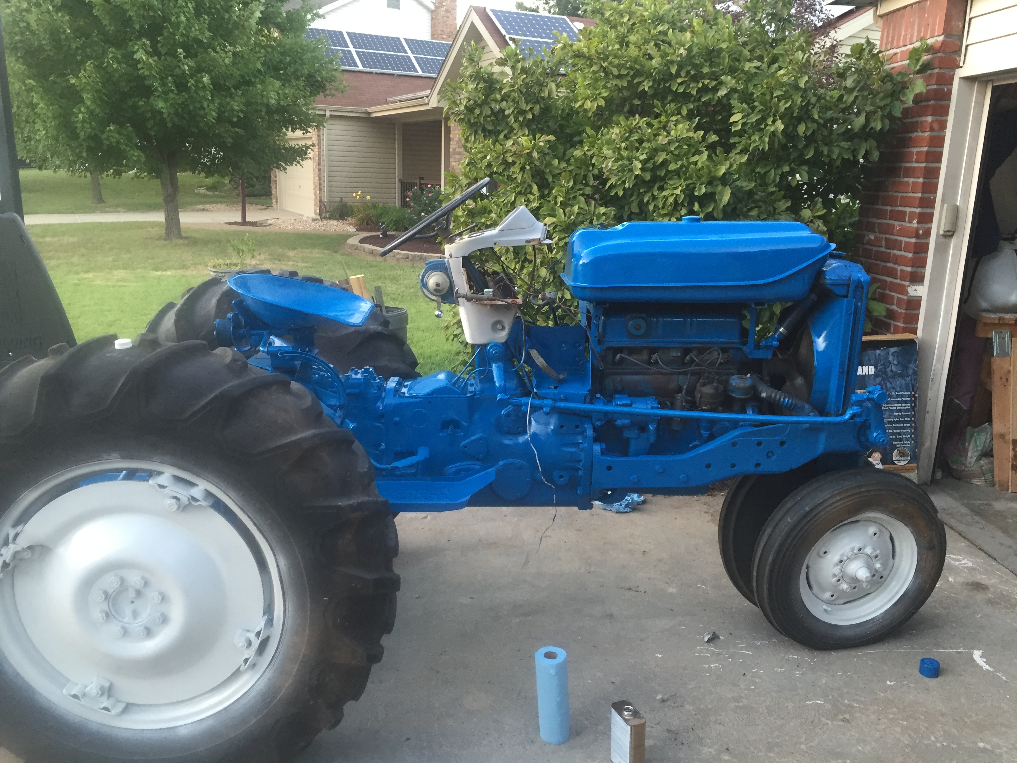

#80
Finishing up some paint, and minor details. Have to troubleshoot the generator light, hard to tell which terminal is which on this old genny. Need to get the as much oil out of the steering gear box and add some lube in there to keep the gears lubricated. But just about ready to roll.
