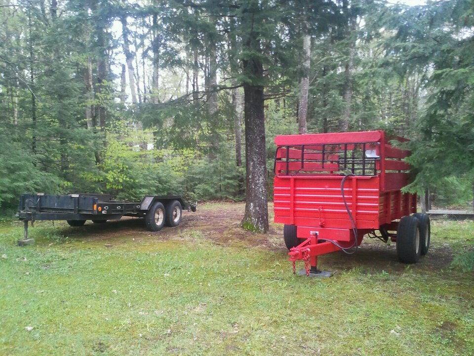

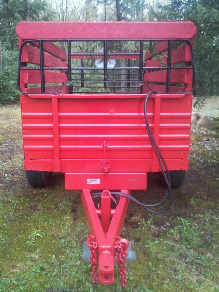

I found out that a loose thrown cord of wood is 195 cu.ft and my trailer wasn't big enough so I built the side up higher to 200cu.ft 195cu.ft for 24" wood, 180cu.ft for anything down to 16"

I just purchased Haldex 12 Volt DC Power Unit — Manual Operation, Double Acting, Model# 1510038 | Hydraulic Power Units | Northern Tool + Equipment and Haldex Reservoir — 2 Gallon, Model# 2280045 | Tanks + Reservoirs | Northern Tool + Equipment so that with a battery I won't need my tractor to dump it. Figure on making a few local deliveries and I will just mount them on a platform and slide it into the back of my truck rather than mount it to the trailer. My trailer hoses are long enough to easily reach as it is allready set up to run off my remotes on my tractor. This will allow me to use the hydraulic power pack on other cool things like a home made bearing press or a small lift for my lawn tractor.
