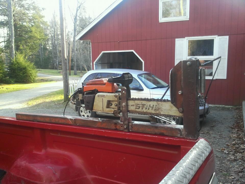

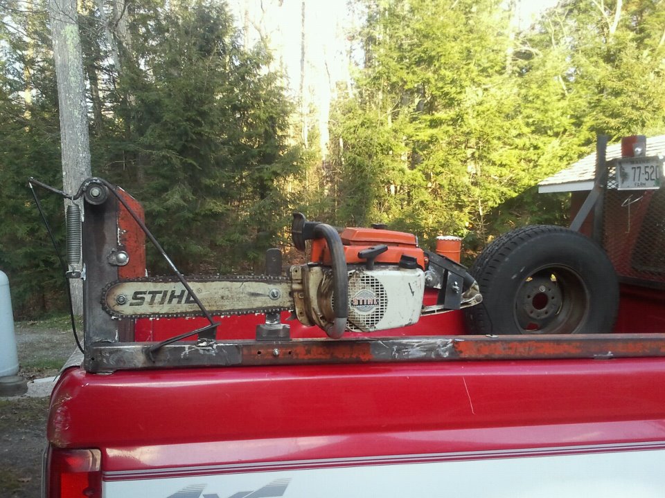

I burn 20 cord a year and put up a tad more myself. I have some pretty good equipment but you (OP) have me beat big time.
Here is something I built this winter using a video I saw on youtube as an example. I call it a limb processor. I haven't "fine tuned" it yet as I haven't started cutting wood yet, letting the snow melt off my roads and giving things a chance to dry out some.I hadn't yet threw any paint at it when I took these pics but I assure you it's all painted red now.take a look-
That's neat and a great idea :thumbsup: although it gives me the willies looking at it. :eek:

I've run about the same thing here for 14 years with an old skillsaw, upside down, with the guard pinned back. I oogled the chainsaw setup on youtube months ago and put it on the list of things to build =) No need to touch the branches twice.

Very, VERY cool....I like it...just don't fall on it!
Maybe a fixed horizontal above it? Nah...........live dangerously! :D

If I make it idiot proof and get hurt, my IQ drops beyond repair. If I live dangerously and nothing happens I look like a hero :)

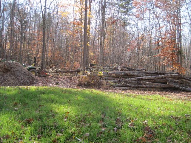

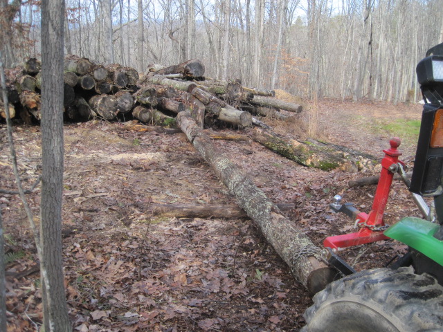

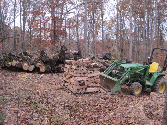

OP, I'd love to have your wood processor for just 2 days. I have eighty 20' long logs I need to cut, split and stack. I will have to spend every spare weekend I have for the next year cutting up this pile.
Congrats on your setup. You can bet that if I burned 20 cords a year, I'd have a wood processor too.

You are definitely on the right track with this setup, the cut limbs will fall into the bed and a bit of poking from the rear with a long stick will make room for more. What you want to stay away from is having anything on the ground near the saw that you can slip or trip on. I used to have that skillsaw mounted on an old sawhorse and the pile behind and around it would become fairly large, yet I still remember pops doing the wet floor skid on a cut limb once, thought he was going to grab that blade for a moment. I never let the pile get too big before moving the setup after that.
The one far superior advantage in safety with the chainsaw setup is that the chain isn't spinning until you set the limb down and push the lever, vs running at full speed constantly.
