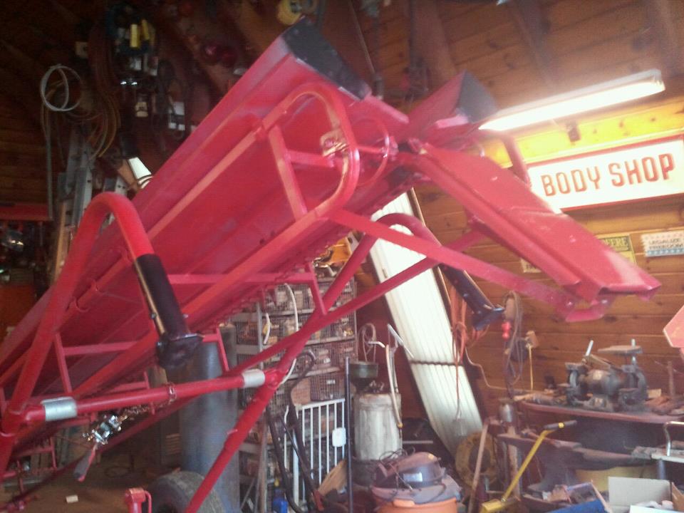

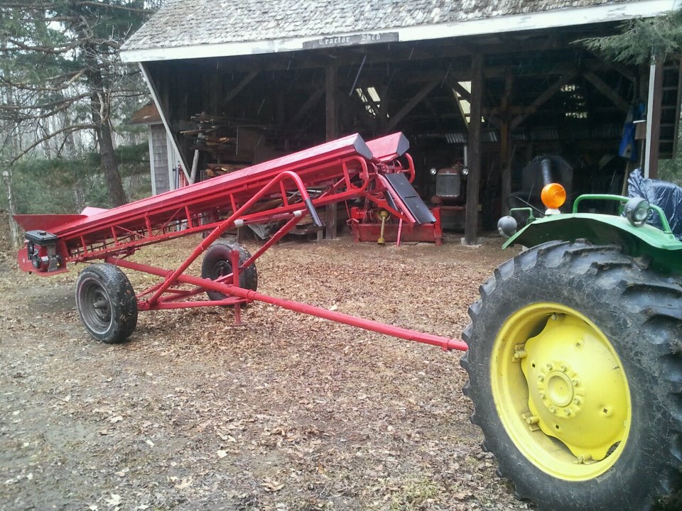

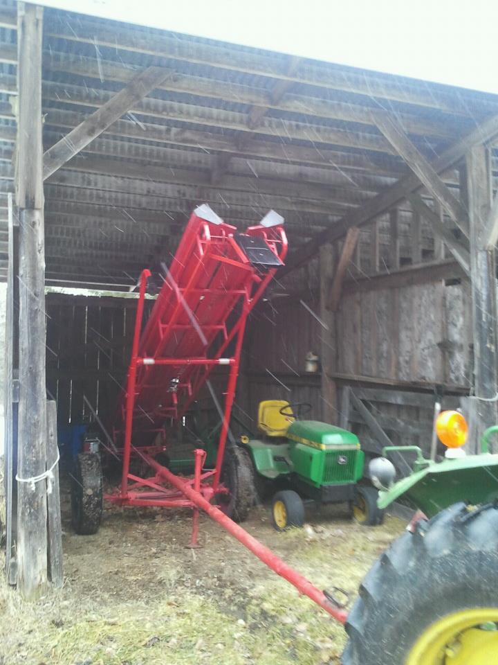

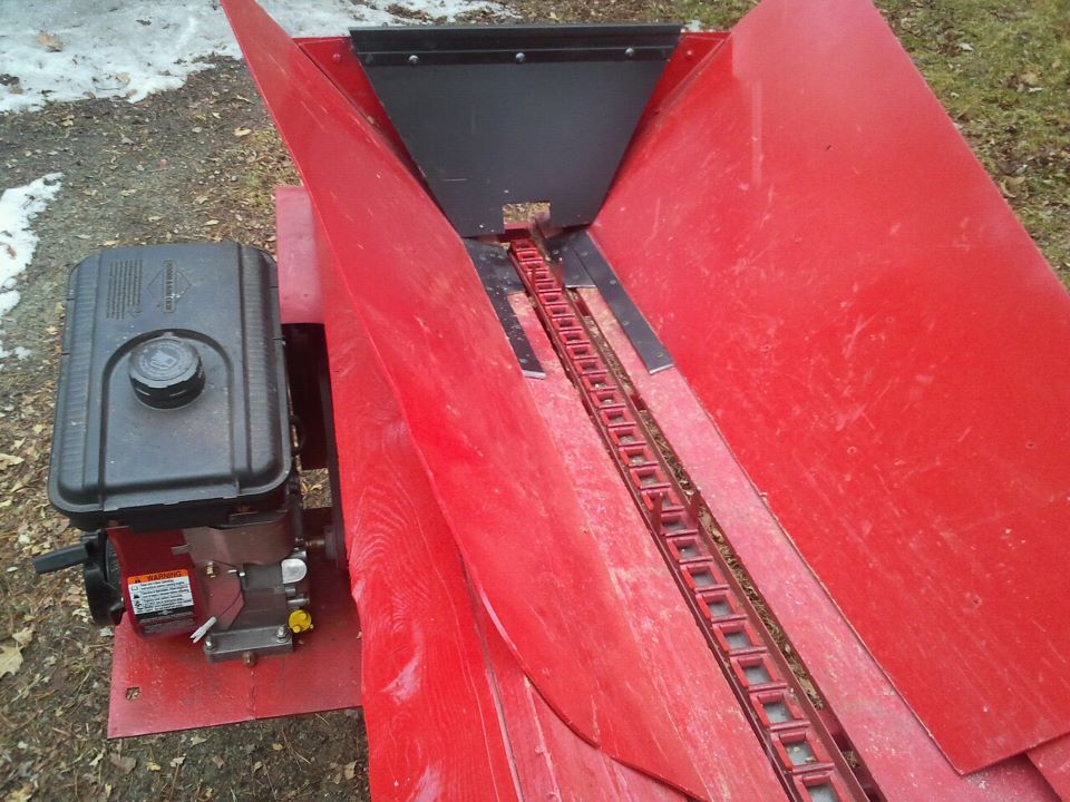

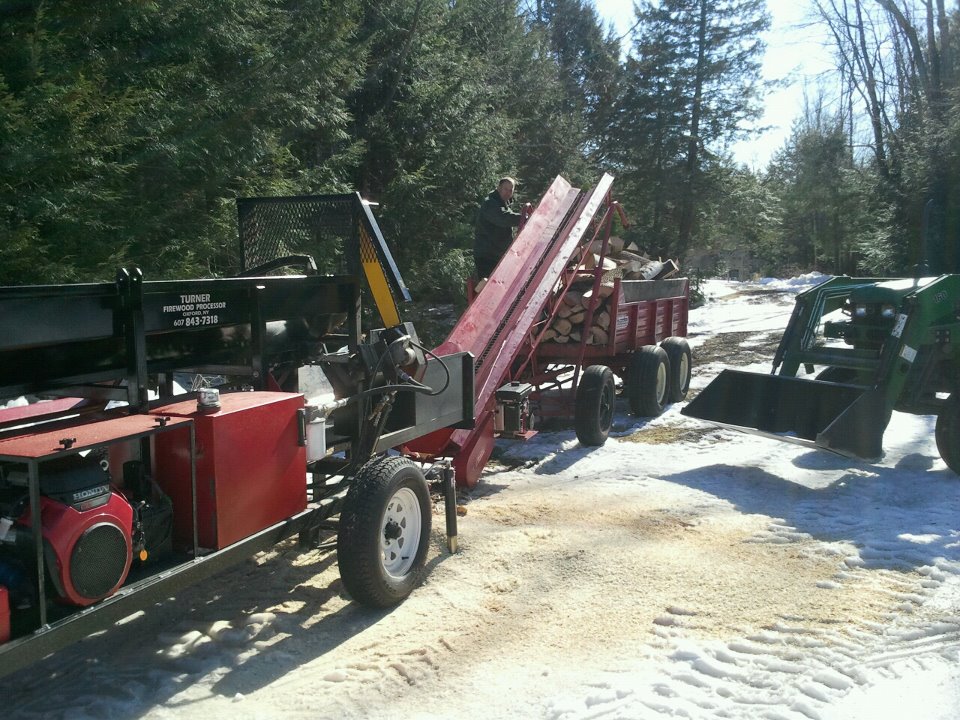

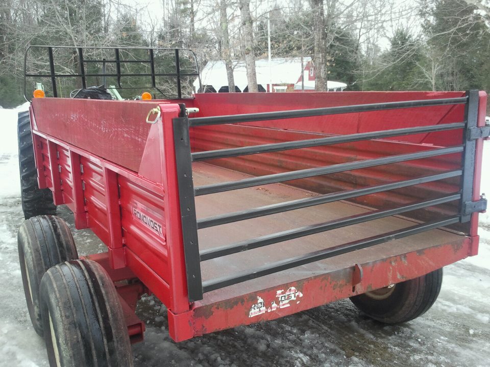

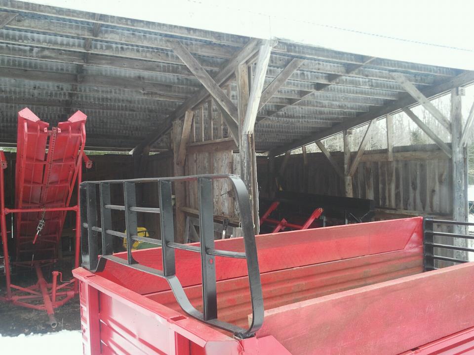

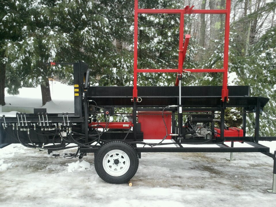

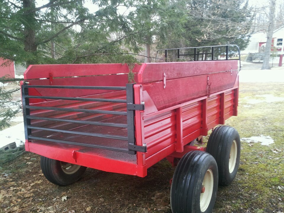

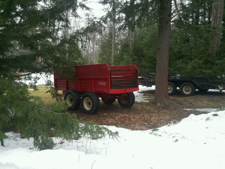

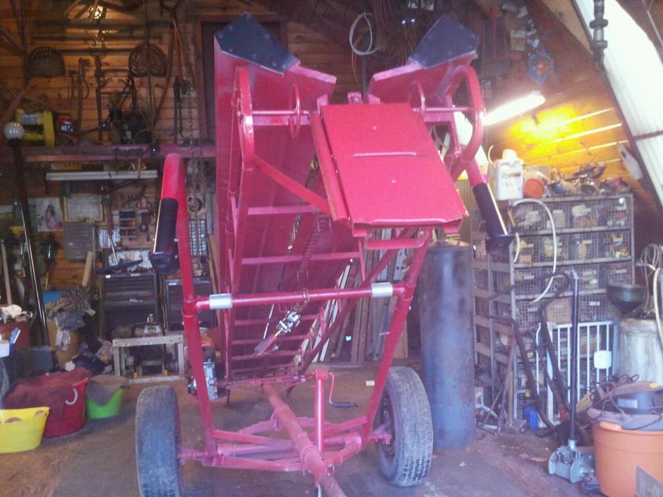

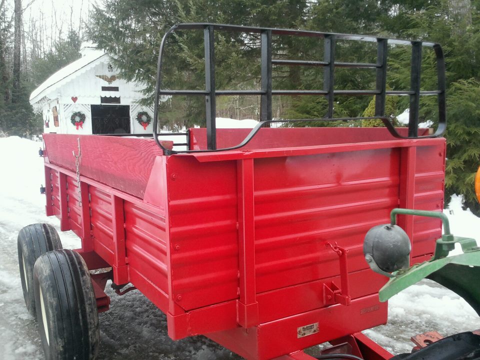

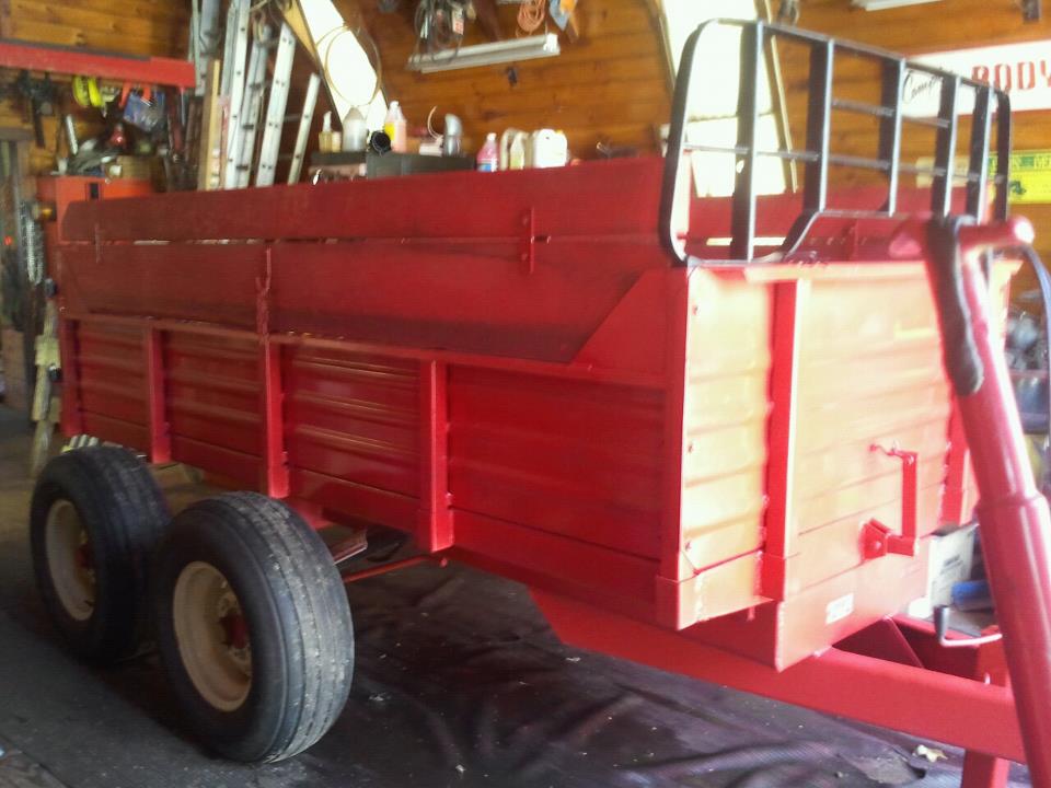

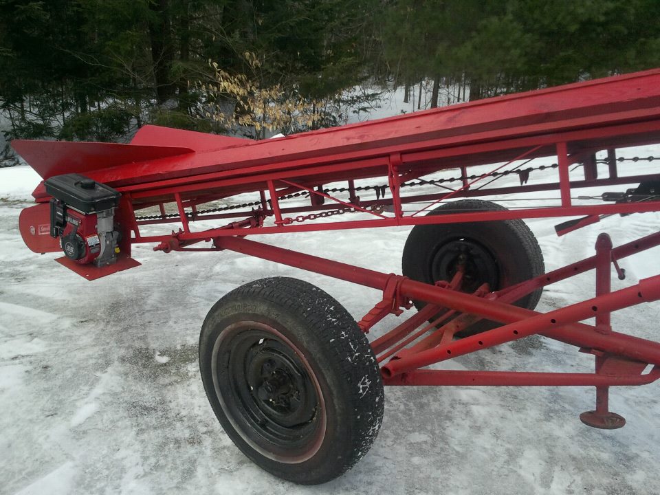

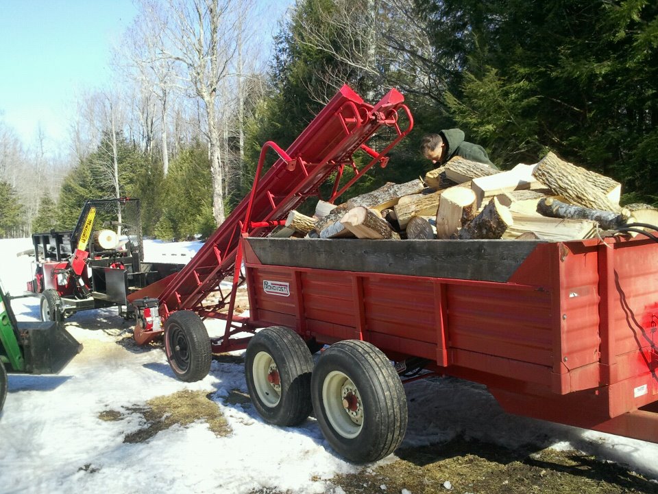

Been working this winter on bumping up my firewood toys. Have a look~ Bought a new firewood processor from Turner mills in new york-TurnerFirewood Processor also repainted my 5x10' pronovost dump tailer and added a firewood tailgate in place of the dirt gate it had and added a headboard and 2 tier oak sideboards. And took a hay conveyor and turned it into a WONDERFUL firewood conveyor, by putting an axle and tongue under it and built a wooden trough and aluminum hopper . Tried this and it works Remarkably well.
This is for my home operation, I burn 20 cord of wood per year.

The processor I paid cash for. Saved for over 10 years for it. that tractor and dump trailer has been paid for for a long time. My next venture is a newer F-350 with a dump and plow. long driveway ya know. :) life is good!!
you wouldn't know it, but that trailer is 30 years old. One of the upgrades I paid for on the processor is I had Bill Turner plumb another valve at the end of the row so I could run a hydraulic conveyor should I want to. But here's the thing. That 3.5 hp Briggs will run that conveyor all day at an idle and if anything hitches up the engine just stalls out. and it does it on less than 1 gallon of gas (9-10 hrs) I have the lines all plumbed to a nice danfoss motor but i'm reluctant to mess with it because it's already PERFECT.

The wood on the conveyor is held in place by approx. 10 u-shaped clips on each side that attach with 2 screws each. The hopper I made from a large aluminum composite sign I had laying around since the 70's. I made the brow because it wasn't quite reaching the front of the trailer as the wood fell in. "whatever you do, or dream you can, BEGIN IT!!! Boldness has genius, power and magic." I read that this morning, rather inspiring I thought. Other than paint and a two hundred dollar motor for the conveyor, I did the upgrades with stuff I just had lying around.

well, when I just heat the living area of my home I burn between 8-12 cord. When I heat the attached green house, 3 stall tie-up, mechanics garage and woodworking room and library it's again another 10-12 cord. The processor cost me $15000 with the couple small upgrades I had tacked on. plus $600 to have it shipped here.
