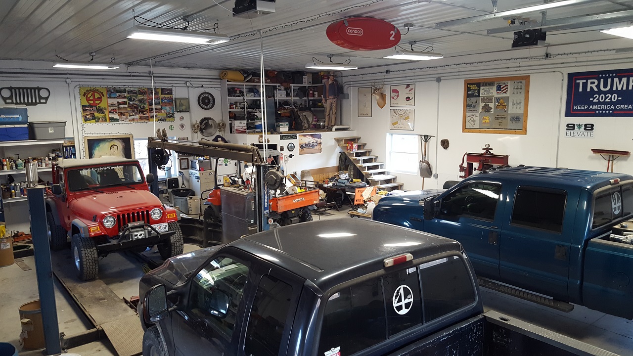

I don't want to hog your thread. I'll honestly answer any questions you have though. There are some things I wish I had asked about before building. Eddie Walker is a very good, logical source for answers and will give them honestly. I'll post a couple pics
It's a 39x48x14, 2x6 stud walls, 6" concrete slab with footings, hydronic floor heat, two 12x12 overheads, two 36" mandoors, four 4x4 double hung windows, R19 wall insulation, 18" blow in fiberglas in ceiling, OSB wall covering, tin panel ceiling, six 4ft 6 bulb LED lights, bathroom.
For me, I like to see out. I like utilizing daytime light in the shop. I can work in my shop with the lights off during the day. I have a view in every direction. Even have windows in my overheads.
Do Overs.
1. Horizontal Slider windows. Every time I walk to one of my windows to look out the horizontal splice is directly in my line of sight.
2. Raise the wainscoat line a foot. Would have much better appearance and not look so tall.
3. Floor drain in one bay for parking on those wet, sloppy days.
4. Use a hydronic floor heat slab thermostat. They use a sensor in the concrete in conjunction with measuring the air temp. Helps prevent overrun of temps. My simple thermostat is set on 67F. It overruns 2-4 degrees every cycle. I think that could be better controlled by measuring slab temp along with air temp. I've got one ordered and will install it next weekend. I'll report my findings. I use a Rinnai tankless heater set on 110F degrees.
5. Overhead door openers. I used Liftmaster openers. They have 400ft range with my lights off. 50ft range with the shop lights on. I started with fluorescent bulbs and transformers in my lights. After Googling this problem and talking to my electrical supplier I swapped the bulbs to LED and removed the transformers. This helped. Prior to that change I had to hold the opener remote up against the door glass if outside to get a door to open with lights on. Not sure what's going on there. I even added external antennas outside which also helped a little. I'm open to anyone's suggestions in that regard.

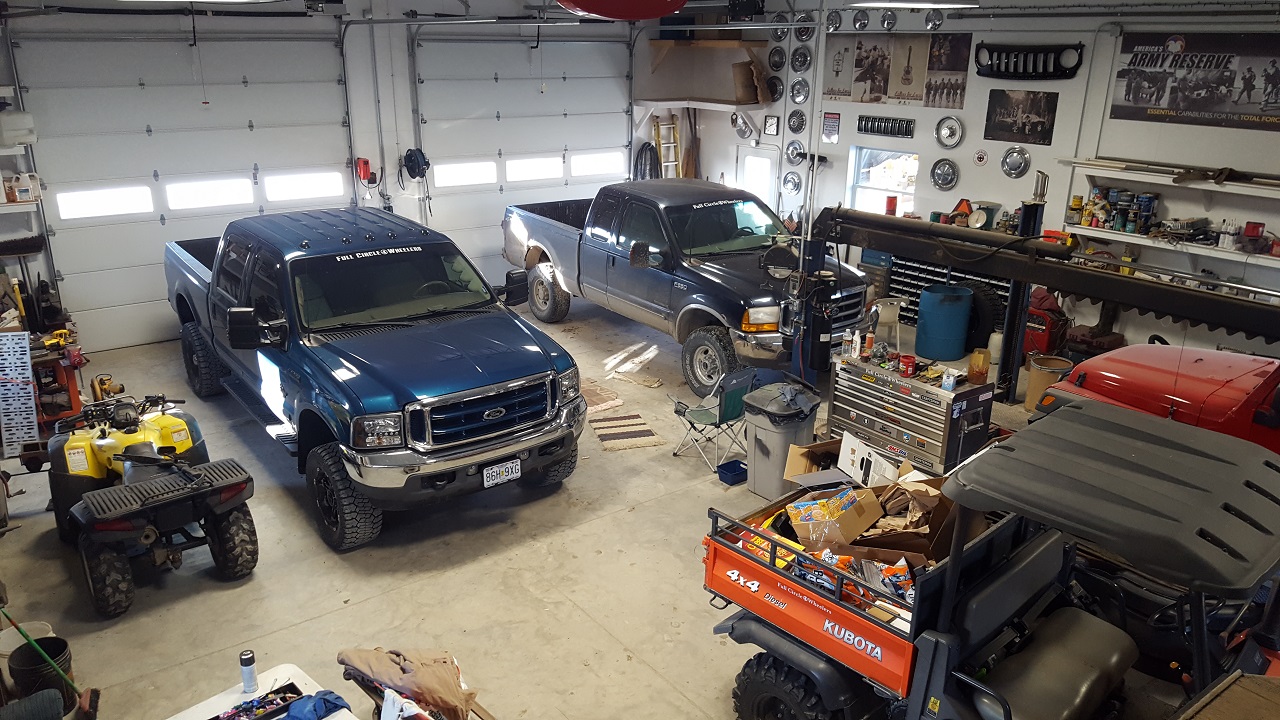

This made me smile. I have a Mule and the bed is always full of Amazon boxes, and anything else that needs to go to the burn pile. Never planned on using it at the place to store all my garbage, but then again, I didn't know a quarter of all the things I'd use it for!!!!
   / My new barn / shop build #16
Ain't that the truth Eddie. I've had this machine 3 or 4 years. Use it for many, many chores. Keep thinking Terry will need to haul off her house trash pretty soon and dump it for me. I think she's trying to outwait me. As soon as I back out of the shop I'll hear her hollering from the house door to take her trash too. :D

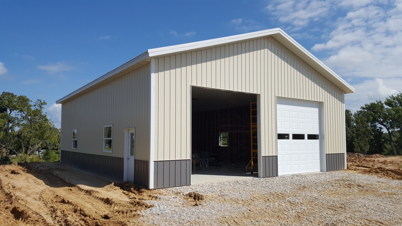

Congrats. Looks like it will be a nice shop, yours will be just about the same size as the one I am starting to build( 30x45 ). I might go 48 not sure yet, I just started clearing the area late this fall where I will be building mine, I am doing all the clearing and leveling with my GC1705 so it is taking time.
