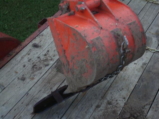

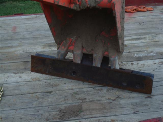

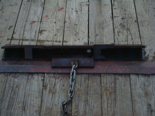

here is a couple pics of the "grade blade" i am always talking about. works great in alot of different aplications

Interesting. What all did you say you do with it?
   / My new backhoe thumb #45
they advertise them to be the greatest thing to backfill a trench after your done and it works great for that. depending on the angle of the blade you can slide right on top of the grass to put the spoil back in. I have also found it to be really good at cutting sod, the sod will roll up into the bucket into nice pieces. its great for gleaning out ditches, grading an area for a padio or walk, carving into packed clay, cleaning up an area when your done (its like a solid rake).
it just seems vary useful, i built it for my old bx23 and mad it work for the b3030 and built it out of scrap from my toothbar project. last weekend i excavated out for my buddies padio and walk and it performed perfect since we were only shaving the sod off. He was able to take the sod to another area and use it there. I also cleaned his 1/4 mile worth of ditch with it, its not fool proof but i have yet to cut a line with the thing, even his 12 gage sprinkler circuit. managed to run across it 3 times and not cut it.

Hmm, may have to get a piece of steel and clamp it on for testing. Though I have serious doubts the kioti bucking bronco backhoe with work for this. Even with the moter at the lowest speed, feathering the controls doesn't work really well. Especially the sideways control. Very frustrating. Maybe someone can give me a hint on the side ways control.
Strong backhoe, but I wish it'd get off the steroids once in awhile..
So, I gather that's about 1/4" steel and when doubled, the part that hits the ground is about 1/2" or did you sharpen it to a cutting edge?

if i used my fixed thumb to hold the blade it would limit my angle on entry way to much.
the steel i made it from is the scrap from my tooth bar which was made from a worn out cutting edge on a box balde or large wheel loader, i duno which. the piece was allready cut to an edge. i would say its about 5/8" thick and backed up with some 1/4 inch strap i had laying around. For a project that only took about 30 minutes to build it sure has worked well in various situations.
