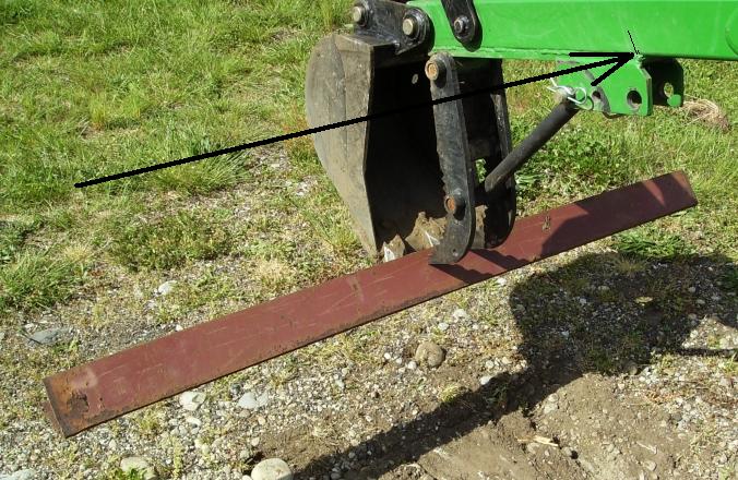

I went to start working the tractor this weekend and noticed something very very bad, my dipper stick arm had a 2" crack in it on one side and 2 small 1/2 -3/4 inch cracks on the other side. Both cracks were up at the top portion of the plate I welded to the arm for the thumb to mount on.
I spent most of the day saturday welding and grinding to repair the cracks. I first cleaned the cracks and welded them closed, then i welded soome 3/8 plate 6" x 3" inch over the area to beef it up.

i borrowed a pic to show where is was cracked
   / My new backhoe thumb #55
Did you pre-heat steel and post heat steel after welding?
Boom probably made from high strength steel, something besides A-36. Often requires addational heat to prevent stress cracks from starting in the weld as it cools.
i did preheat before i welded the crack and the plates over the crack, kinda freaked me out to be honest. I wonder if just that arm is available from kubota?:eek:
I dont really know when the craks happened, I have "dead headed" the hoe on several different ocasions llately,pulling stups, and concrete chunks out of a drive way. I am more worried now after seeing some old post with bent cylinders on Kubota BH. :eek:
As for high strength steel i am unsure, the stuff welds real easy with my 110 mig.

ok so as to not jinx anyone here is a pic of the red neck thumb, this side is the one with 2 cracks and the blue box is close to where I welded the plates on each side

In the pics i have found it looks like the woods dipper arm is designed completly different than the botta, the botta is like a c channel with a welded in piece to close the "C". The woods looks like an almost box design, I see an overlapping piece on the top and bottom. I would imagine this adds alot of strengh and weight.
