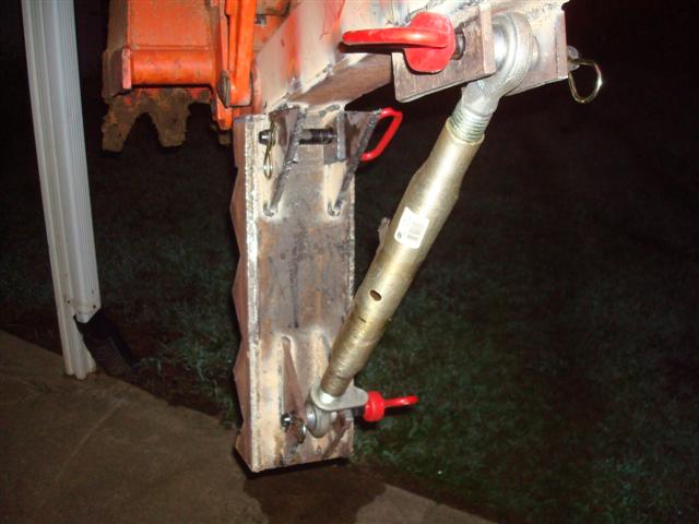

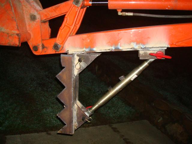

Well, you have that bar that spans the center now, so that is probably good enough. I just put some remnant teeth on my bar for added grip and a cool look. Don't know how much those teeth really add. But nevertheless, they will grip, that's for sure.
On another note, the concern for off center grabs possibly tweaking the jaw could be off set with two turnbuckles instead of one...that is if you find it to be a problem.
/ My new backhoe thumb #42
i really have not noticed a problem, i did actually break one of the mounts at the top of the thumb. I cleaned the area up with the grinder, then added a brace between the 2, problem fixed.

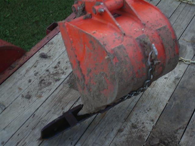

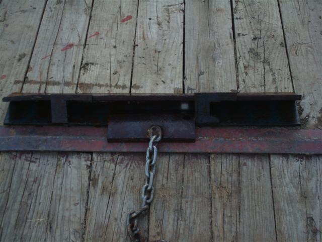

here is a couple pics of the "grade blade" i am always talking about. works great in alot of different aplications

Interesting. What all did you say you do with it?
/ My new backhoe thumb #45
they advertise them to be the greatest thing to backfill a trench after your done and it works great for that. depending on the angle of the blade you can slide right on top of the grass to put the spoil back in. I have also found it to be really good at cutting sod, the sod will roll up into the bucket into nice pieces. its great for gleaning out ditches, grading an area for a padio or walk, carving into packed clay, cleaning up an area when your done (its like a solid rake).
it just seems vary useful, i built it for my old bx23 and mad it work for the b3030 and built it out of scrap from my toothbar project. last weekend i excavated out for my buddies padio and walk and it performed perfect since we were only shaving the sod off. He was able to take the sod to another area and use it there. I also cleaned his 1/4 mile worth of ditch with it, its not fool proof but i have yet to cut a line with the thing, even his 12 gage sprinkler circuit. managed to run across it 3 times and not cut it.
ohh and also work well for cleaning off the trailer

So, I gather that's about 1/4" steel and when doubled, the part that hits the ground is about 1/2" or did you sharpen it to a cutting edge?

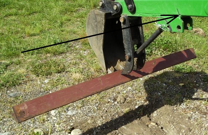

if i used my fixed thumb to hold the blade it would limit my angle on entry way to much.
the steel i made it from is the scrap from my tooth bar which was made from a worn out cutting edge on a box balde or large wheel loader, i duno which. the piece was allready cut to an edge. i would say its about 5/8" thick and backed up with some 1/4 inch strap i had laying around. For a project that only took about 30 minutes to build it sure has worked well in various situations.
/ My new backhoe thumb #50
Ya, that is the biggest draw back doing it with the thumb.
Gotcha on the install/uninstall time though.

im thinking maybe by 30 seconds, lol
curl bucket, set blade on teeth, screw together clevis

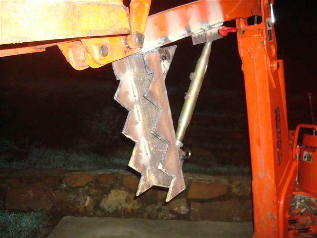

I went to start working the tractor this weekend and noticed something very very bad, my dipper stick arm had a 2" crack in it on one side and 2 small 1/2 -3/4 inch cracks on the other side. Both cracks were up at the top portion of the plate I welded to the arm for the thumb to mount on.
I spent most of the day saturday welding and grinding to repair the cracks. I first cleaned the cracks and welded them closed, then i welded soome 3/8 plate 6" x 3" inch over the area to beef it up.

Did you pre-heat steel and post heat steel after welding?
Boom probably made from high strength steel, something besides A-36. Often requires addational heat to prevent stress cracks from starting in the weld as it cools.
/ My new backhoe thumb #57
i did preheat before i welded the crack and the plates over the crack, kinda freaked me out to be honest. I wonder if just that arm is available from kubota?:eek:
I dont really know when the craks happened, I have "dead headed" the hoe on several different ocasions llately,pulling stups, and concrete chunks out of a drive way. I am more worried now after seeing some old post with bent cylinders on Kubota BH. :eek:
As for high strength steel i am unsure, the stuff welds real easy with my 110 mig.
