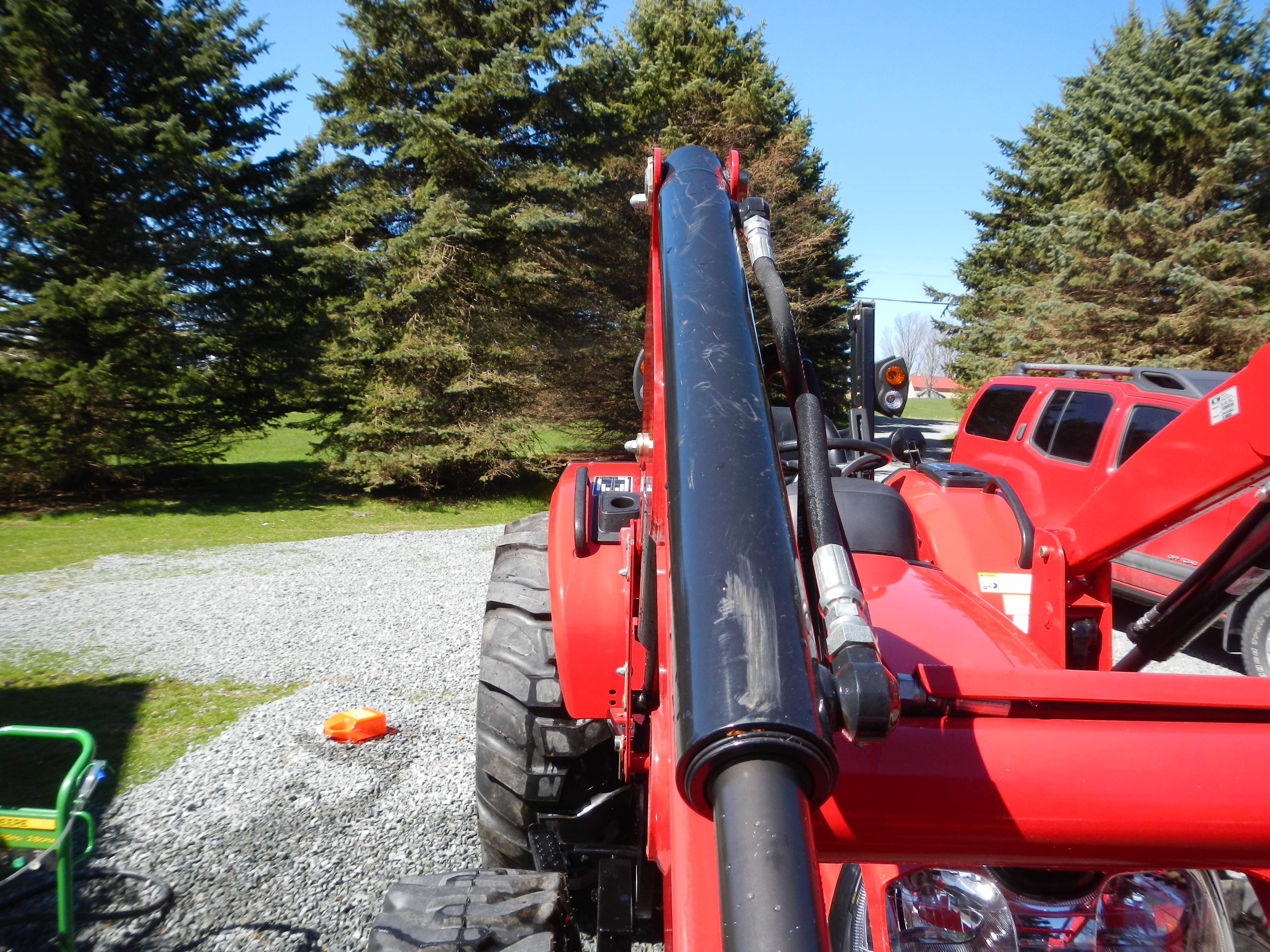

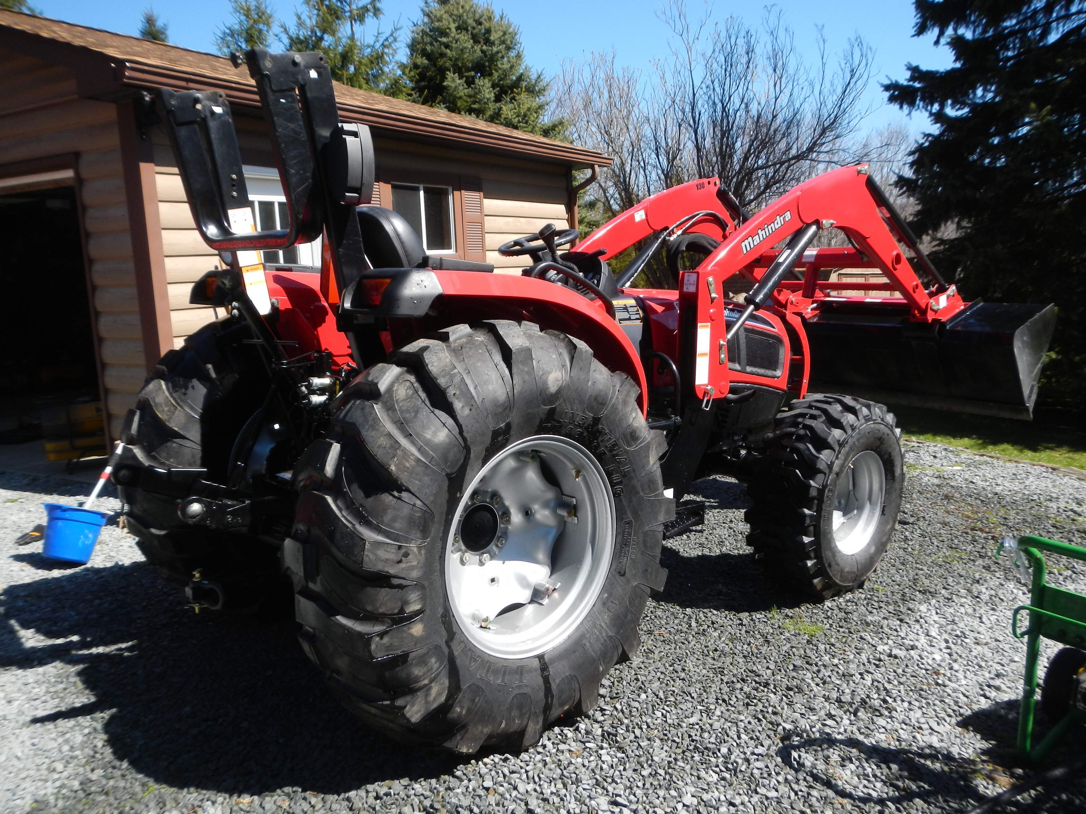

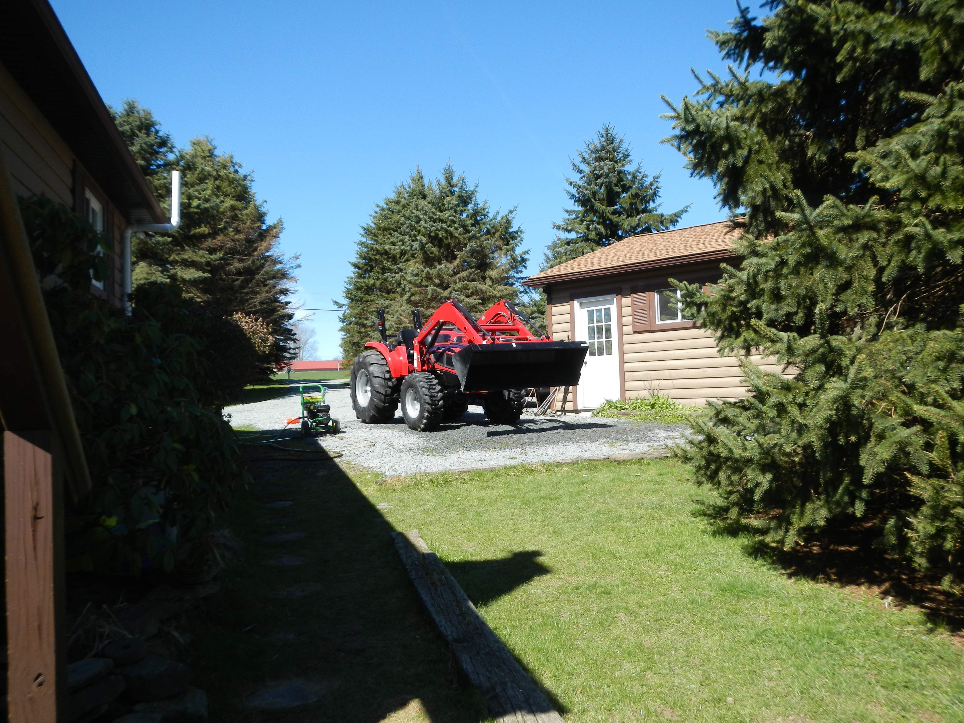

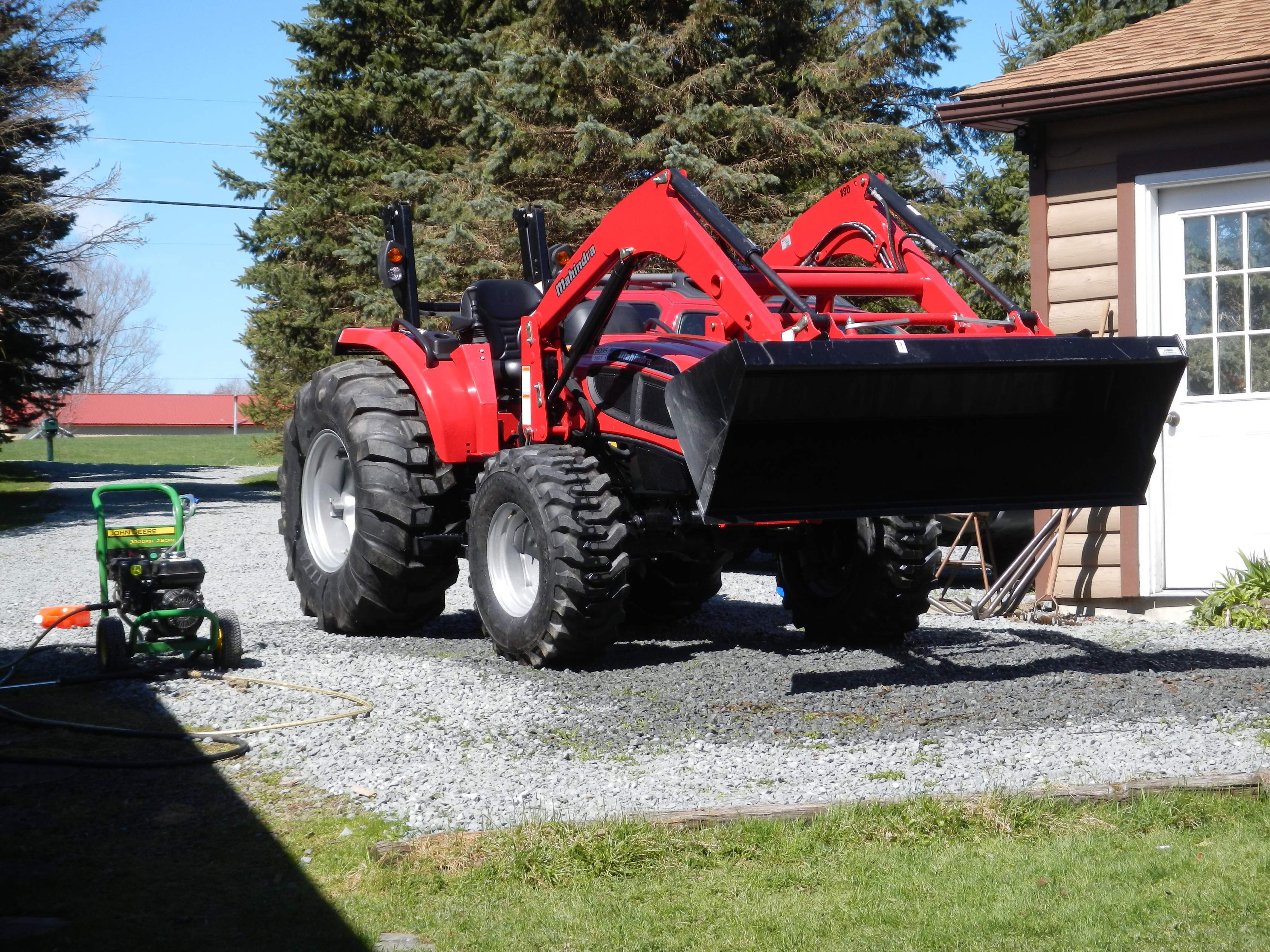

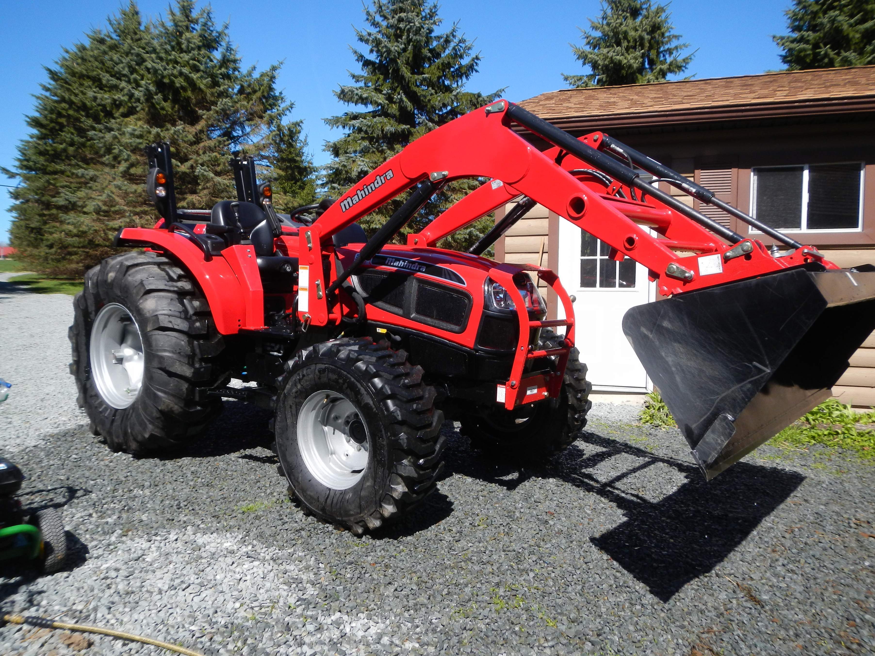

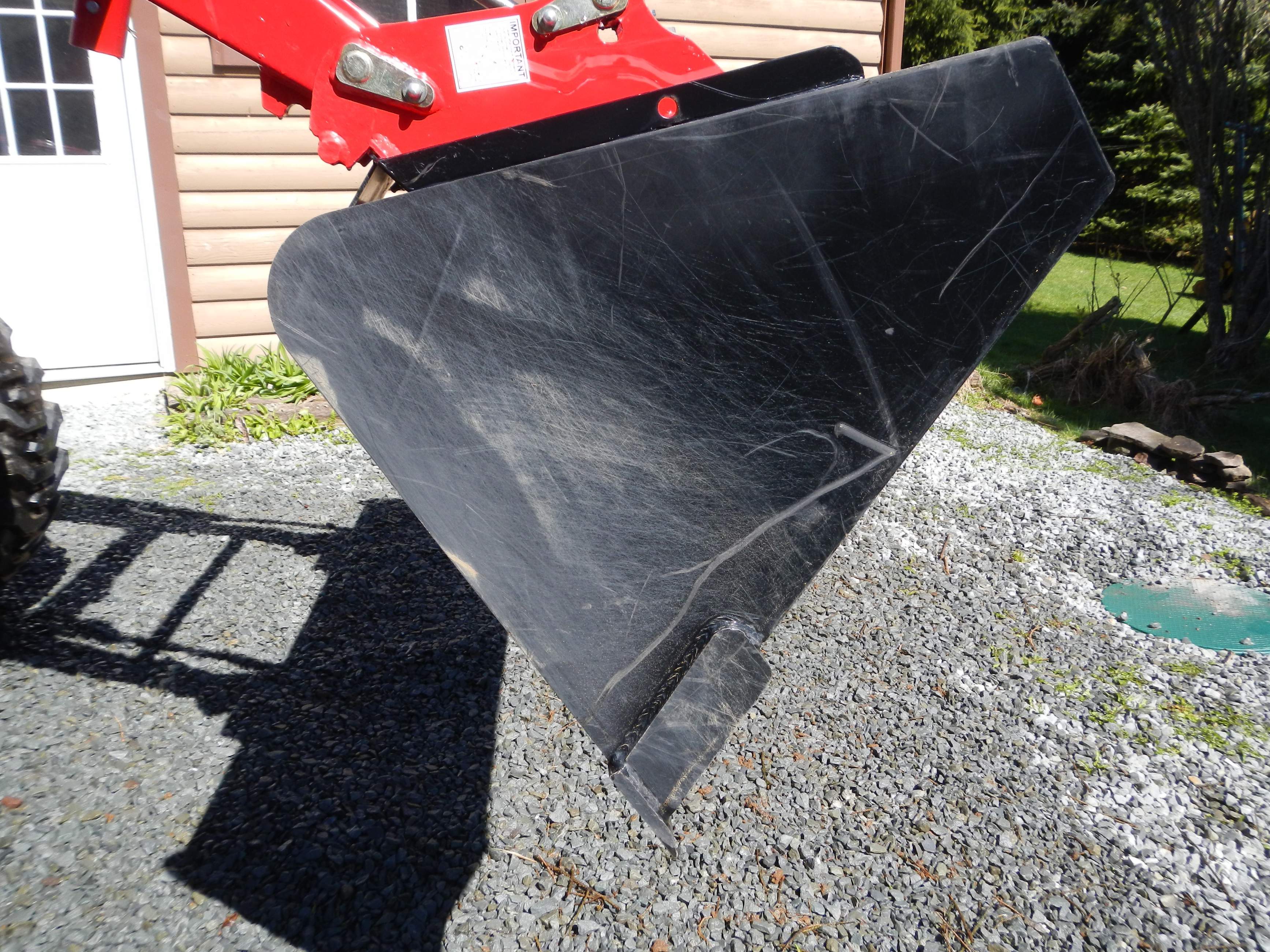

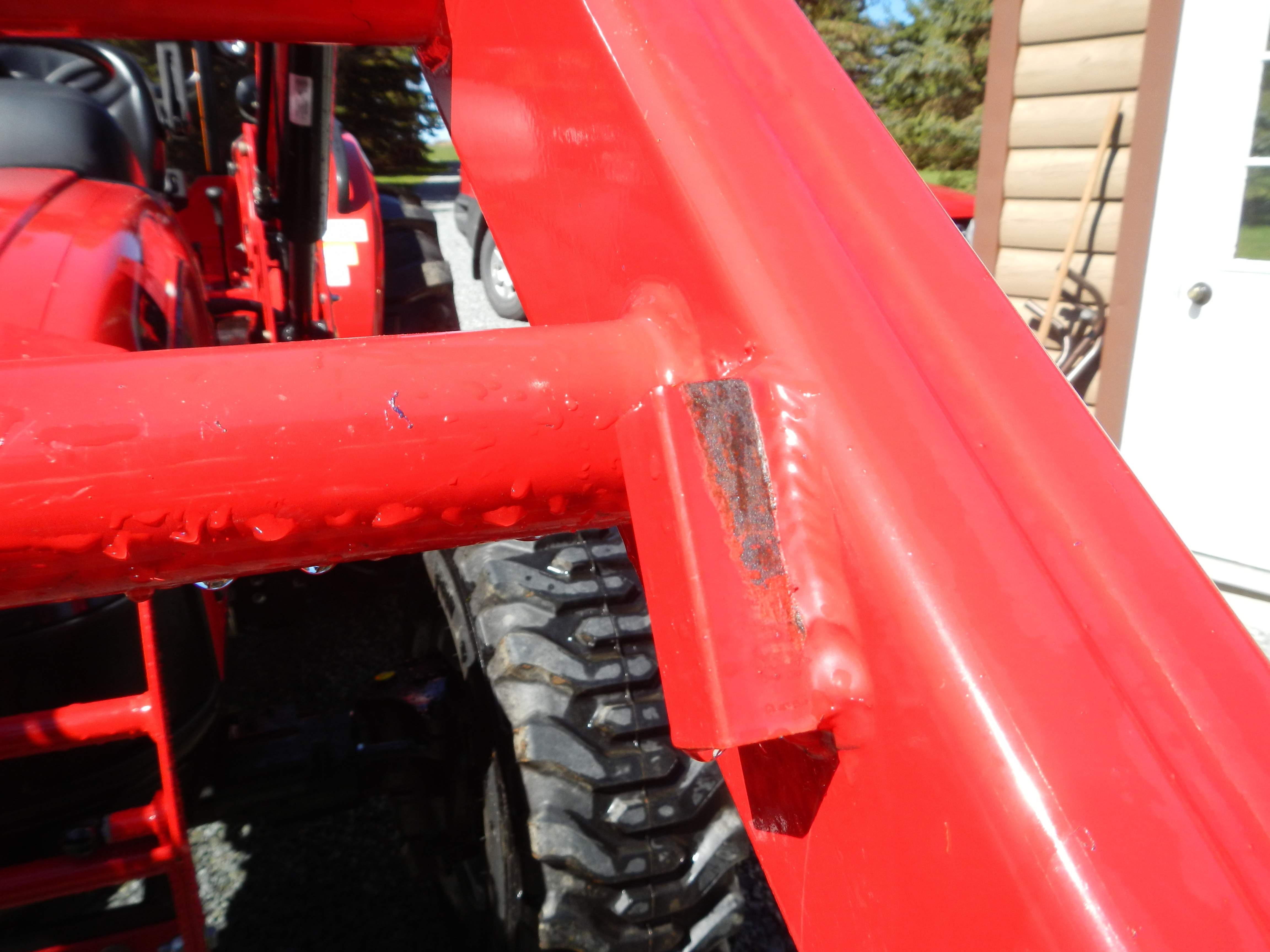

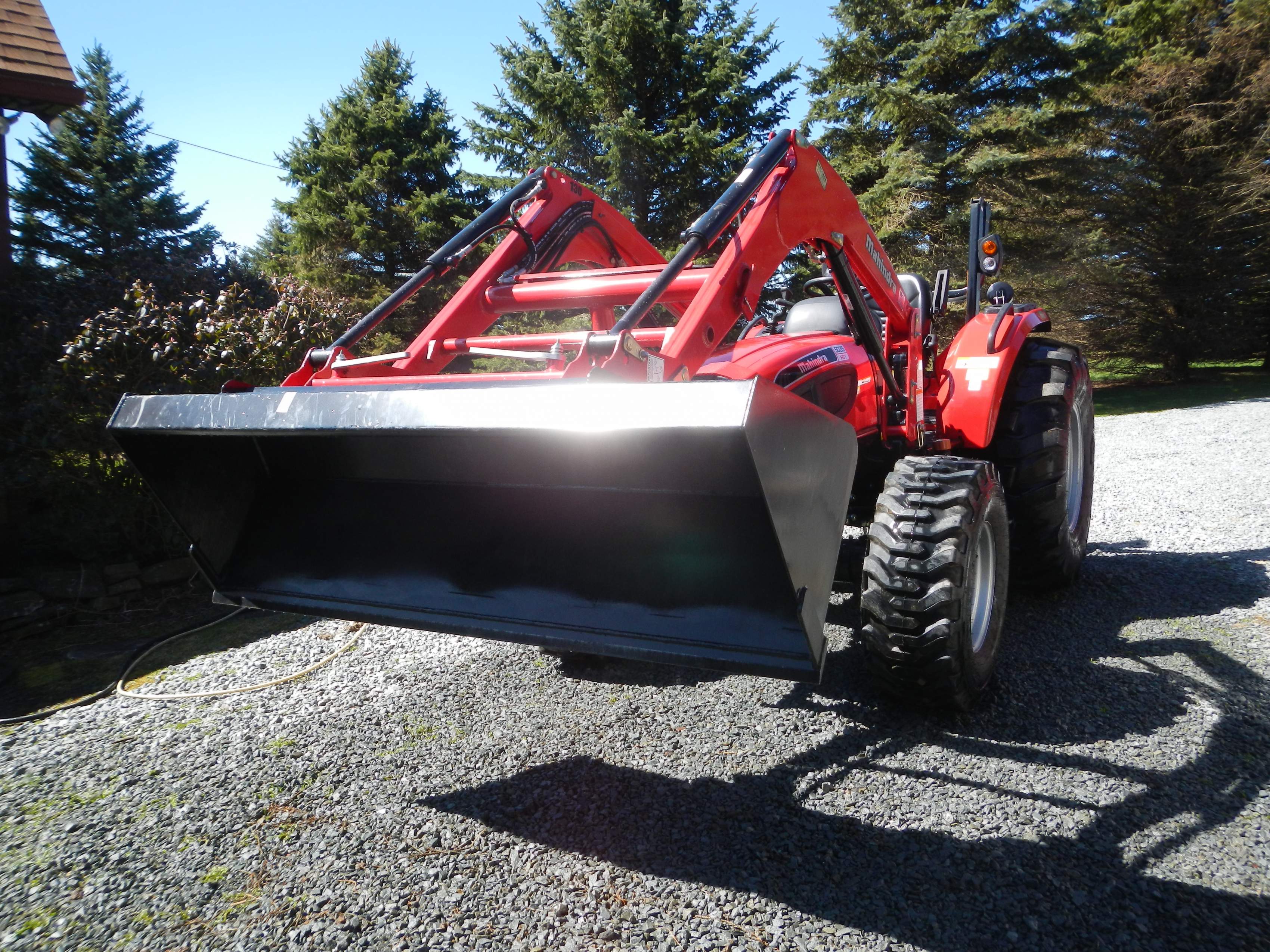

Yeah well she got a ring on her finger so she's happy. You have to put a ring on the finger of a woman who let's you get a giant toy. Here's a few more. It's been a few weeks and man does the ware show quickly. You can see the loader is scratched to heck which is to be expected. I also scratched the hydraulic cylinders moving some brush around. I gave it a good bath to day and did notice some small chip and rust spots. They don't bother me, it's a tractor. However, I would like to hear any suggestions for further rust prevention.
Note: Yes, in the pic there is a little green guy. I employ this little guy I got on craigslist to bathe and primp my Mahindra.:D
