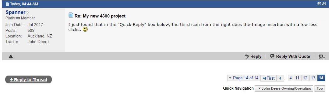

/ My new 4300 project #134
I just found that in the "Quick Reply" box below, the third icon from the right does the Image insertion with a few less clicks. :)

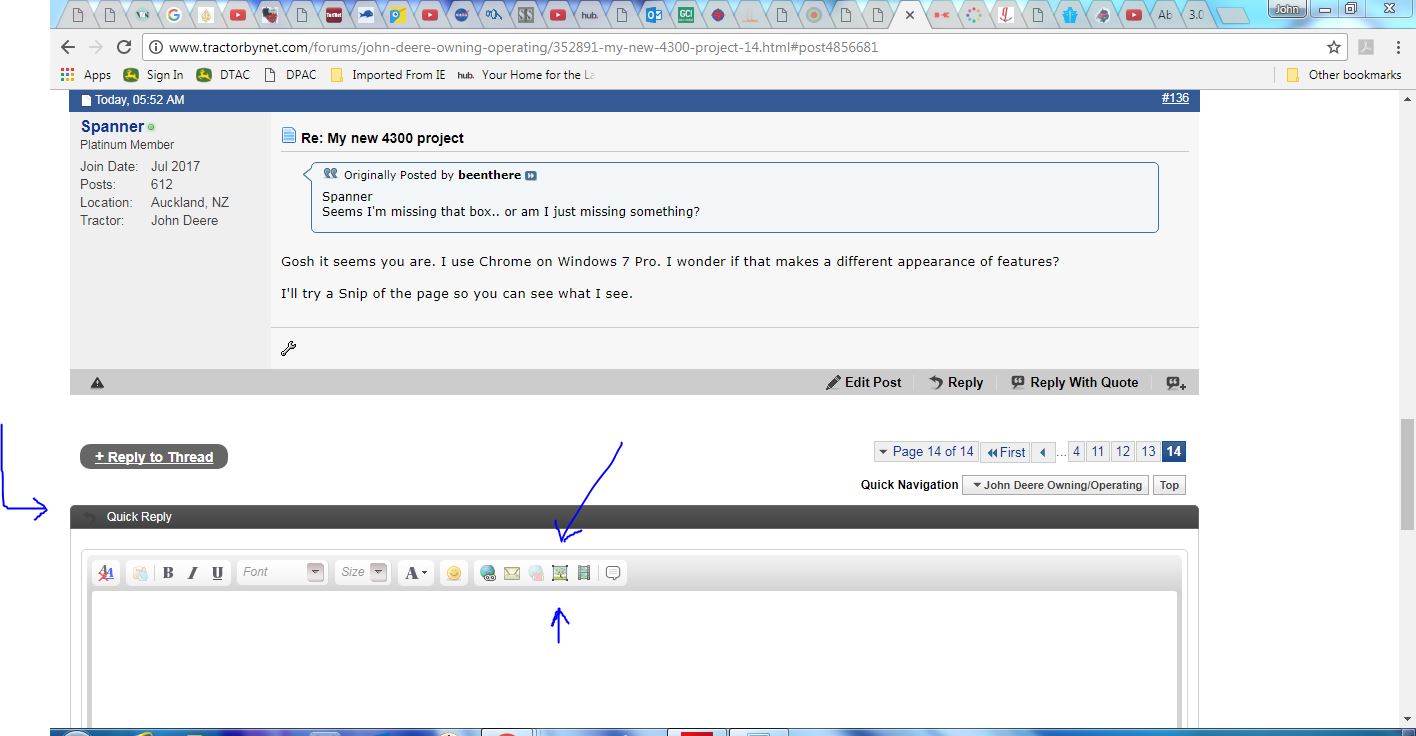

/ My new 4300 project #135
Spanner
Seems I'm missing that box.. or am I just missing something?
/ My new 4300 project #136
Spanner
Gosh it seems you are. I use Chrome on Windows 7 Pro. I wonder if that makes a different appearance of features?
I'll try a Snip of the page so you can see what I see.
EDIT: Added
Hope that helps. The icon I mentioned is double-arrowed.
I see the same icon if I "Go Advanced" as well.
