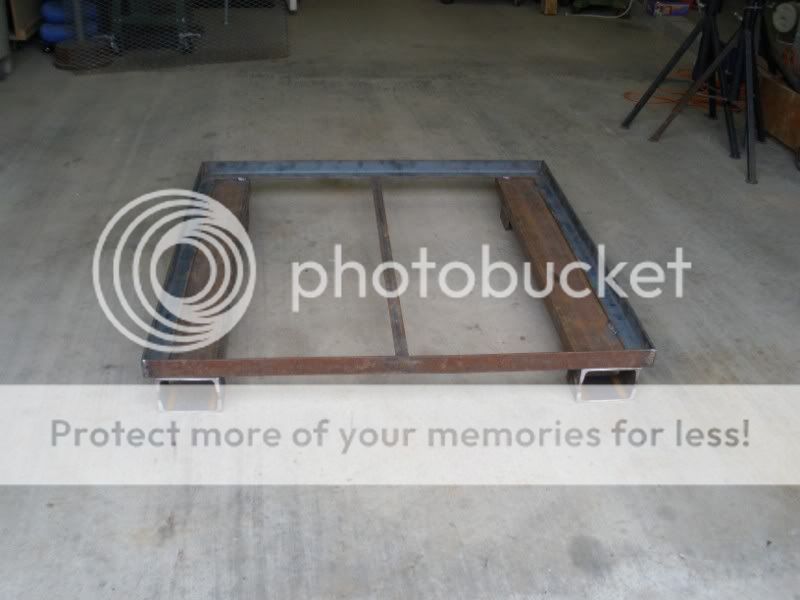

Here's my take on a manlift I'm building. I've got lots of tall trees to be trimmed, a 15 foot high gate that needs painting and a bunch of other tall projects to do so I've been wanting to get this done for a while.
I'll post pictures as this progresses but here's the first of them:

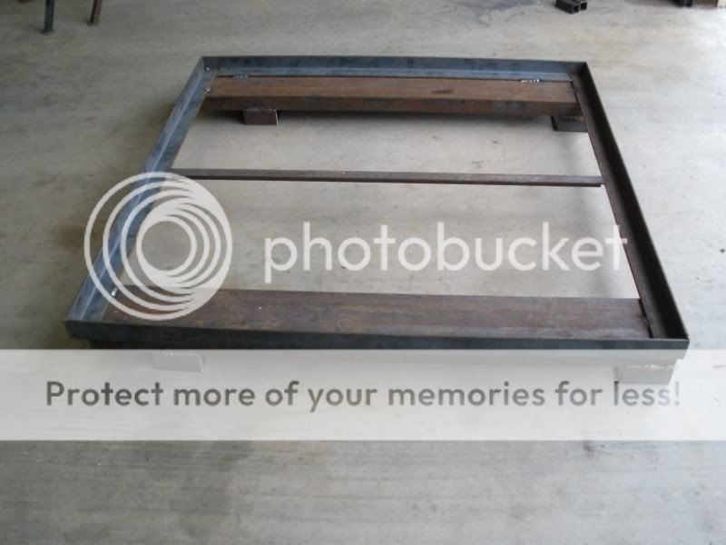

This is the beginning. The base is 2x2 angle. The bottom has two 6 inch channel iron guide for the forks on my front end loader. Because my forks are 4 inches wide and 2 inches high at the root I had to weld on 4 inch pieces as you can see below to form boxes. A side benefit of this is they will become the mount for casters I will be adding so moving this around in the barn will be easier.
This is a side view so you can see where I welded the additional channel pieces.

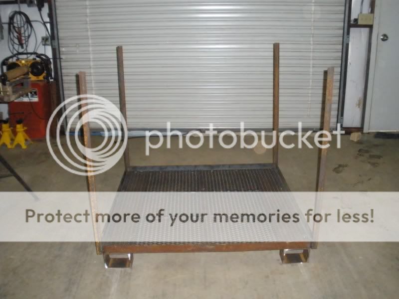

Here the floor is added as well as the floor cross bracing. The floor is of expanded steel mesh. The uprights are 1.5x1.5 angle.
I may add a quick change front end to this so I can just hook up to it rather than having to use the forks all the time. The jury is still out on this one though.

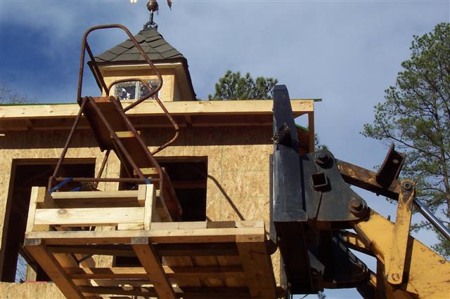

When building my deer blind, I built a platform out of lumber and the attached a portable set of stairs on it for some extra height. One day, I'd like to build a better one from steel like you are doing. If and when I do that, I'd be sure to include stairs or a type of ladder at the end for additional height. You will always want more height!!!!
