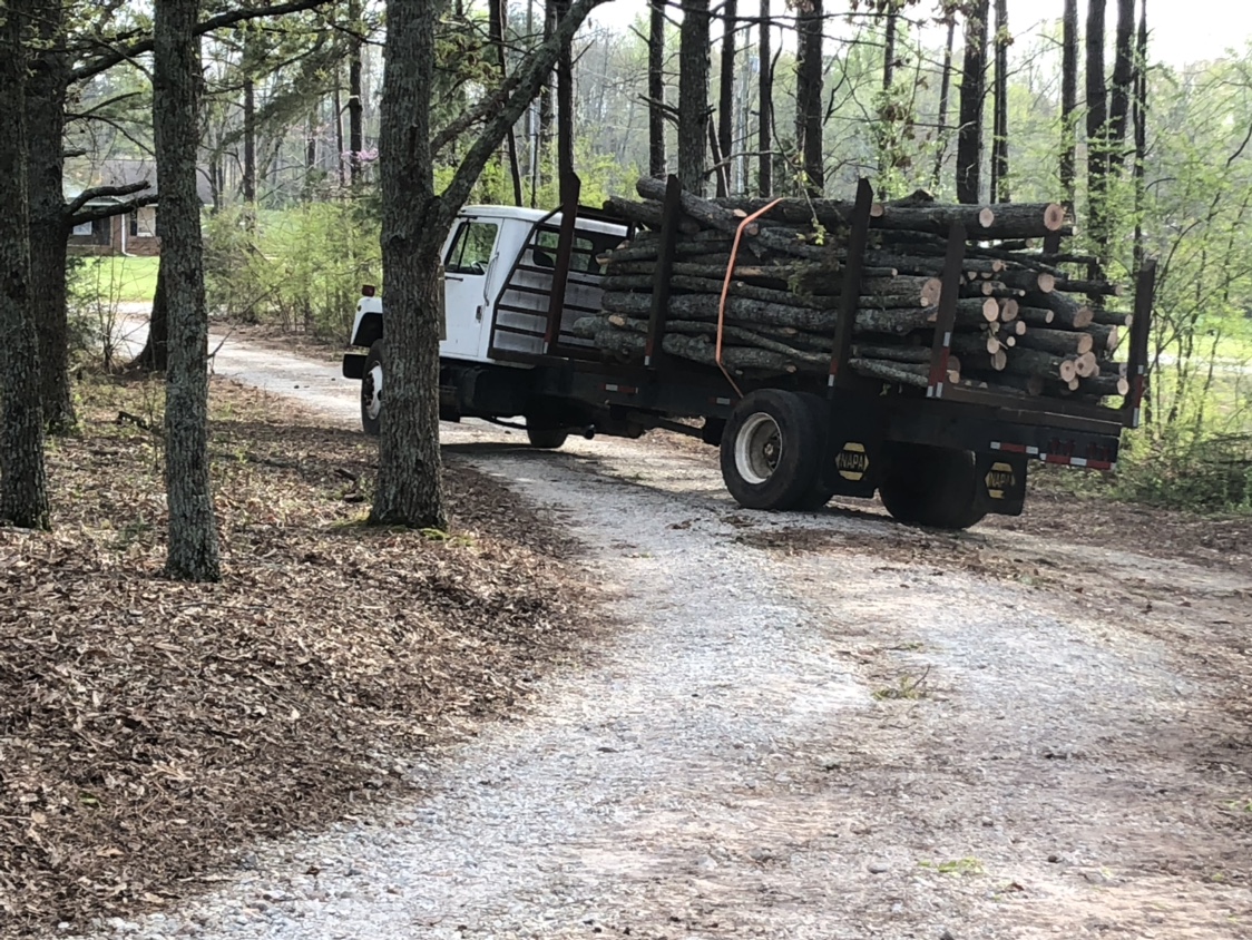

I was ridiculed for buying a M7060HD-12 to use for tree work.
“ You can’t load a log truck or Pulpwood truck or your chip truck with a Farm tractor.”
Ok.
It also does pretty good when loading pine tops into the Chipper.
