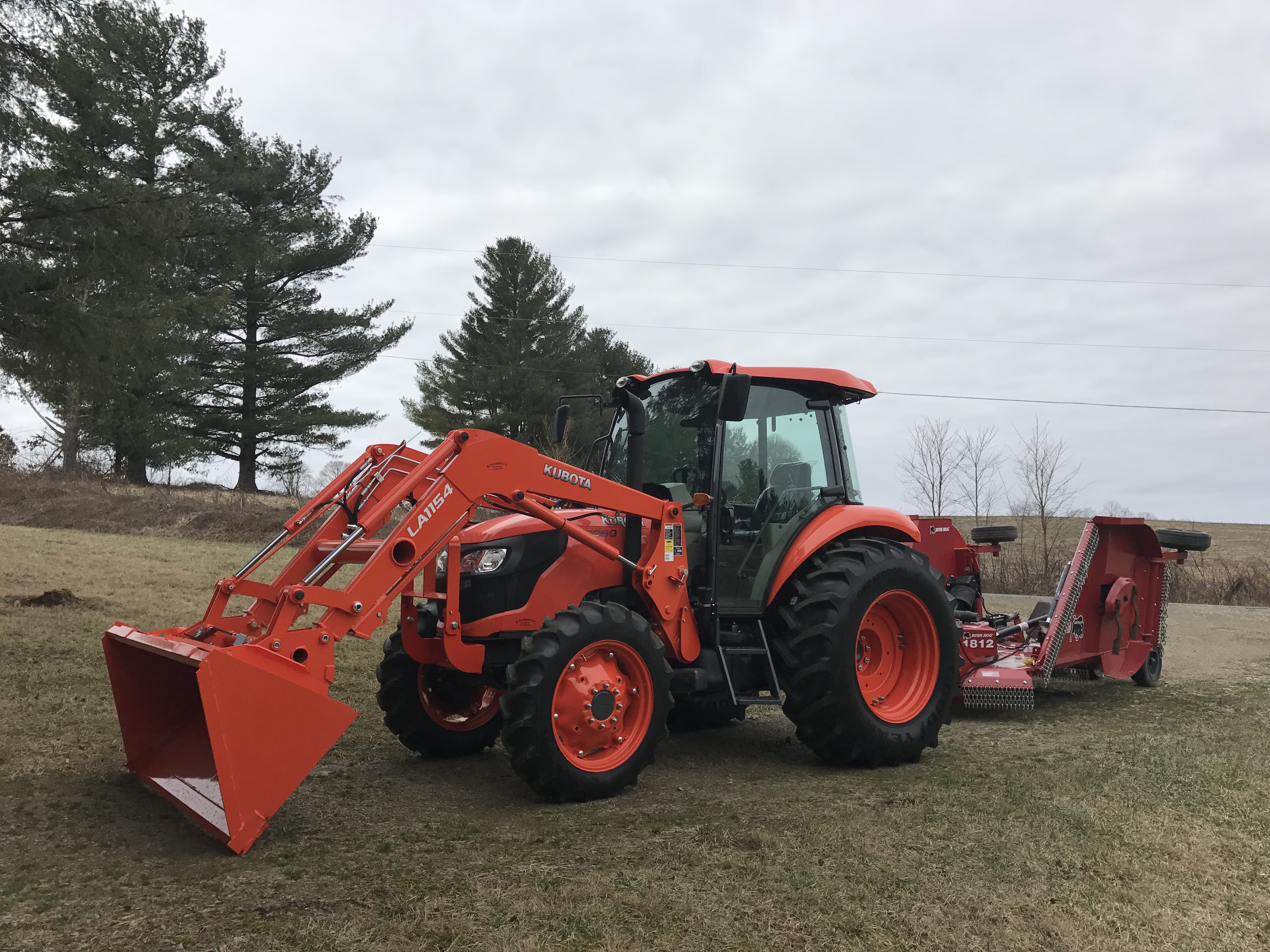

Just few updates: I did not get a huge amount of seat time this month while I was home due to a vacation, me being sick, time of year and holidays. However, I love the creep gear addition. It will prove very useful for the extensive road and trail trimming I will be doing and eliminate a high % of the clutching I had to do prior to installing it. I only got in one full day of true work this time but it was doing some seriously heavy duty bush hogging of several acres that had been completely let go for over 12 years. In my area that means it has an absolute jungle that was about 15' high heavy brush and saplings/trees. I had to do 100% of it in reverse because of the size and also not wanting to scratch my new baby up, lol. While doing this I had my first regen and would have had no idea if I had not noticed the light on on the dash, this was at 23 hrs on the clock. I did the cutting with the 25 year old Hardee 6' cutter we have always run behind the 3930. The type cutting I did would have been a HUGE struggle with the 3930 power wise and operationally (shifting F/R countless times). The 7060 made it darn near effortless and tireless! The shuttle shift was a bit too abrupt in the early hours of operation but after I finished this all day cutting job, with countless shifts, it is now smooth as butter, so it just needed some break in time and that was nice to see. We actually got a few inches of snow a few weeks back that that is extremely rare on the gulf coast. I has sick but still wanted to go outside .....so I took the 2 grandkids (4 and 5 yo) and the tractor out in a big field and let them take turns steering the tractor and just driving wherever they wished while we all stayed nice and warm in the cab:) I also have my 3rd function installed and grapple now and got to play with it just enough to know I am REALLY going to like it. Here are a couple pictures of the stuff I cut, it all looked like a forestry mulcher had come through when I finished.

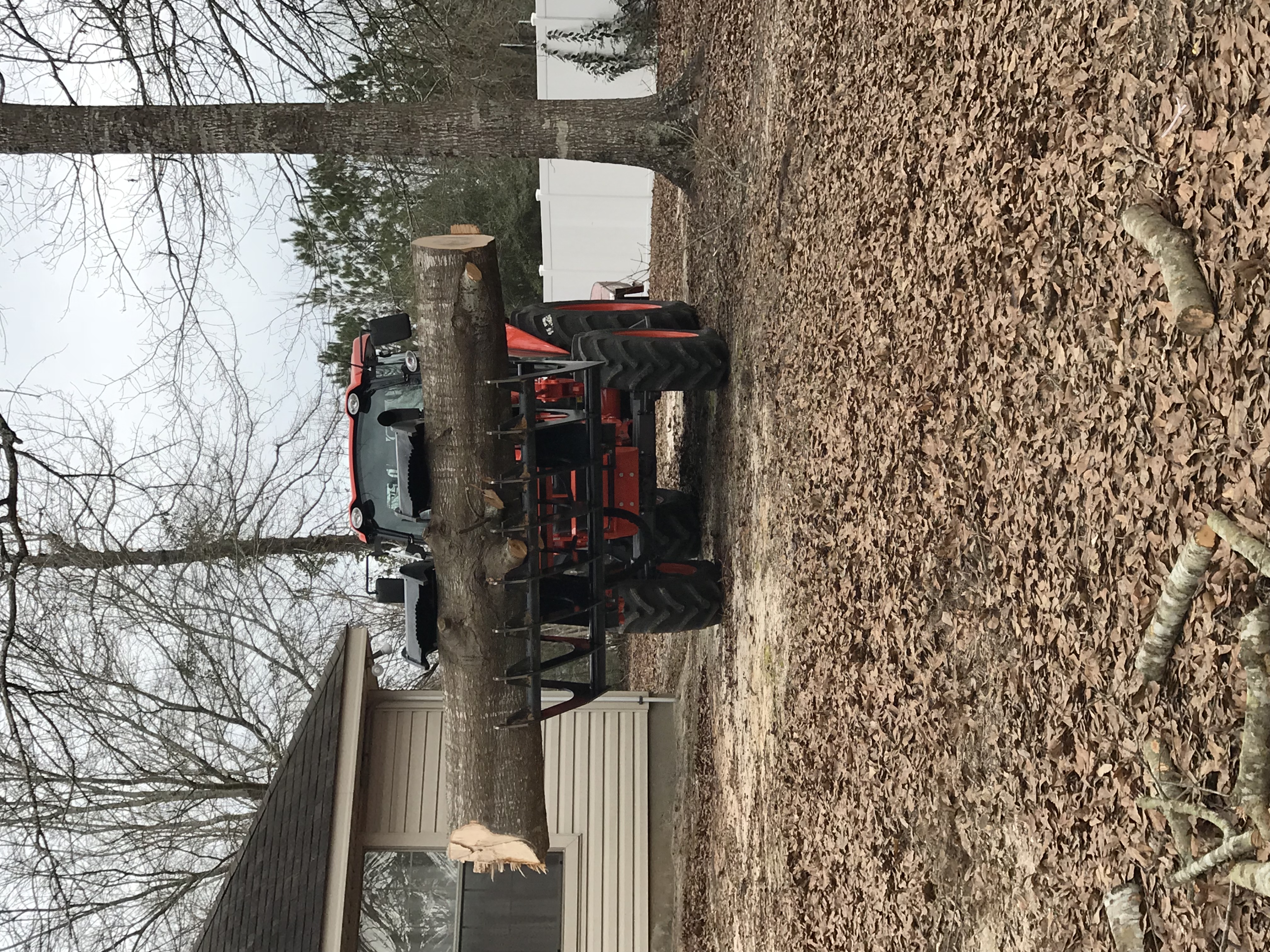

Cut a big oak and hauled it out of my sons backyard, tractor and grapple made it a piece of cake.
Can you tell a little more about the trailer? It looks like a tilt bed but how long is it? It a snug fit but it works.
