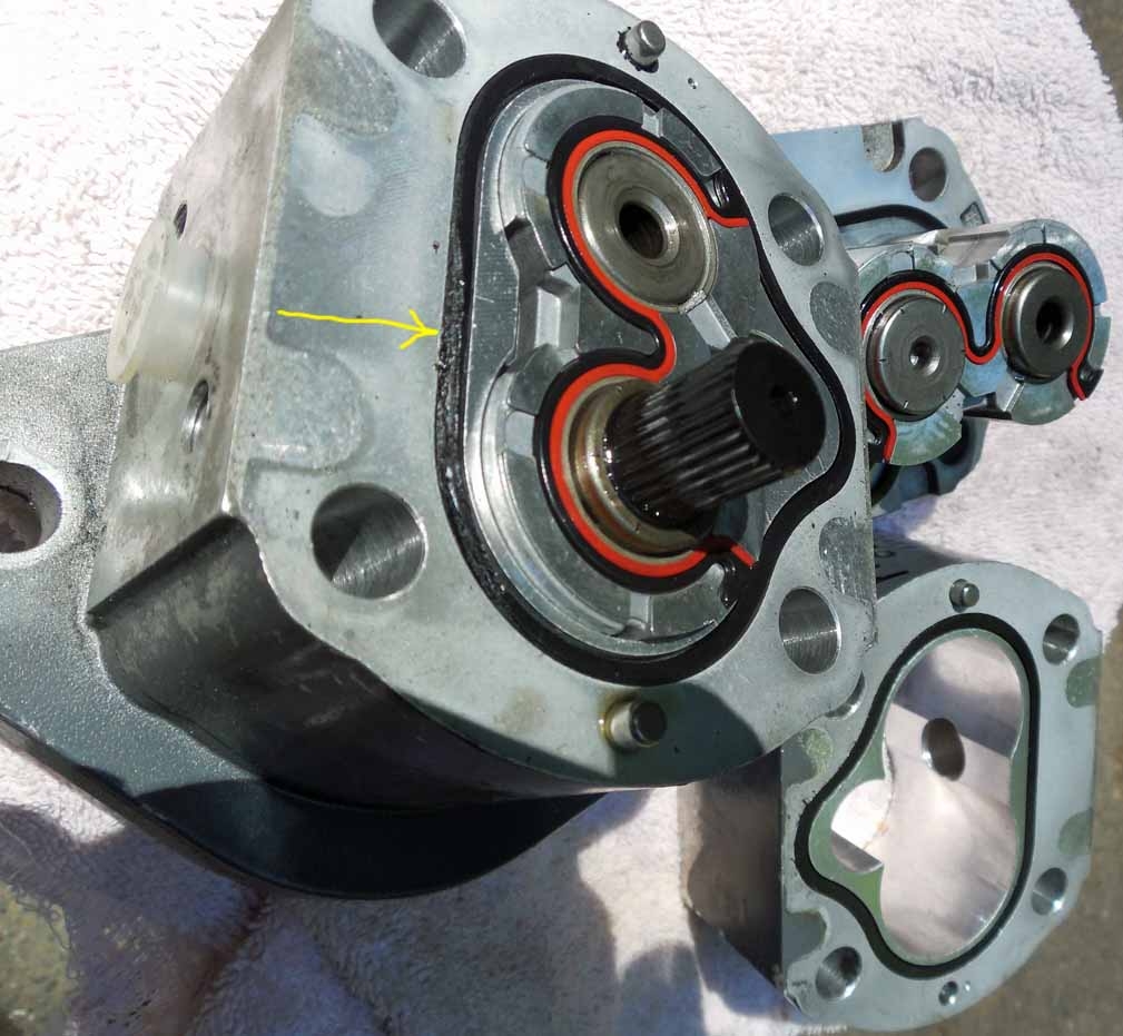

Based on your pressure test, your pump is fine. For now.
Besides a suction hose leak, or water in the oil, there is another way to get air entrainment on these tractors. When going forward up a slope, the implement pump likes to suck air. That's due to an oil pickup near the front of the sump. Happens to me all the time, esp when the hyd oil gets a little low while I am using the loader.
The pump is rebuildable, and for a lot less than the $2000+ you are quoted.
