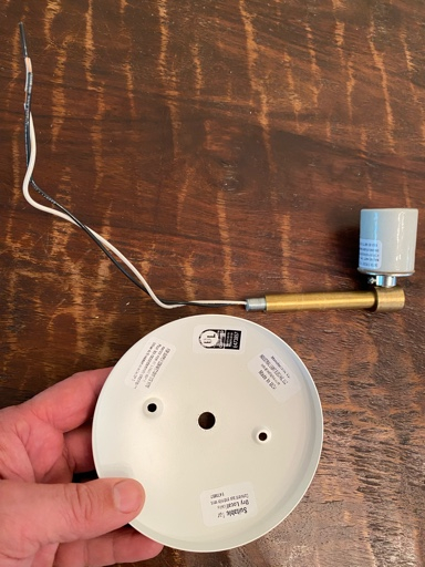

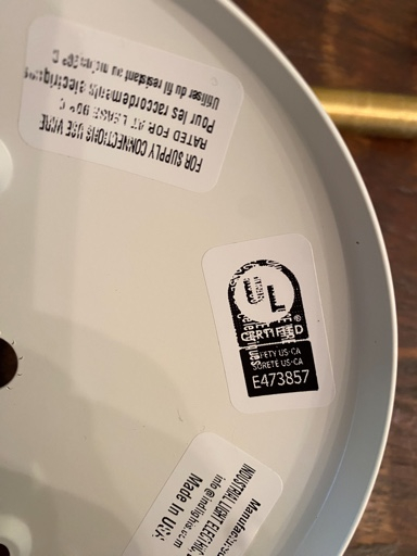

So I previously mentioned the metal lamps my wife bought that have no ground. I could tap a ground screw to the top of the lip round housing but it still seems hanky to me. Here are a couple pictures. It makes me wonder if the UL sticker is legit.

You could add a ground wire with a eye around the threaded base, or if you have metal mounting boxes and ground that the screws in the face plate will ground it.
As a point of reference. all table lamps I have seen are all two wire - no ground.

If the base is screwed to the electrical box that is grounded, would the base not then be grounded too?
if the box is metal and it is properly grounded.
